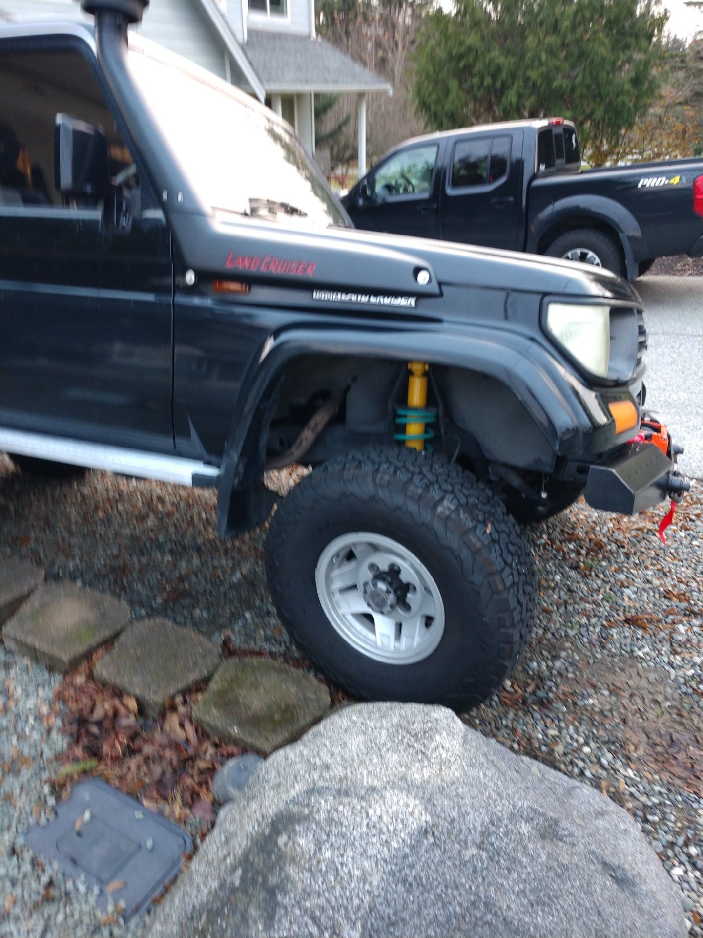

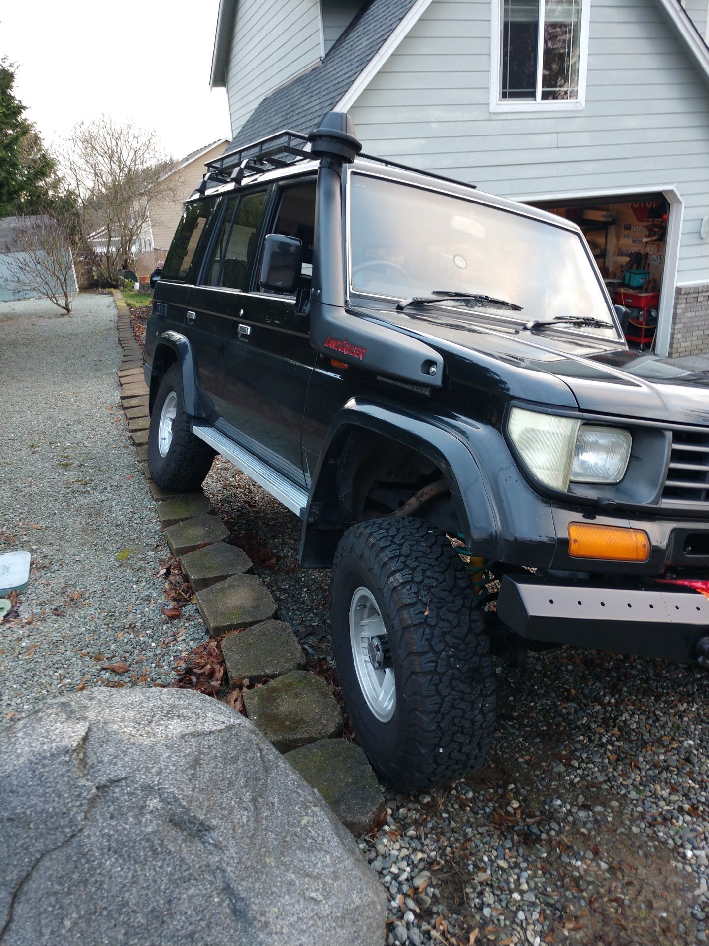

I put my longer brake lines on and removed the sway bars. That made the truck a tremendous amount more flexible. I can get out to about 26" height on my retaining wall before it lifts a tire. Close to the same forward and backwards. The truck was like a rigid board with the sway bars in. I am happy enough with that for my purposes. I have had much more flexible trucks, but I no longer have the need to drive over every boulder I see now. I am lazy, I just go around.

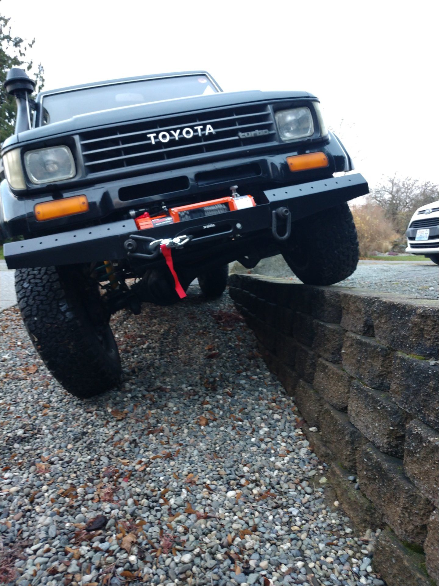

How does it perform on road without the sway bars? I’ve been contemplating taking mine out to gain some flex, but am not sure given that it will be my daily and see a lot of highway travel.
Honestly, can't really tell the difference.
The Land Cruiser is a way stiffer truck than any of my Land Rovers, and I have ran every one of those I have ever had without. Some I daily drove.
I have had a few really built trucks I would not have enjoyed daily driving, but I think the Prado would be fine.
Actually my biggest complaint with the Toyotas I have driven is the slightly vague steering. Every one I have driven in both stock and modified form had vague steering in my opinion. Body roll is pretty minimal however it seems.
Haha, that brick wall is perfect for testing your flex! Truck looks excellent! Thanks for the flex pictures.
