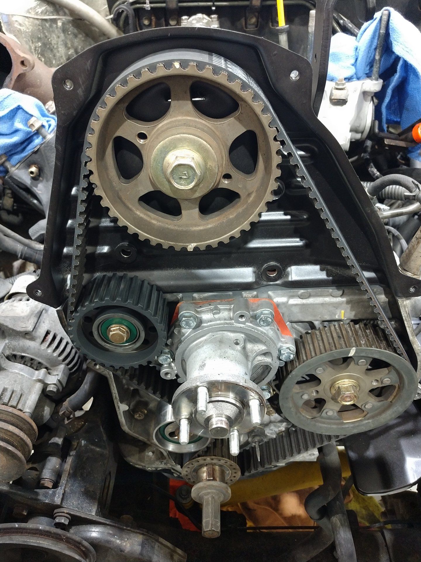

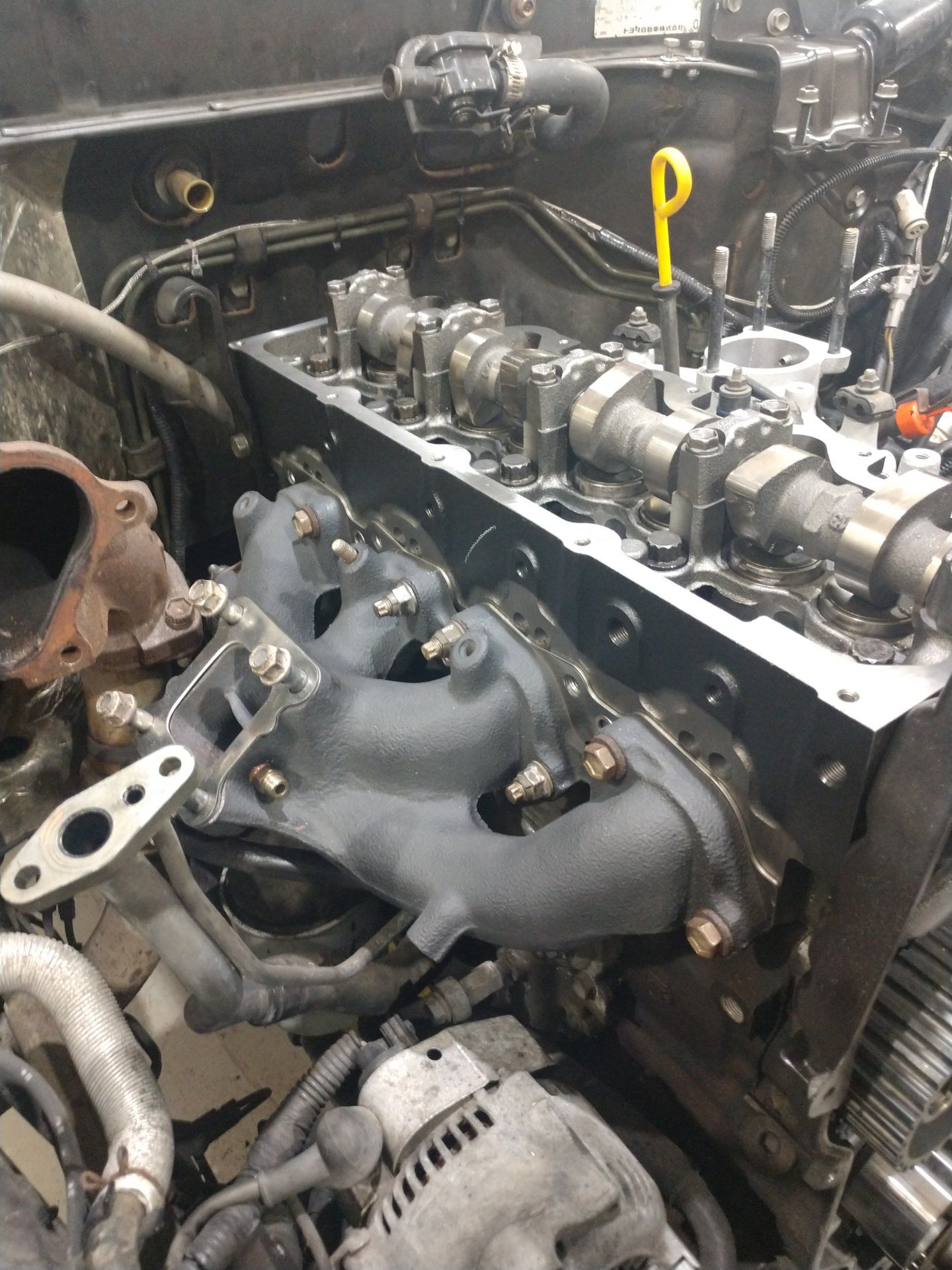

Head came back yesterday.
I used Automotive Machine Specialist in Everett Washington at the suggestion of @torfab. He does their head work.
I am really pleased with the work he did. Under 2 days turnaround and extremely reasonable on the price.
I should have the injectors back from rebuild today.
I am switching to Evans Waterless coolant while I have everything drained.
I had the Tridon tstat malfunction previously, so I have a new one, replacing coolant cap with a new OEM.
I decided to reuse my timing belt as it only had about 5000 miles on it.

I was the machine on that. I cleaned it once and wasn't happy, so revisited it a couple of times.
