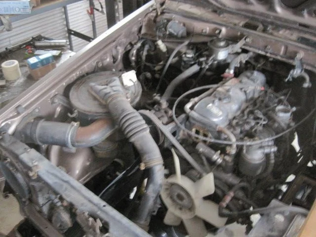

the engine has excellent compression but is missing parts and the edic controller is acting up

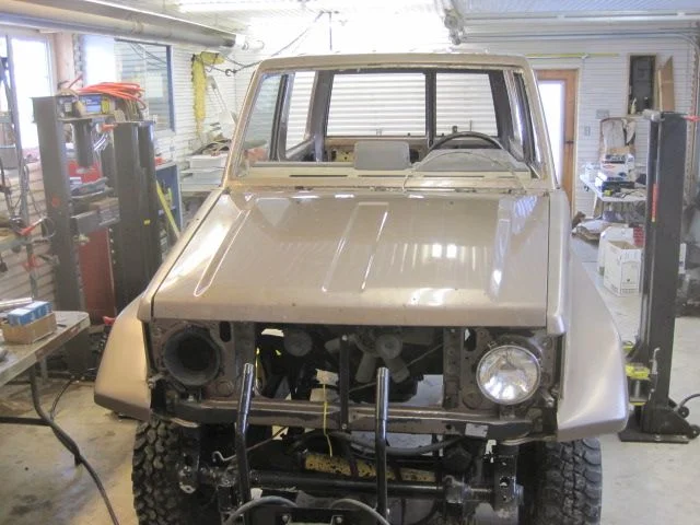

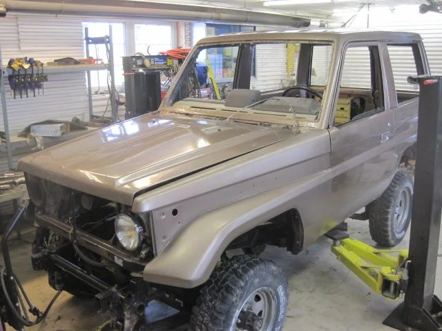

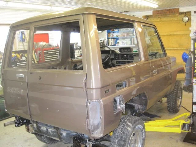

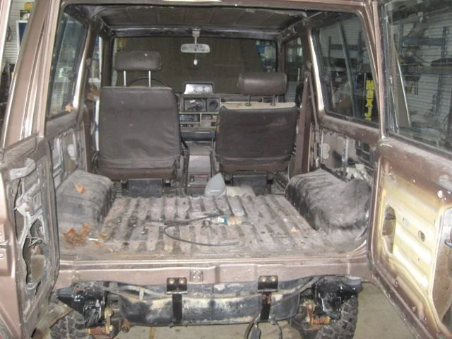

we have removed the windows to check the steel but this is basically her ...
once again the veneer isn't looking too bad but on closer inspection the tub is ... well ... as the bodyman put it, "a turd".
the decision has been made that the tub will be a cheap hippo liner inside, underneath, bottom of the doors etc with tinted product.
the front will be repainted and any rust issues to be dealt with.
the drivetrain will be upgraded as we go along.
the frame has already been galvanized but i suspect it might have twisted during the process.
the interior panels will be replaced with PC aluminum.

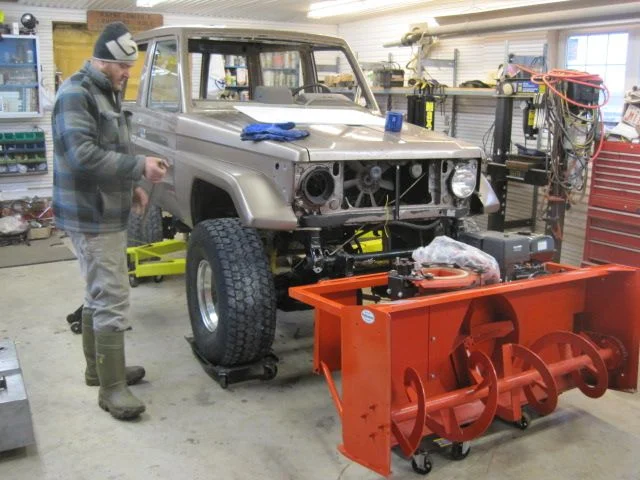

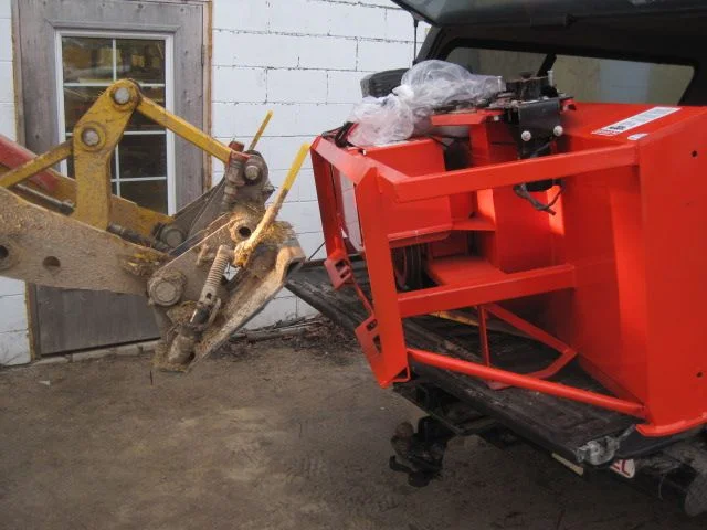

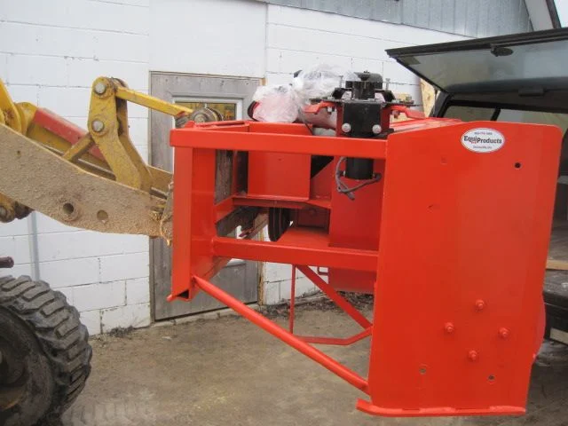

custom winter front bumper with new 8274, quick disconnect reciever for a self-contained snow blower, winter lighting.
custom summer bumper with 8274 and off road / highway lighting.

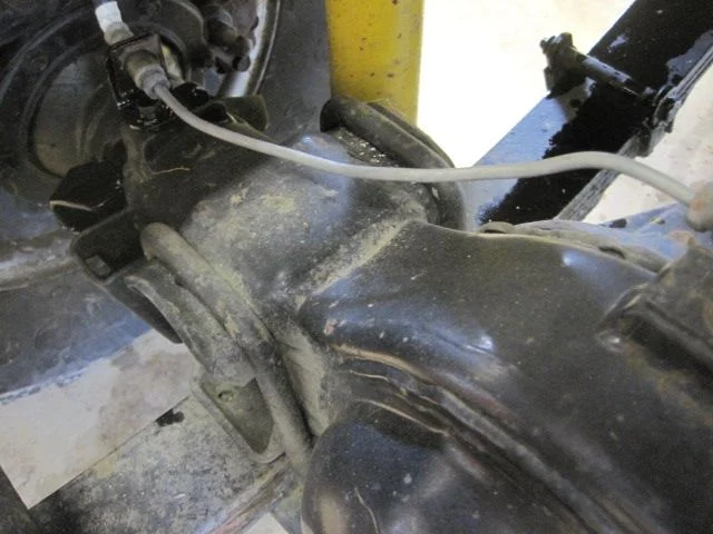

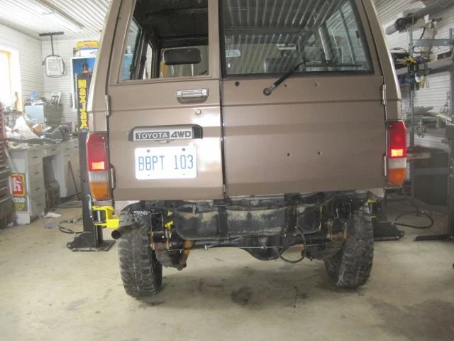

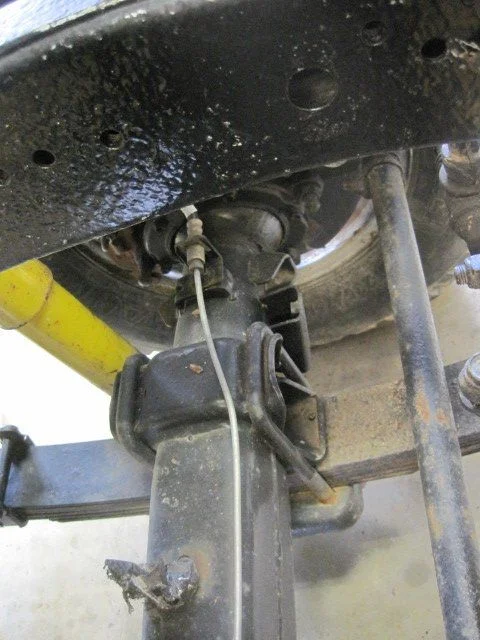

some of the issues from past hands:
brake lines over the pinch points for the axles
missing rear cross member (no biggie since a custom rear bumper with swingouts and air tank is being planned)

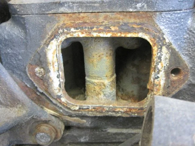

broken bolts for the thermostate housing
missing parts for the engine

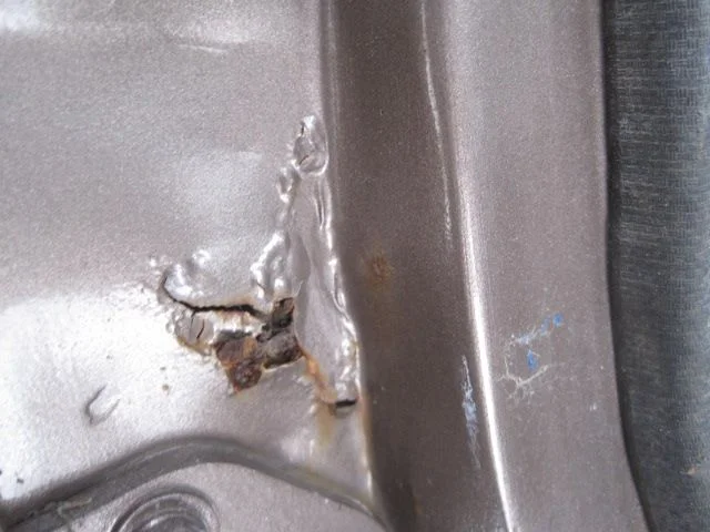

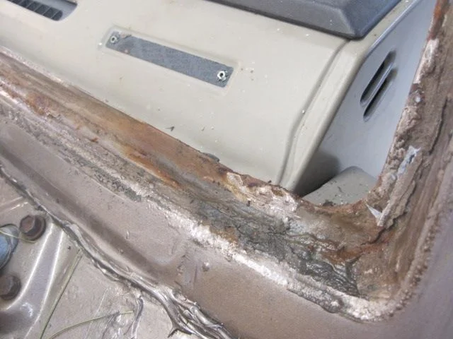

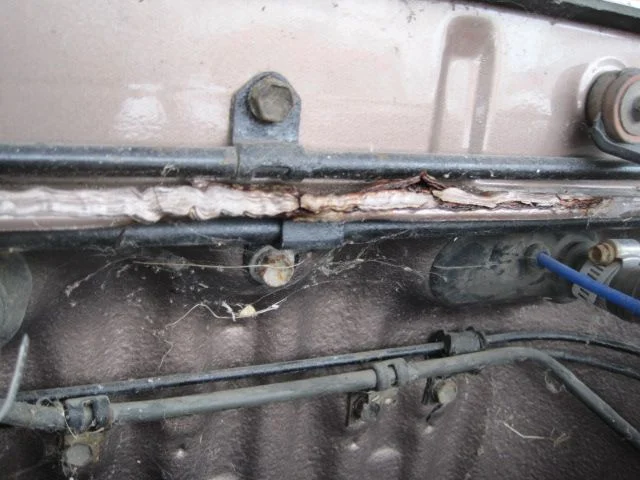

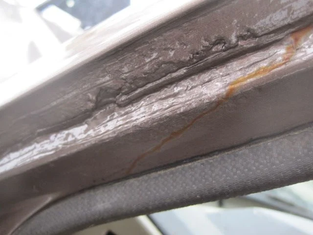

some of the rust issues, sadly if the individual would have taken a bit more time the tub would be salvagable ...
but
rust in the joints and the poorly welded on quarters in the rear just doesn't make this "turd" would spending more money on.

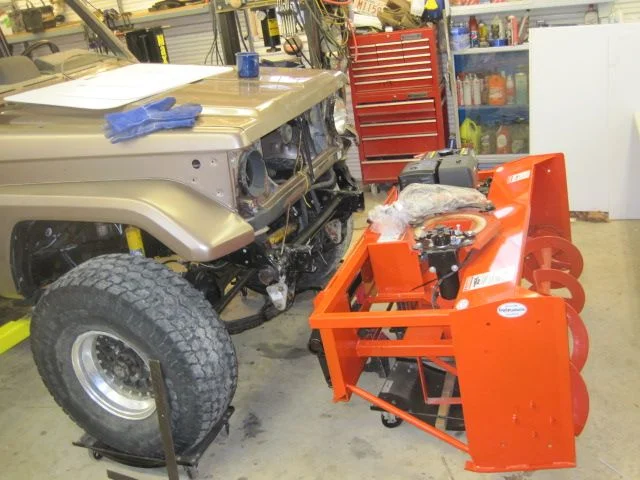

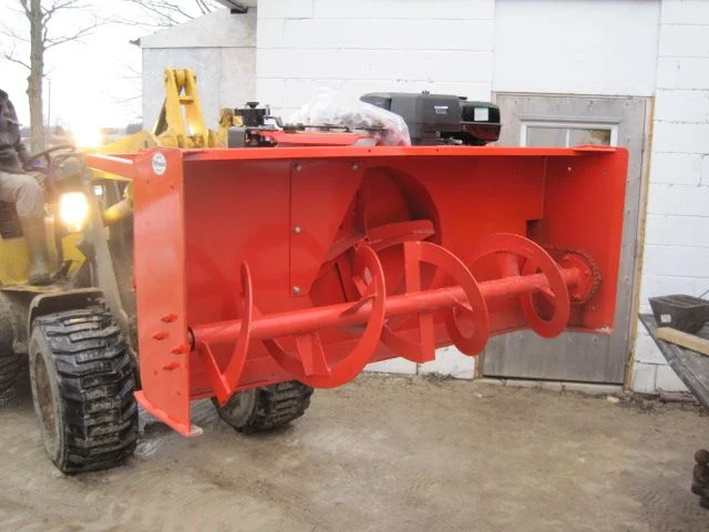

with the quick attachment built into the new "winter bumper" hooking up and disconnecting will be pretty easy and quick for those impromtu trips to town or having to winch your neighbour out of the ditch.
i am already liking the idea :hhmm:

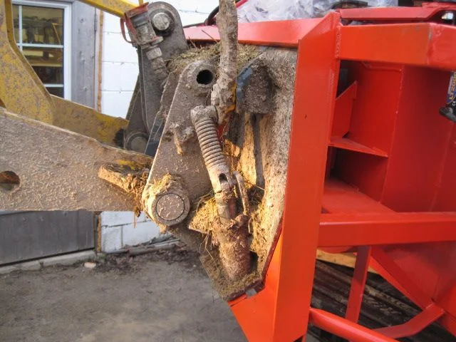

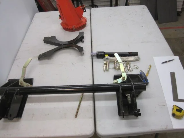

the new quick attachment ...
now to design the bumper to work with this attachment :confused:
