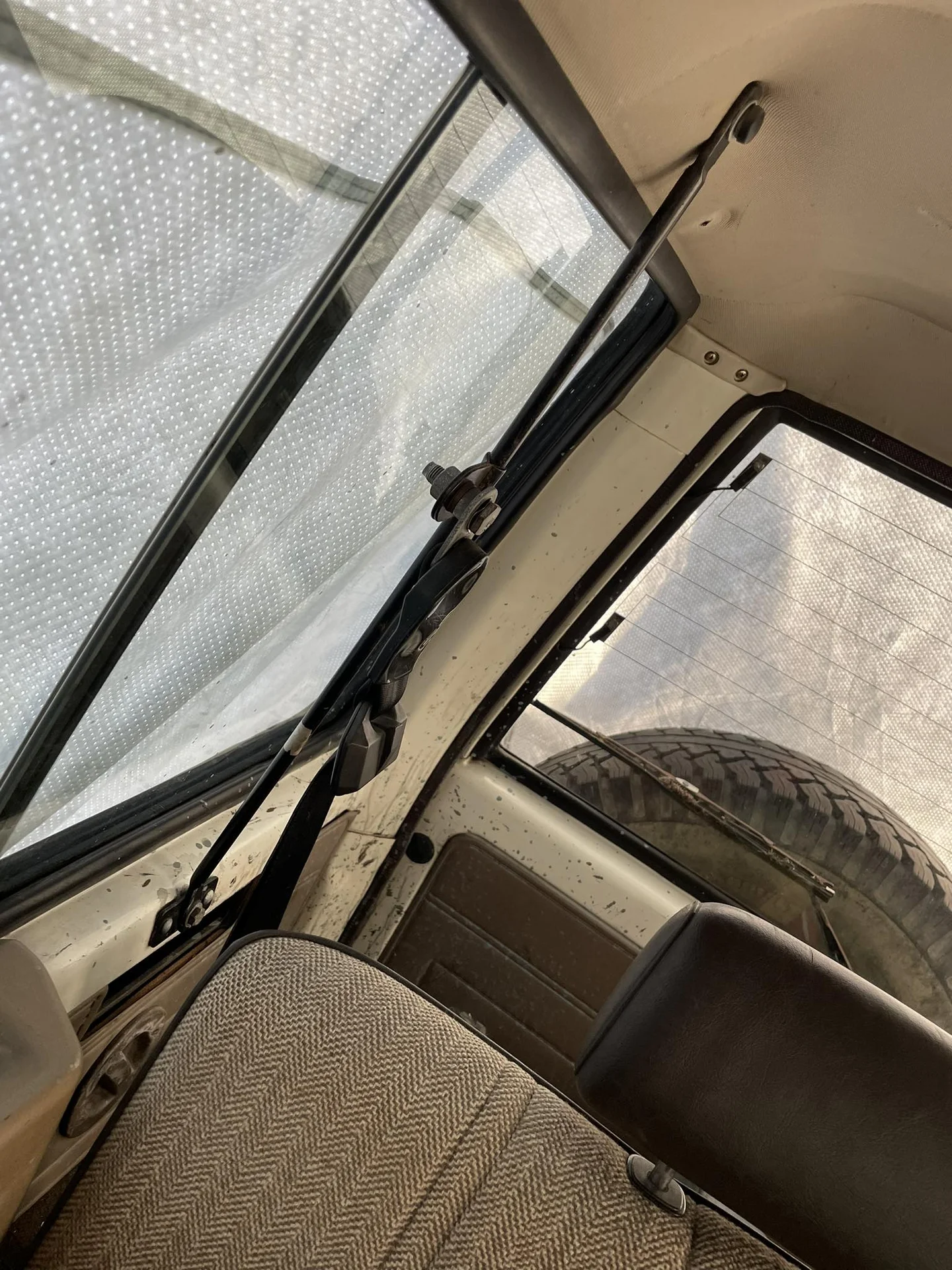

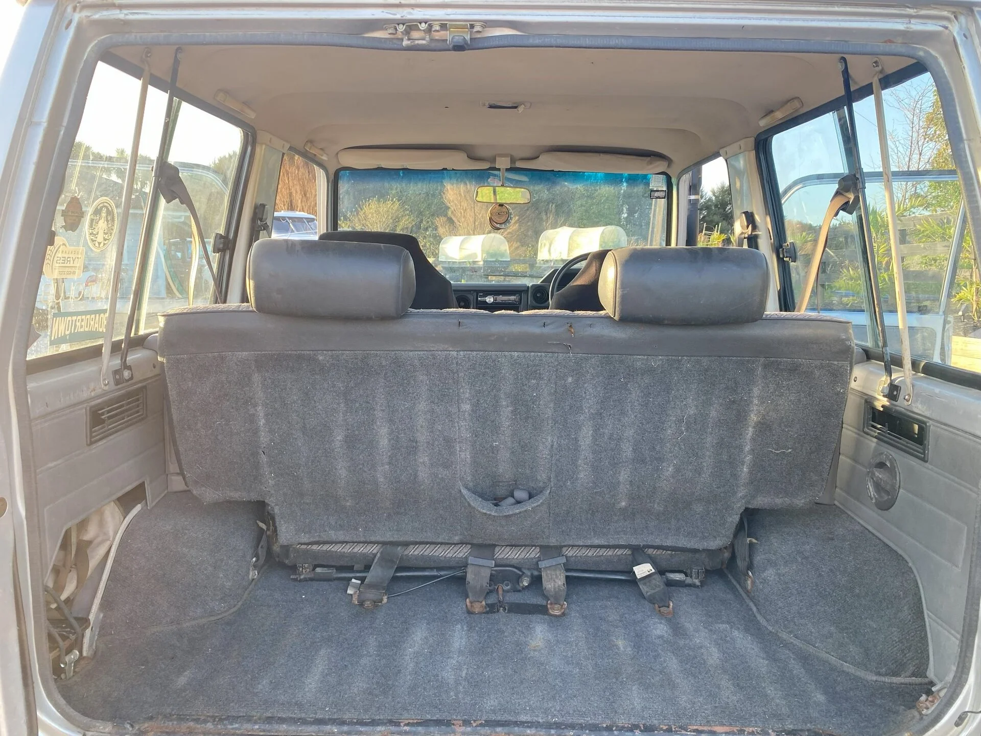

When I bought my Cruiser, it came with rear seats, but no belts, or the vertical bars by the window that they should attach to:
Picture is of a friend's Cruiser with identical belt mounting points to the floor and with top pivot at the vertical bars. Only difference is that my seats are split folding.

I found them
I do not think the dark colored vertical bar is OE.

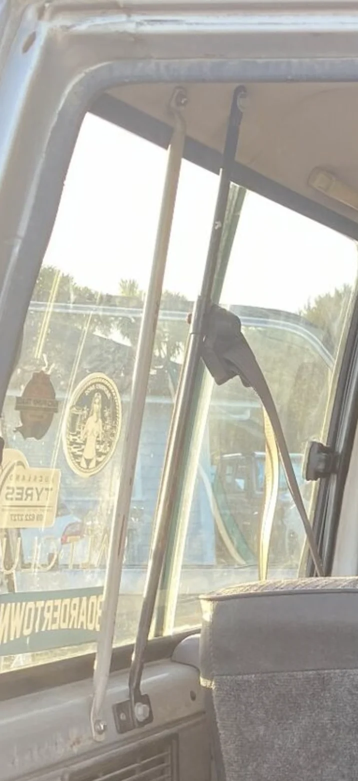

My mate's BJ71 is fitted with the second black bar set for seatbelts, so I believe they're factory. My white ones are fitted, but I'm missing the blacks, as well as the adaptor to the seatbelt. If anyone can get some measurements and clear pics of those, I might just make some up
Edit: BJ71, NOT a 73
Are you saying a BJ73 with removable top has the seatbelts anchored to the top? It could be locally installed by either the dealer, port or aftermarket and specific to your country but I don't think it is factory.
Typo! It's a BJ71. It's the one in my picture up top

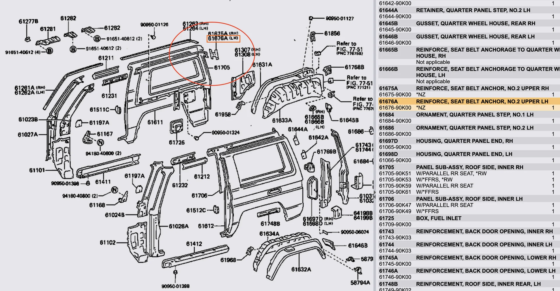

I would look into the latest Hardtop J70's (within the last ~10 years). Their seatbelt is tethered to the C pillar. Likely, the pillar has reinforcements and captured nuts that may not present on many 80's J70 but it would be much better than that "retrofit."
You can see some what I'm talking about here.
^^^ I do see a 3-pt rear seat belt available in an '89 BJ70. Says "NZ" for maybe New Zealand? And then you can see the seatbelt reinforcement plate below....

Hello,
The rear seat can accommodate three people, all with seat belts.
The center belt is a two-point, lap type.
The other belts can be either three-point or two-point.
There are two types of three-point rear seat belt.
One type is anchored in the C pillar. Adjustment is manual.
The other type is an ELR system that fits inside the rear panel. There is a point for a tensioner in the C-pillar, right where the two-point type anchors.
Both types use the reinforcement from the message above.
Another option is a two-point, lap type seat belt. This seat belt anchors in the rear seat's base.
You can get the two-point rear seat belts from Toyota. It appears that your rear seat is factory. If so, installation is straightforward.
Juan

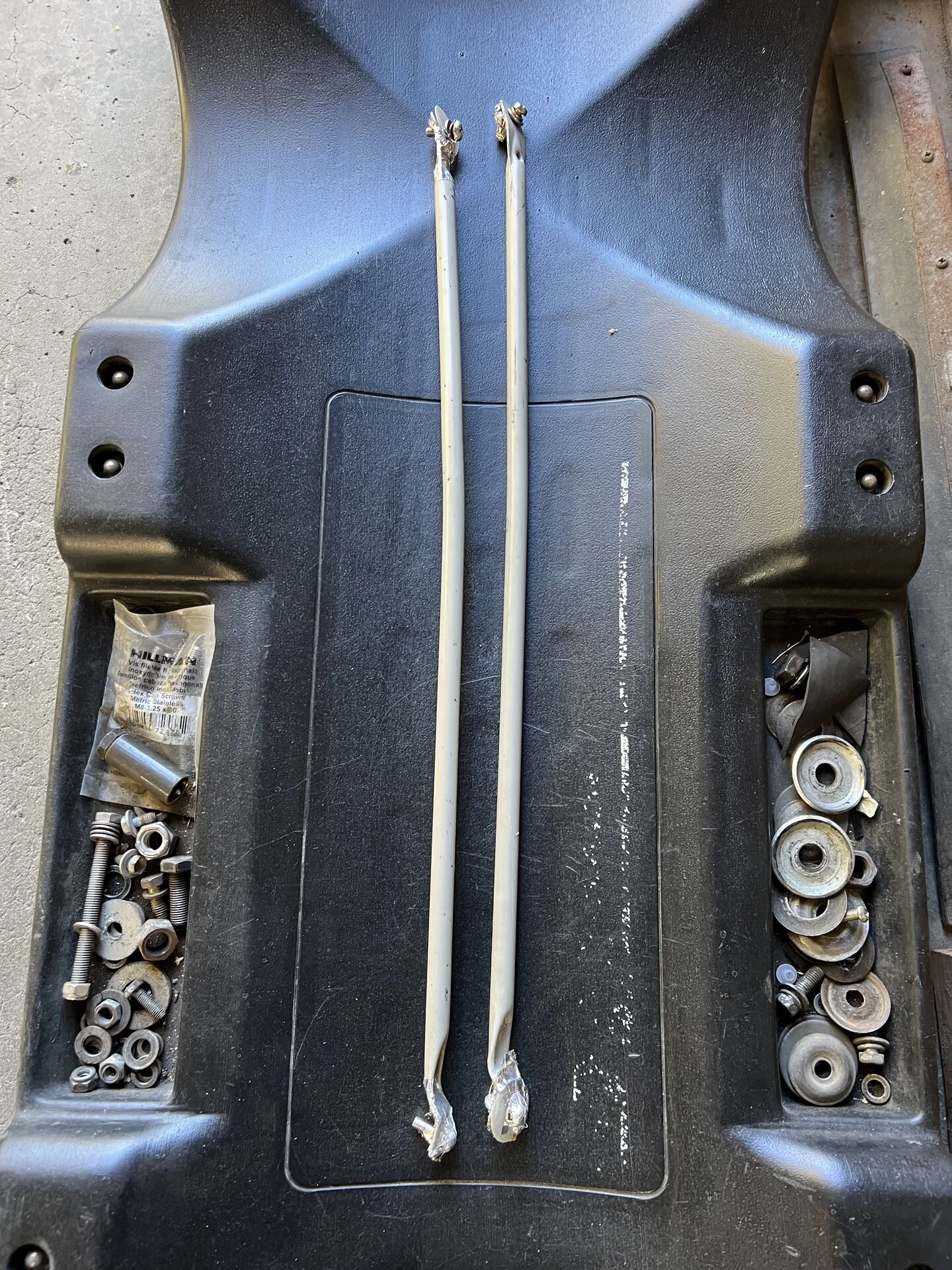

Just took the rear seat belts out of my bj70, previous owner installed a rear seat and belts from a 71 and drilled through to install the seats but the belts all went to factory threaded holes. Let me know if you'd like them
Thanks mate, that would be super kind, although I'm in New Zealand, so no idea what shipping will be like. I'll DM you.
Reviving an old thread. Just got more detailed pictures off of someone selling a BJ70 on FB marketplace. Their white bar is missing interestingly. The bar and small tab don't look hard to fabricate, however the seatbelt hardware is a bit funny looking. Would be great if someone could suggest what to look for.
