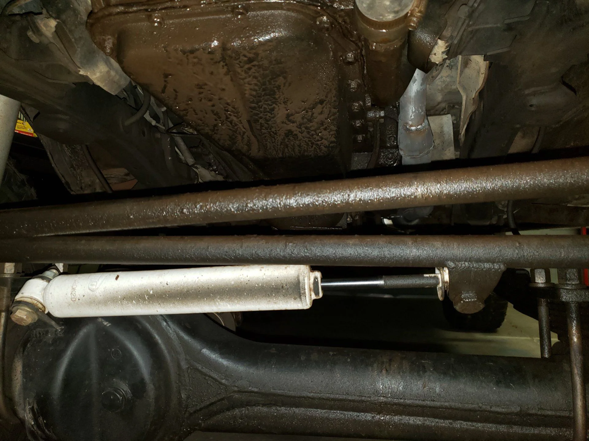

OK but, and I guessed I missed that part that you're only doing a 2" ish lift you may have clearance issues with the drag link and the oil pan. I did, and ended up with more lift than planned for since I went with 3" springs and a front spring hanger.

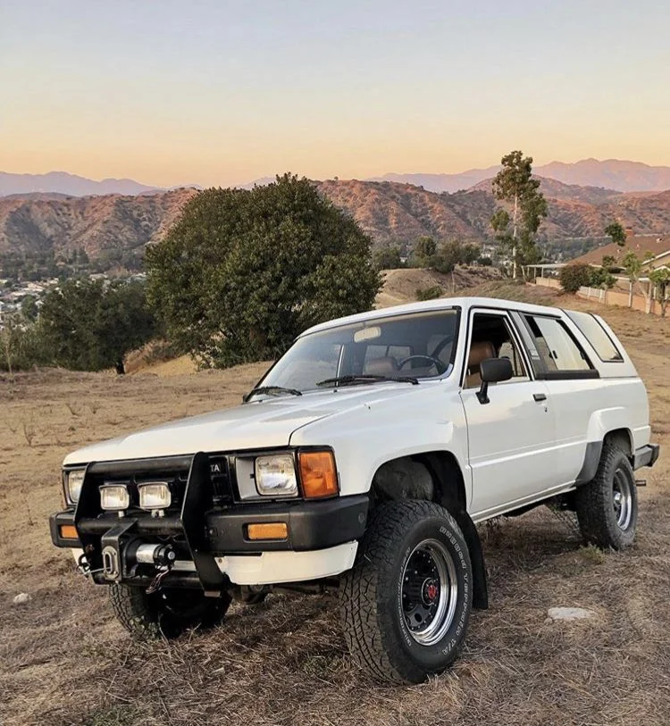

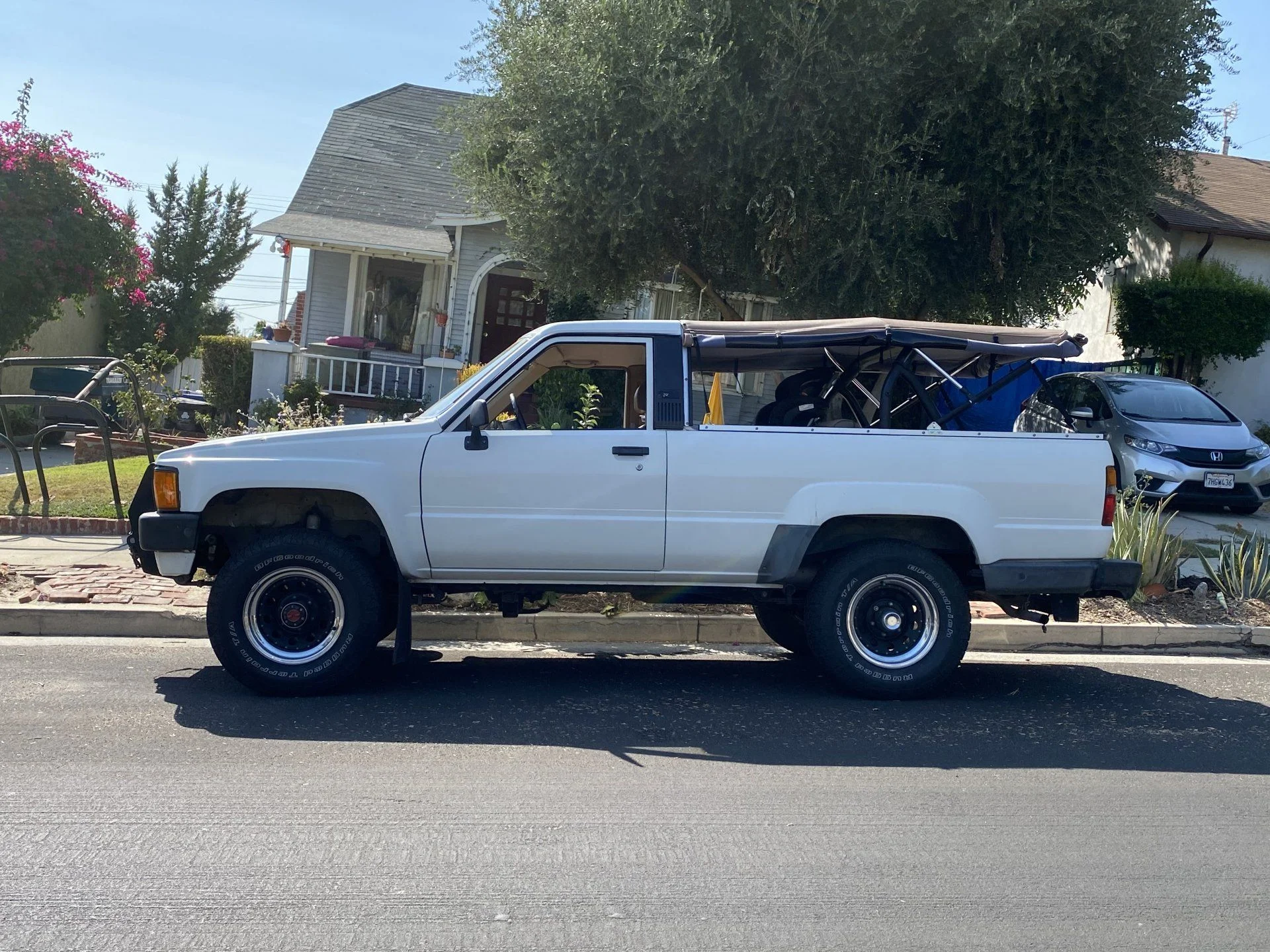

Got a pic of the 85?

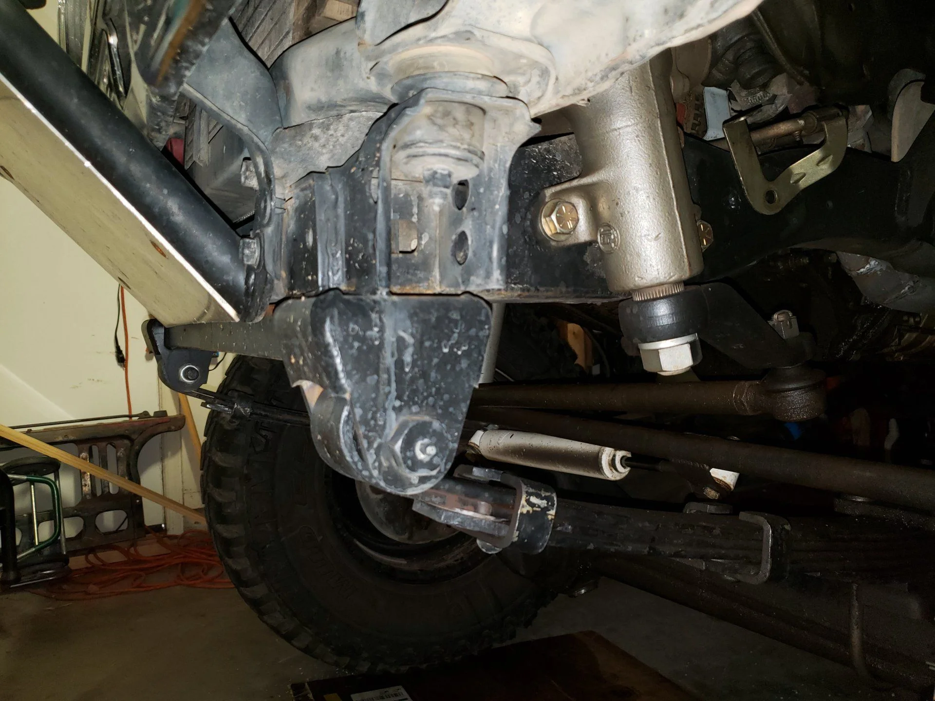

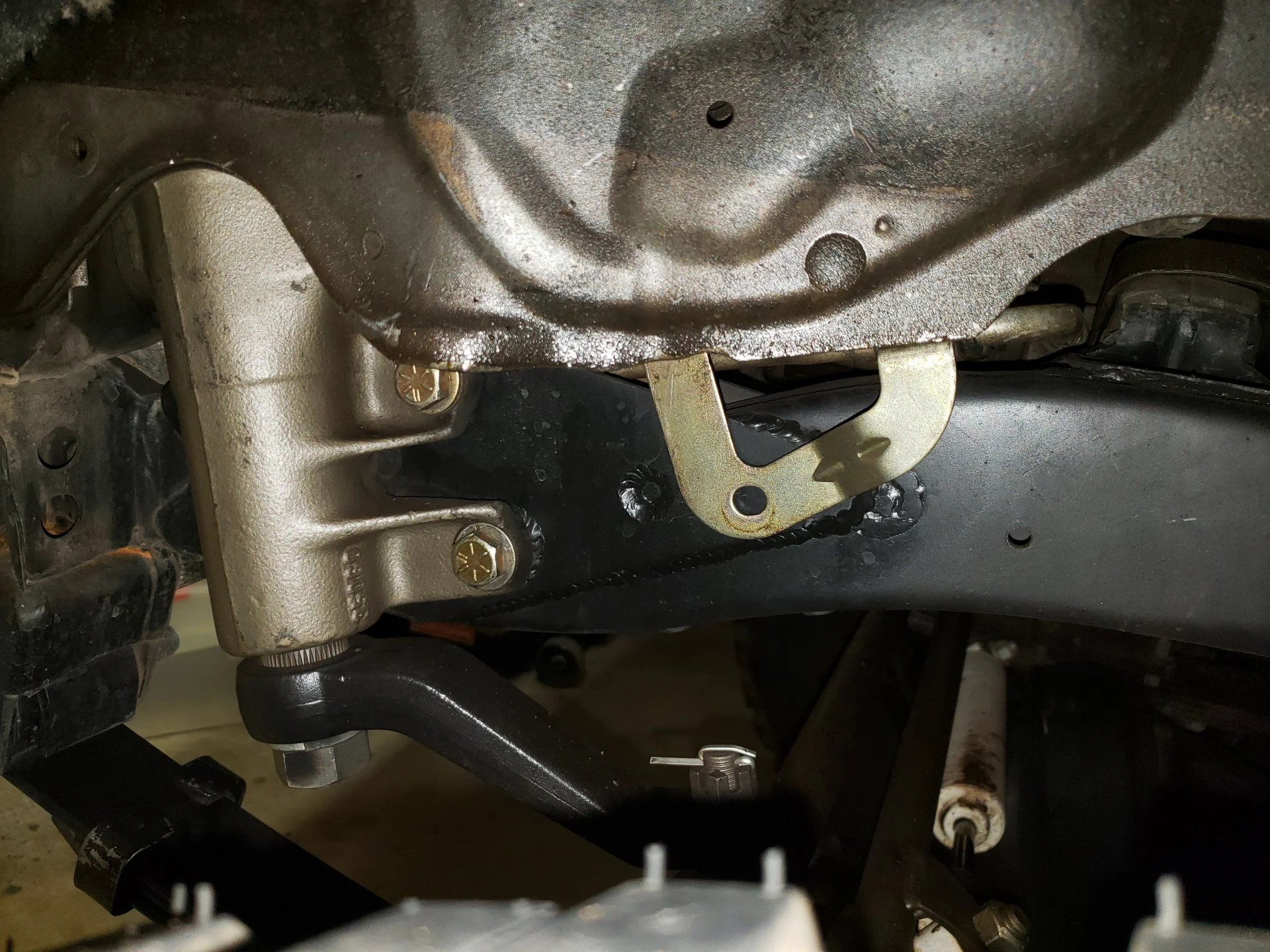

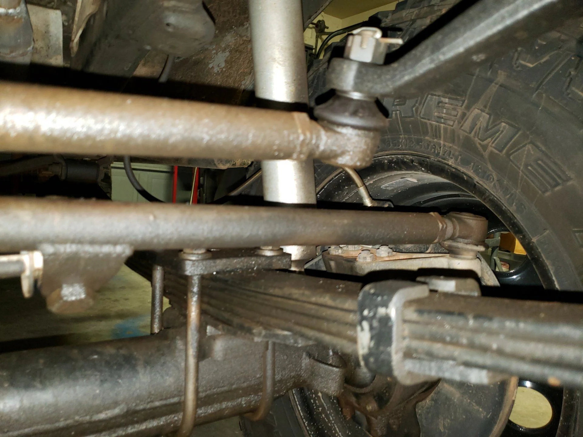

Took some new pics.
The biggest thing with crossover is getting the proper pitman arm for your build and positioning of the box.
Imo the stock pitman arm is dumb. Get something flatter.

Interesting you should say that. I have a "flatter" billet arm. I'm pulling it off to install the OEM style arm. I want to drop my drag link down from the oil pan for better clearance.
