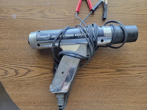

A Baja story. I carry a bunch of junk when I'm down there, including a timing light. Well, I was going through the check point outside San Felipe (Mex 5 and Mex 3) and I got searched. As you know, the males are conscript into the military when they turn 18, so the checkpoints are staffed by kids. Well, this kid is going though my "oh s*** box" and finds my timing light. His eyes got HUGE ... and he screams "chrome pistola." I started laughing my ass off. Anyway, one of the other guys runs over, and you could tell from the inflection in his voice he told the kid "it's a timing light you dumb ass."
Here is my old light. Note I have since upgraded. The new one doesn't look like a "chrome pistola." :rofl:
Lol. Good story. The checkpoints can be something else!

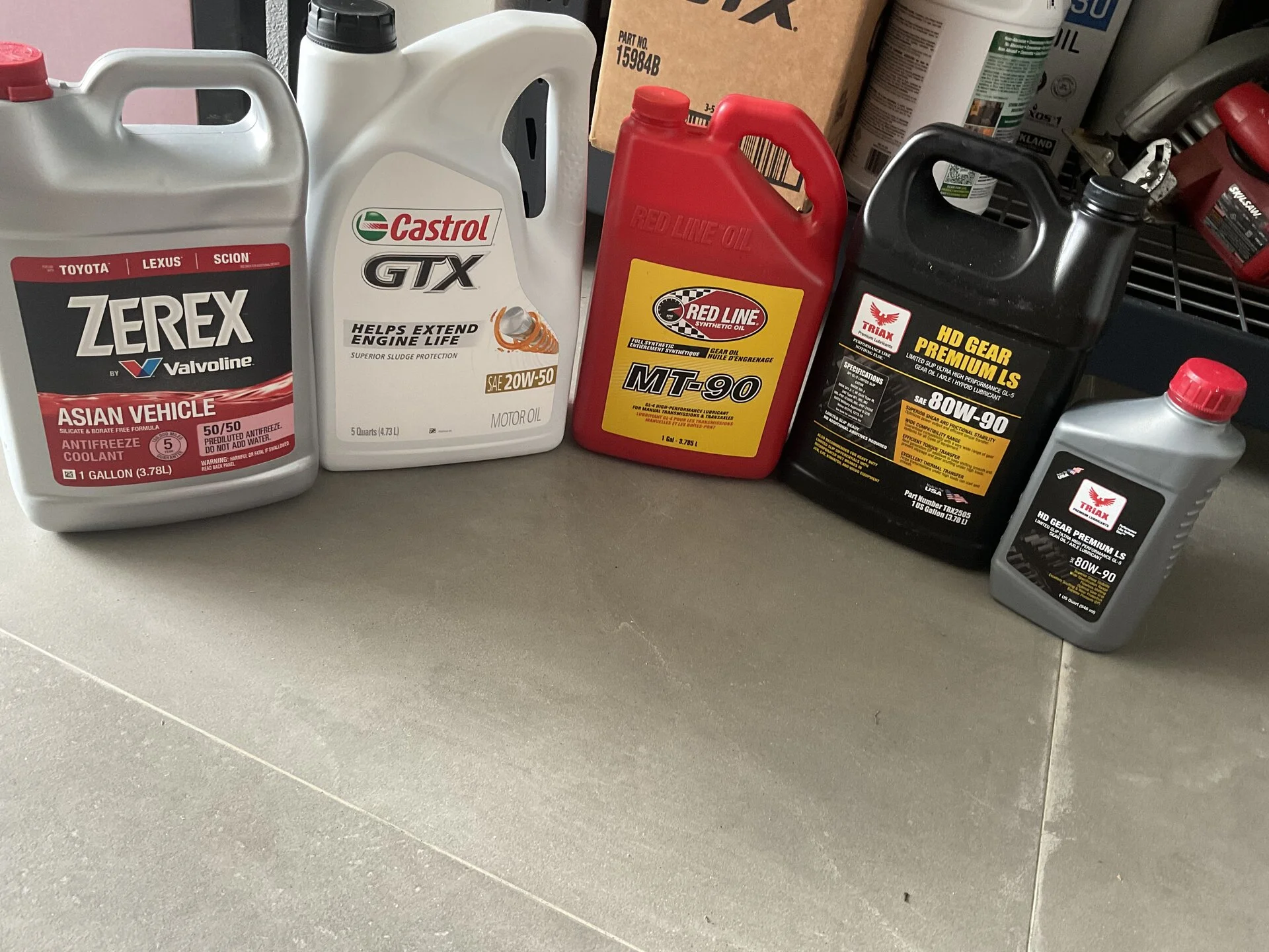

I brought down some fluids with me on this drive to Baja with the intention to start down this path. I will attach a photo of some of the things I brought after researching before making the drive. I only wish I had reached out previously, as I am already down here.
I was able to change to oil and filter yesterday, cleaned the MAF, air filter box and plenum to the throttle body. I plan to clean the throttle body today after warming the engine and look to begin changing the other fluids. I would like to switch the coolant to the red Asian coolant as I have read about the other yellow Prestone causing electrolysis, which I think I can see happening on the bottom of the radiator. Do you have any advice on the proper way to flush the system in addition to just emptying the reservoir via pulling the two drain cocks and adding the new variety of red coolant?
I will be pulling the trigger on ordering the seals, etc that you have recommended as well as some of the paper air filters rather than the reusable one that is currently installed and look to fly back with those after making a quick flight back to Colorado to accomplish a few other things. Do you have any other recommendations of things to order or best ways to take advantage of a quick trip back to the States?
