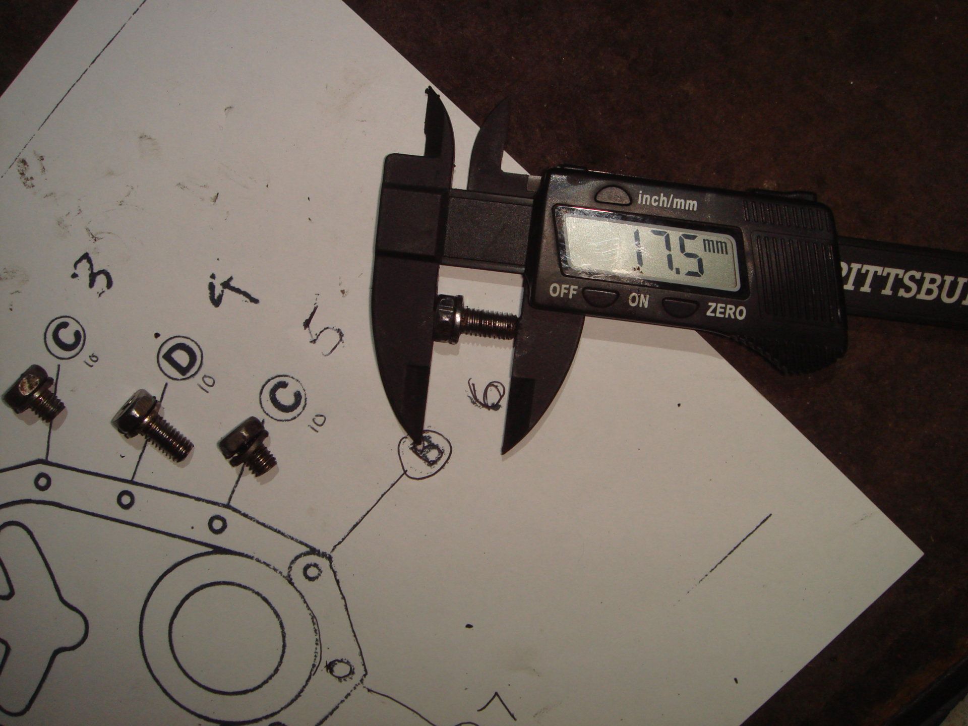

Your camera will be your friend during disassembly. Take way more pictures than you think is necessary of everything before, during & after removal. Then label everything very carefully.
There are a lot of specific bolts that are intended for a specific location. Don't just toss removed bolts into a bucket.

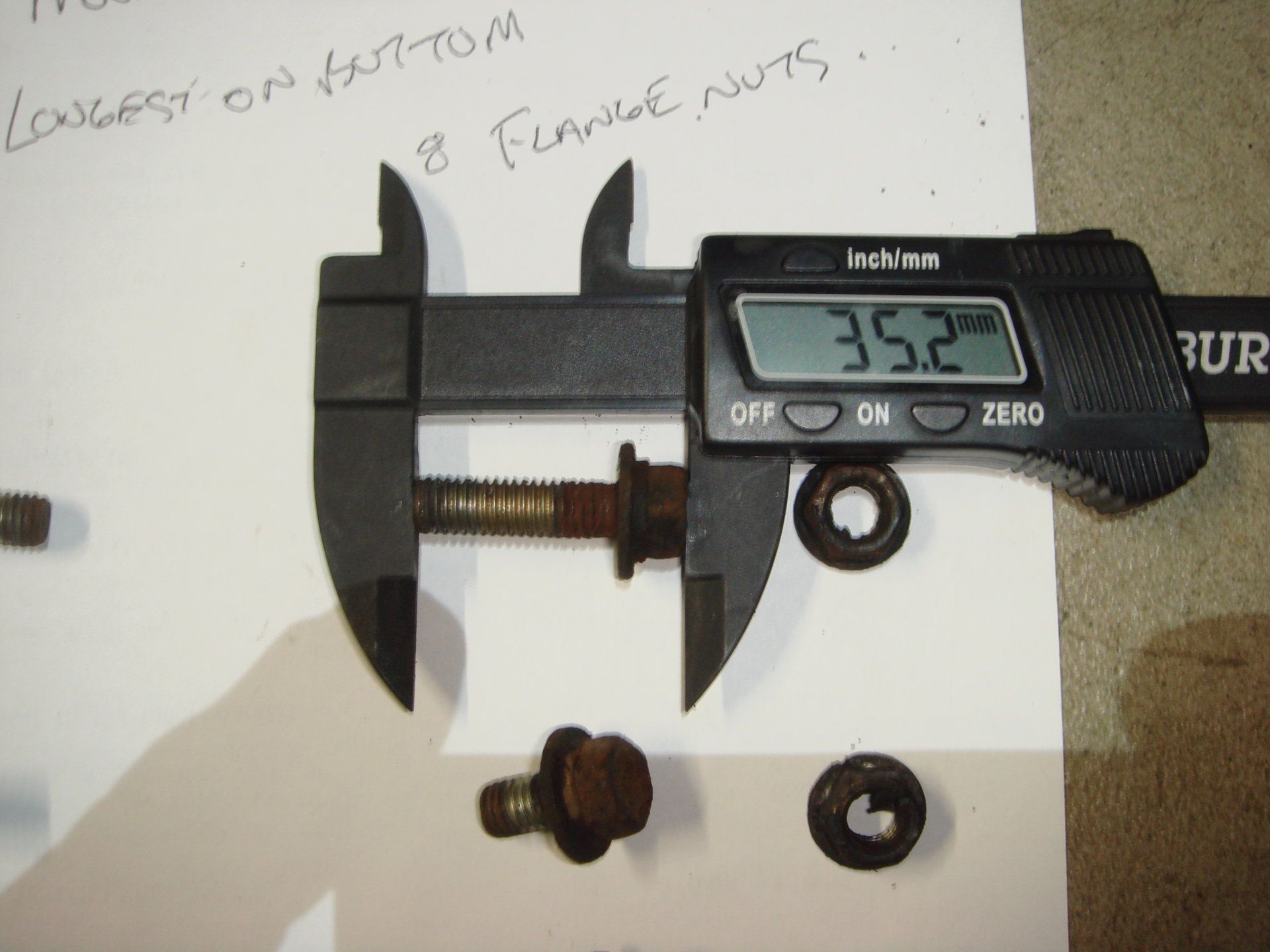

One way to be a sure that every bolt gets returned to is original location is to take a picture of it in calipers with a note next to it. Like below.
When the project drags on, it's almost impossible to remember what went where. Your camera will save you.

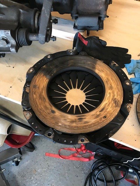

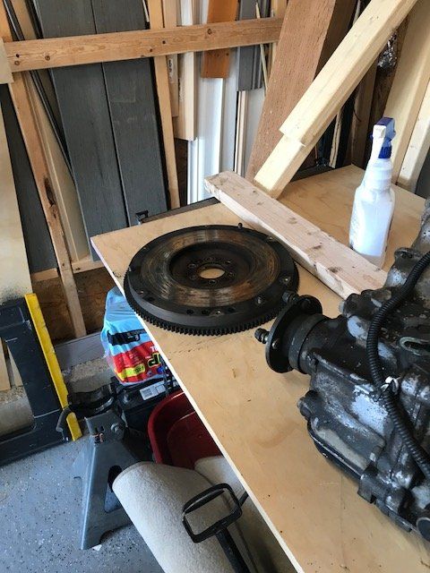

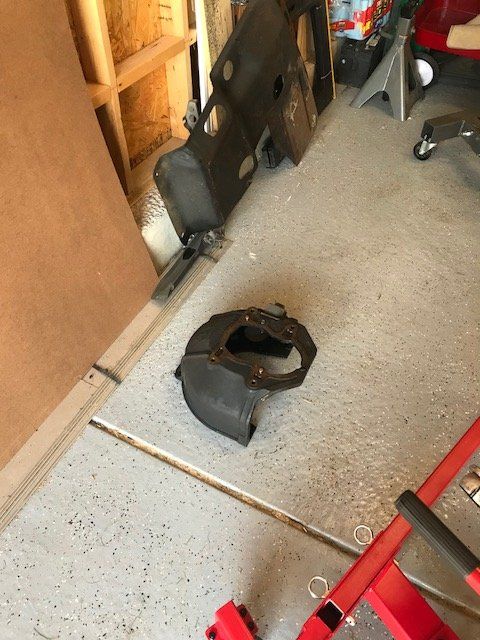

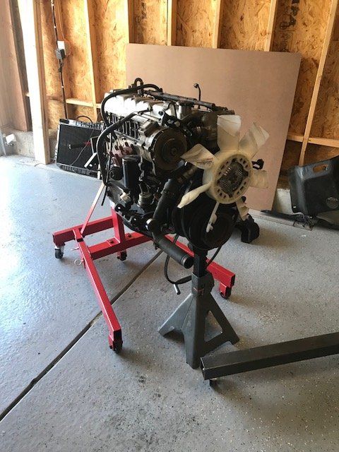

a little more progress yesterday. I got the clutch and flywheel off and was able to remove the bellhousing. This allowed me to put the engine on a stand.
Everyone was right about how heavy the flywheel was. I was able to get the clutch off by putting a screwdriver in the flywheel teeth and loosening the 12mm clutch bolts a little bit at a time. I then set the engine all the way on the ground so the flywheel was close to the ground. I piled a bunch of old rags and clothing under the flywheel and took out the bolts with an electric impact wrench. I then got my feet out of the way and tapped on the back of the flywheel with a rubber mallet and it dropped right down onto my pile of rags.
Thanks for everyone who has gone before with the harbor freight 1 ton stand, I would have never figured out how to attach the engine if it weren't for pictures on this forum. I do want to say that the bolt length matters. I had to go back out several times to get the right length of 12 x1.75 bolt. I think i ended up using 110 mm length on the top bolts and 90 mm on the bottoms.

I threw the jackstand under there for the first night just in case haha

I suspect the flywheel is so massive because it’s an industrial engine spinning slow and the flywheel mass helps smooth out the engine at its low revs. You could probably have a machine shop turn off some mass in the flywheel and rebalance and resurface and you’d notice a small improvement in acceleration.

View attachment 1713784 View attachment 1713785 View attachment 1713783 View attachment 1713782
Haha, I think everyone does that the first time, it seems sooo heavy. :cheers:. I am talking about the jack under the engine on the stand. I would never lighten the flywheel that's what makes these crawl so well.
It’s supposed to be heavy. It’s one of the reasons it works so well going slowly at low rpm. Resurface only removing as little material as possible! It’s a feature not a problem!

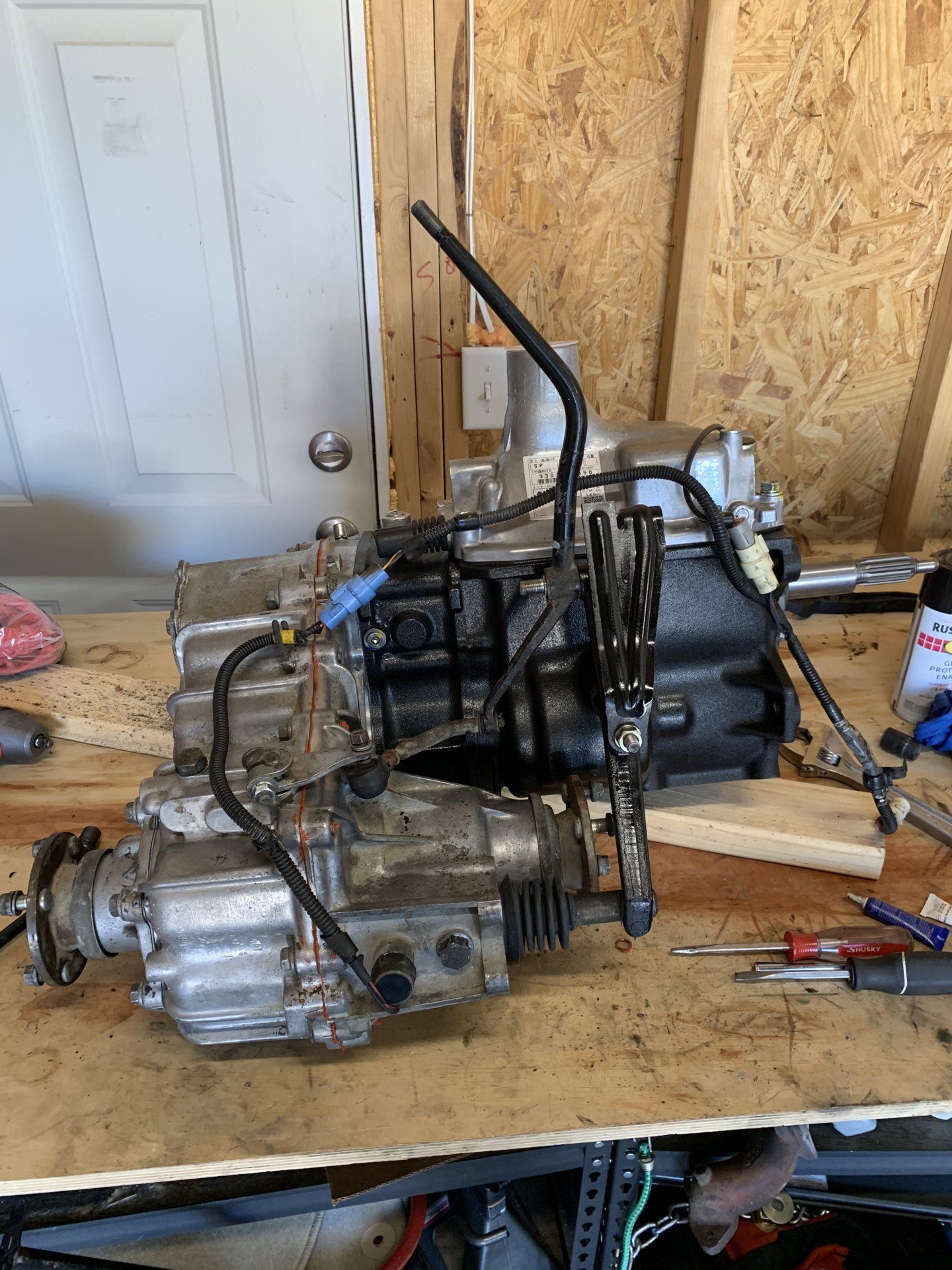

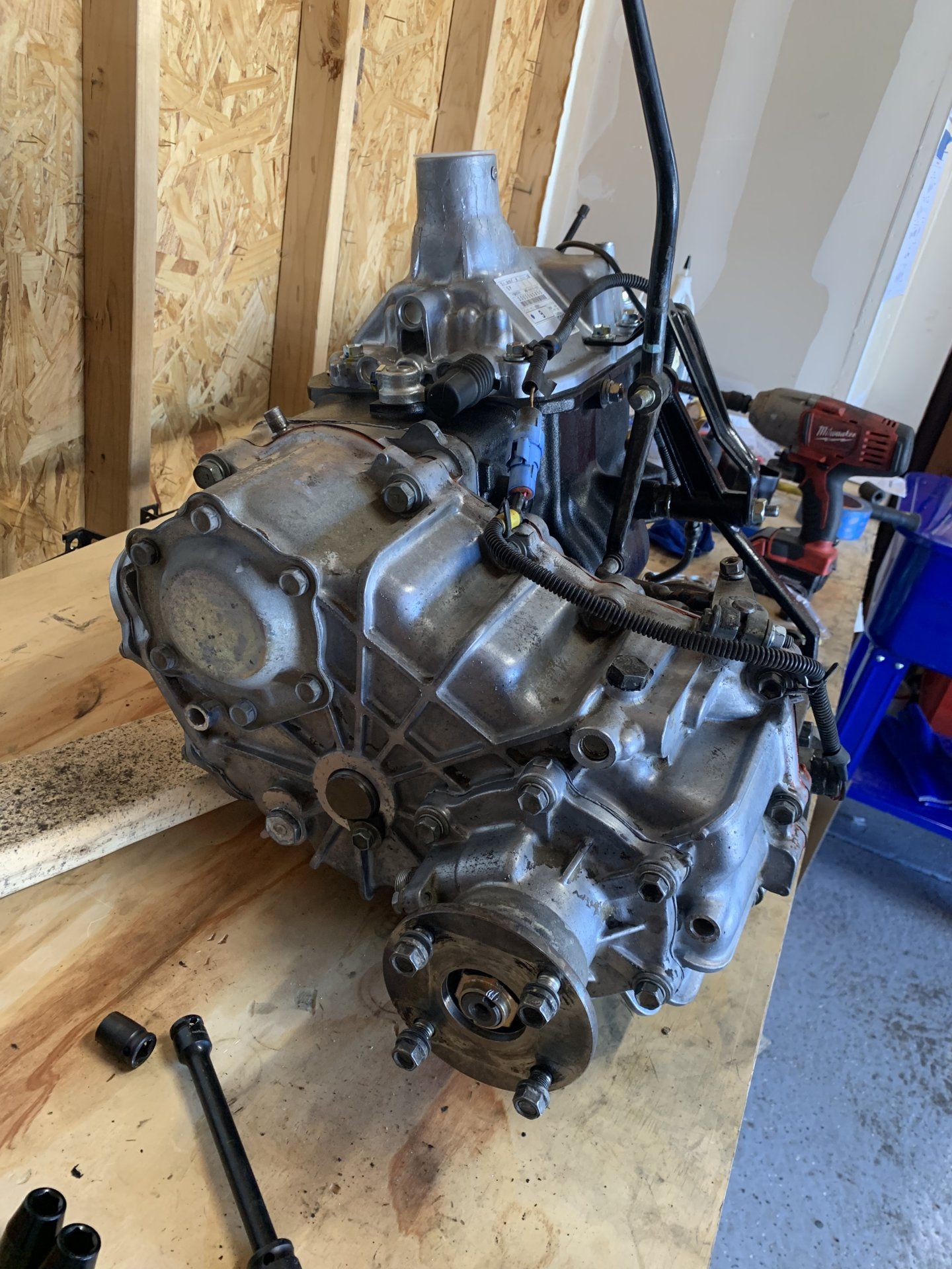

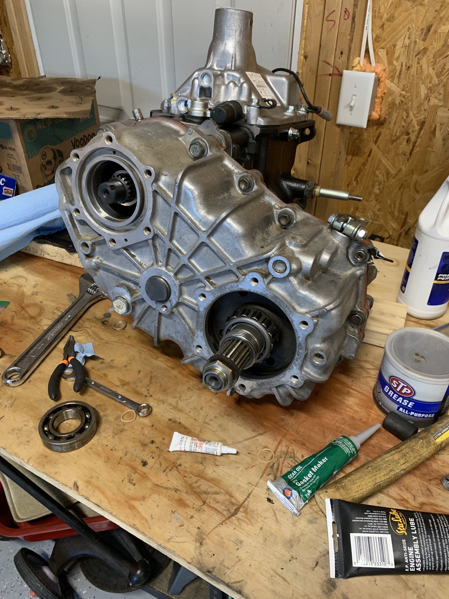

Thanks for checking in on my project @NeverGiveUpYota ! You are right, with a 3 year old and a 12 month old and a full time job and a wife who works full time it is tough to find time to work on the cruiser! However, I did find time to finish rebuilding the transfer case with the new addition of a new five speed as well. I decided to let the machine shop rebuild the long block after machining because I just don’t have time, so now I am just waiting for the machine shop to finish the engine, then I get to start putting it all back together, which I am super nervous about. (Anyone in south Denver metro area who sees this and wants to help feel free! I have beer!!) here are some pics of finishing up the transfer case.
