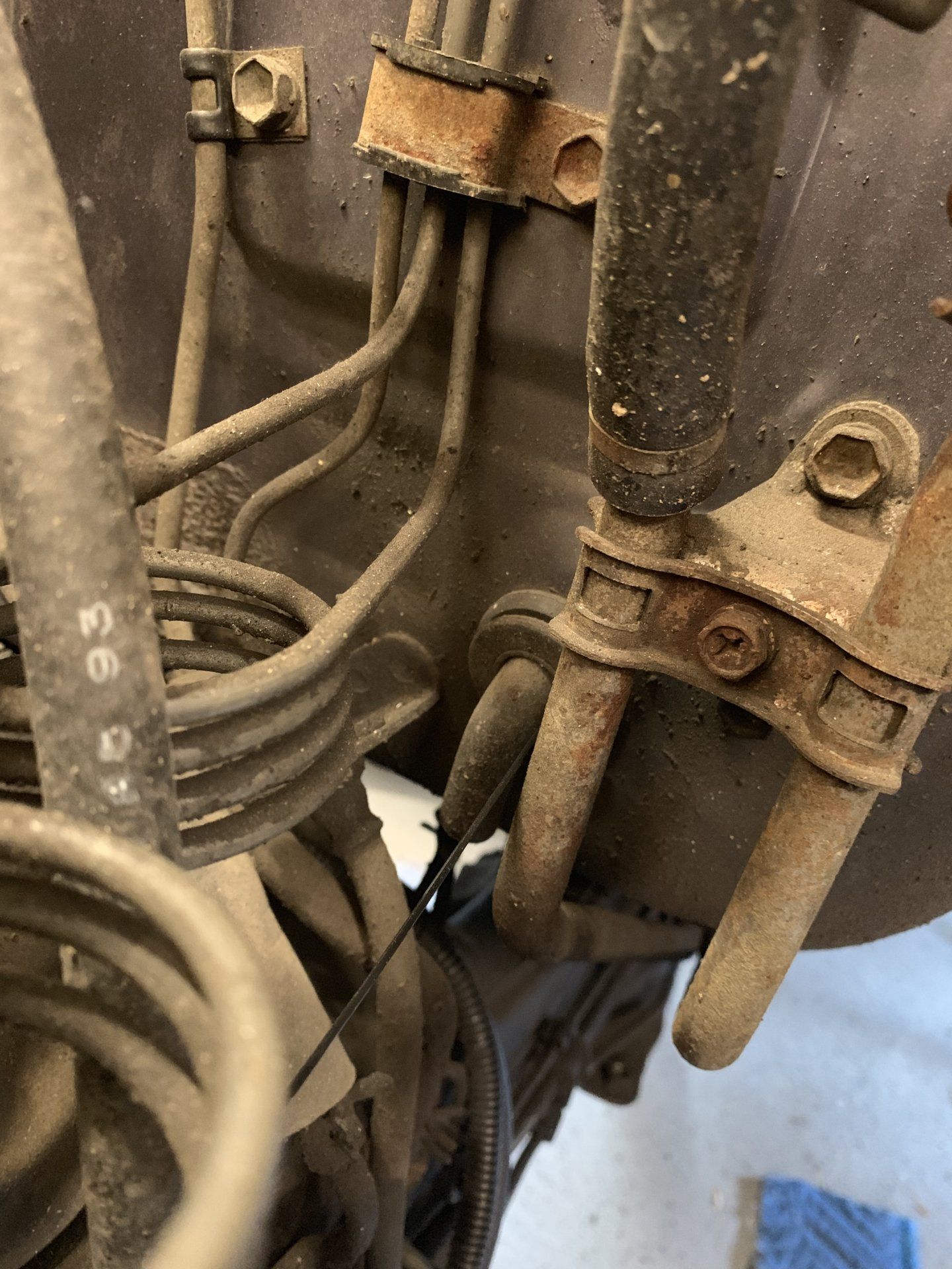

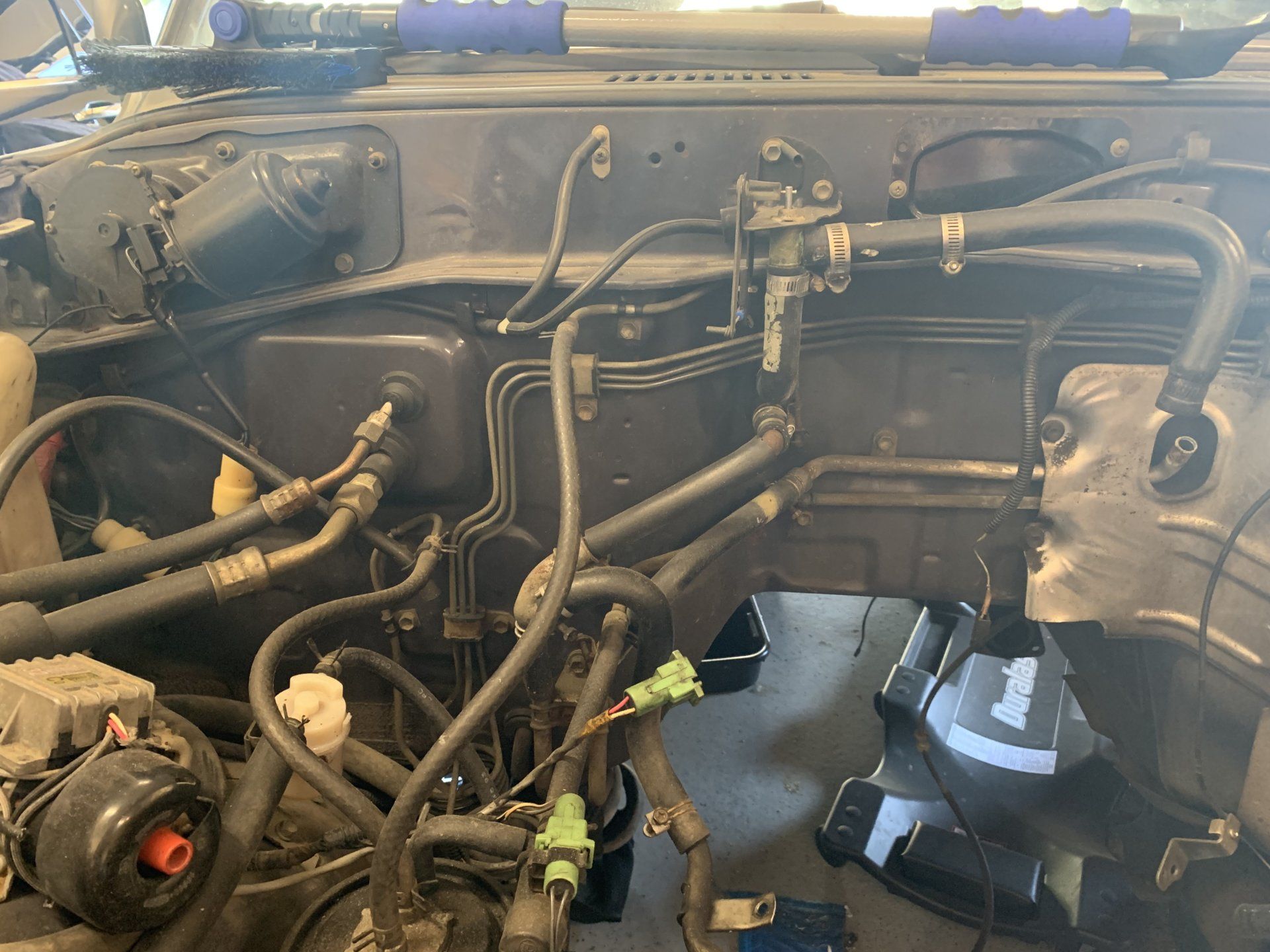

Contemplating my firewall and trying to figure out the easiest way to run the copper tubing for my mechanical oil pressure gauge. Actually, I got a 3 gauge set so I’m gonna run oil pressure, water temp and vacuum. I’ve researched the forum, but there aren’t a ton of threads on it. I’m sure I can figure it out, just want to know if there is an easier way.
Check that. This grommet seems to be relatively easy to reach from both inside and outside the cabin.
I think years ago I sent an oil mech line (it was a hard plastic) through that one or one of the AC ones. I ran it under the glove box and along the lower edge of the dash near the ashtray housing frame.
Seems like a good spot. Trying to put it in before I put the engine back in. Now if only I could figure out the electrical so the gauges light up.
You’ll get it. Can’t be too hard. I hate electrical too.
My oil pressure is with that horrible plastic line (getting changed soon) but runs at the back of the firewall to the drivers side.
Same with the temp gauge.
It was easier to have both run into the same grommet for trouble shooting and removing the gauges if ever need be
I left enough slack under the dash to move the gauges as needed without having to unhook anything.

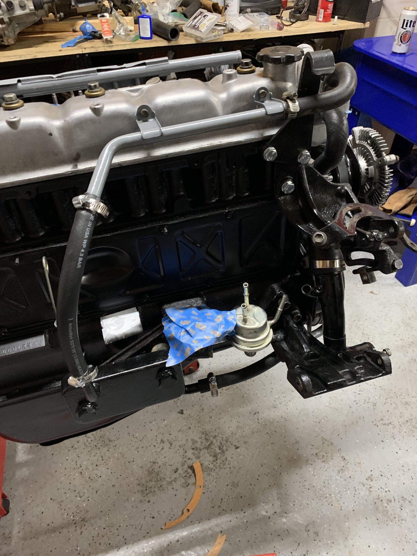

Just some little random fiddling is all I had time for lately.

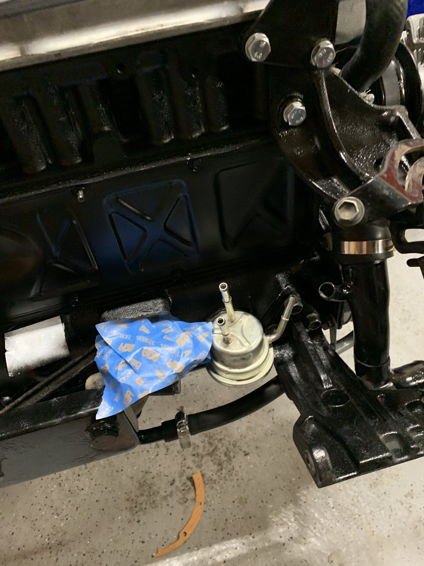

Fuel pump installed. (With the spacer!!!)
New oil cooler hoses

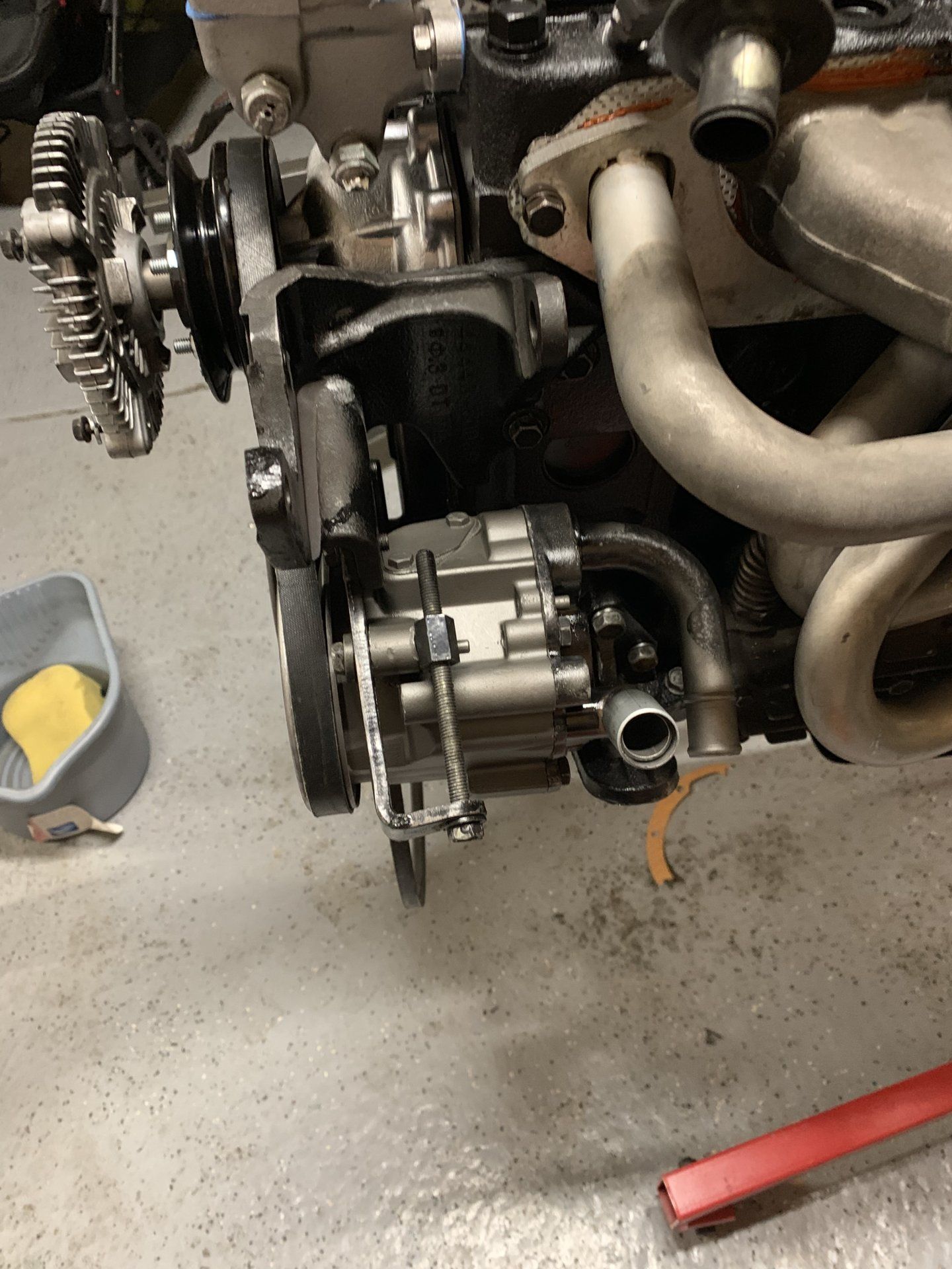

And a rebuilt smog pump!
I used the builders recommended by @Spike Strip B-Z rebuilders. They were super nice and had it back to me so fast.

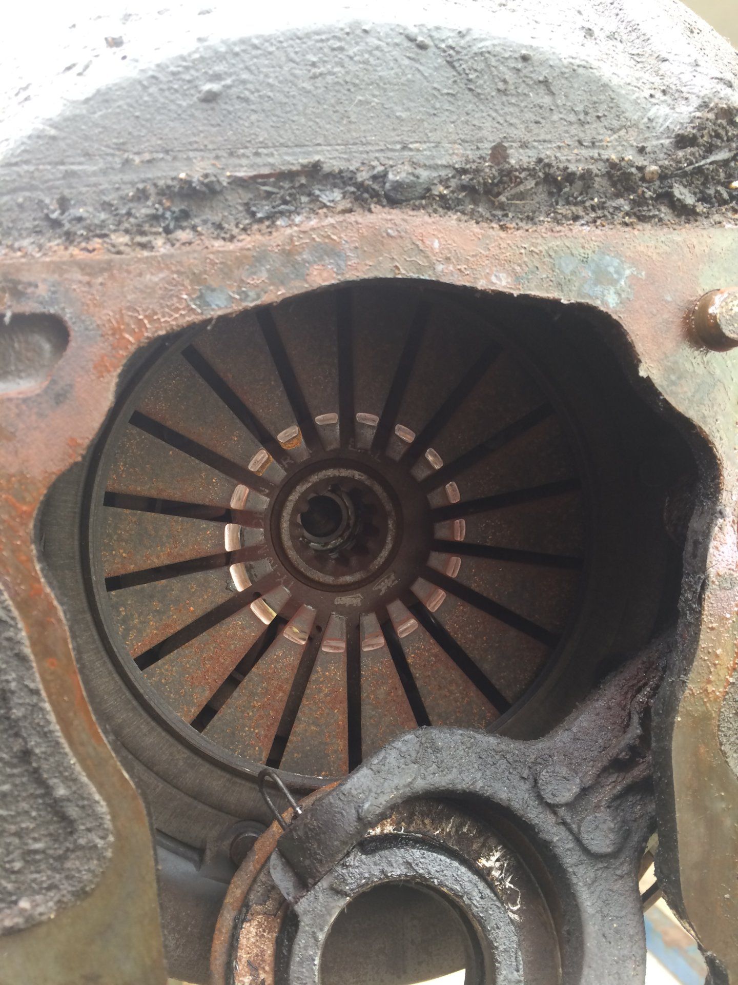

It slide together pretty nicely, and I was feeling super proud of myself when all the the sudden it just stopped with a quarter of an inch to go or less. Couldn't budge it. Finally figured out that the opening on my bellhousing is a different shape than the bearing cover on the front of the transmission.
I was bummed because my bell housing is stamped 3F and I was hoping I had one that would bolt right up. Guess not. Looks like I will make a template and get out the die grinder. I was thinking I would have the thing in the truck tonight or tmrw but it isn't to be. Learning something new everyday.
Also while I'm thinking about it, I'm having trouble getting the clutch fork to stay on the pivot point with the little wires attached to it. I wasn't to worried about it because it seems like once the transmission is in it will stay in place, but then I thought that I might be missing something. Thanks!

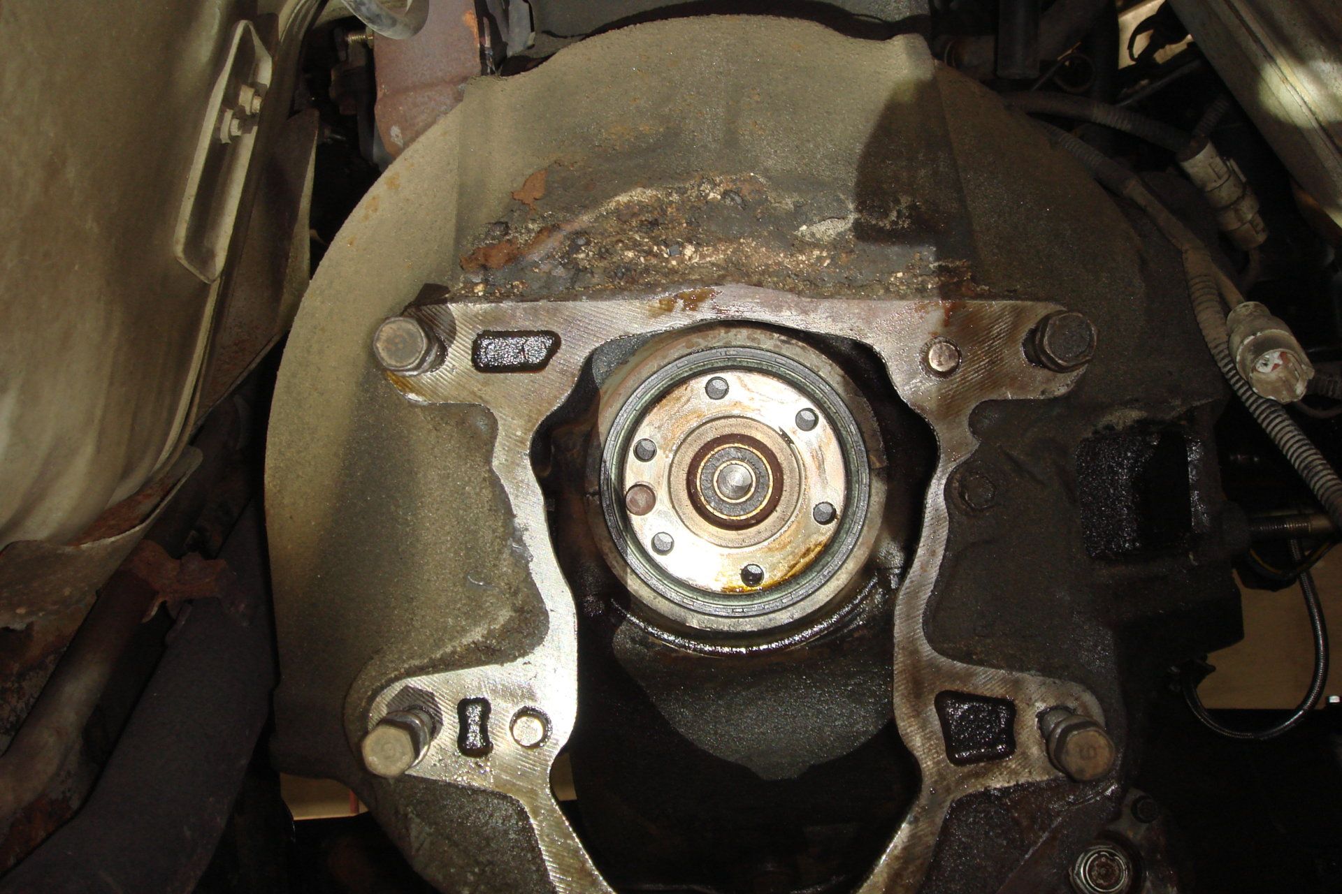

Below is a picture of my bellhousing on a'86 same as yours

Look one more time at mine and compare it to yours @OSS
Mine is def missing the rounded cutouts on the upper half. Also compare my 4 speed bearing cover to the 5 speed
