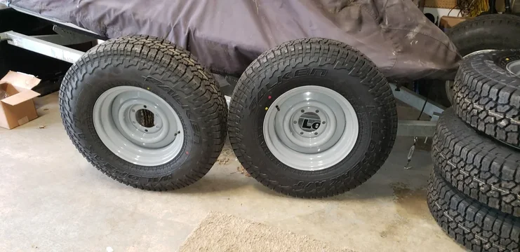

As a reminder from post #1, the wheels that came on our 40 were a set of Tacoma wheels, with a set of spacers all the way around. And no offense to @rckhound, but these weren't my favorites. And to be fair, he did offer a set of stock wheels with, if memory serves, 33 x 10.5 BFGs (also shown in post #1), but I declined.
I knew in advance that I wanted to move away from 15" wheels, and to 235/85R16s, but I also wanted to keep it looking as stock as practical, and wanted a wheel that I could install the stock 40 hubcaps. With this, I considered CityRacer 16s, but they are still 5.5 deep and the 235/85R16 Wildpeak A/T3W have a minimum wheel width of 6" - yes, I know this has been done, and many run the 33x10.5s on a 15x5.5" wheels, but... We might have gone with them, but they were out of stock multiple times, and we wound up purchasing a set of Wheel Vintiques 12-Series Smoothies, which are 16" x 7" and I hoped that I could get lucky and find a way to mount the stock hubcaps.
FJ40 hub cap not aligning well on a Steelie
It turned out that mounting the stock hubcaps to these would have been very difficult, and may simply not have worked. At this point, we figured, oh well, we will run them as they are, but we will at least powder coat them the original 40 wheel color and then enjoy them. I took them up to our powder coater and also took a set of stock wheels for color comparison. We already knew from other threads here in Mud that we were likely going with RAL 7036, and as you can see from the color cards below, it did seem like the best match, and that is what we went with. Our powder coater is excellent and uses industrial powders that have UV inhibitors, and even uses a primer, then the pigment coat - the wheels came out excellent.
RAL Codes for FJ40 wheel color
[ATTACH type="full" alt="Powder coated 16" steelies."]3815843[/ATTACH]
It also turned out that we pulled the trigger on the wheels and tires a little early, while the 40 work just kept going, and the new set of wheels and tires just sat here. Then, near the end of 2022, our 65 Chevy Carryall (Suburban in almost other years), finally came out of the paint shop, and it needed wheels and tires. So we took up the set that was sitting for the 40, tried them on, and they were perfect.
Fully restored 1965 Chevy Carryall (Suburban) with Steelies.
[ATTACH type="full" alt="Fully restored 1965 Chevy Carryall (Suburban) with 235/85R16 Wildpeaks on 16" Steelie wheels."]3815844[/ATTACH]
And now we need another set of wheels and tires for the 40.
