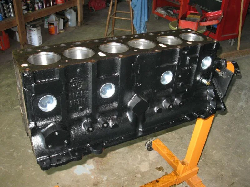

Back in town this weekend, started working on the engine again. Honed the cylinders, installed freeze plugs, and installed cam bearings. Then the problems begin. The cam does not fit. It seems that the bearings that came with the cam and lifters are .010 under-sized. Now have to remove the new bearings, and wait for the standard bearings to arrive. Hopefully, I can complete the assembly of the engine next weekend.
