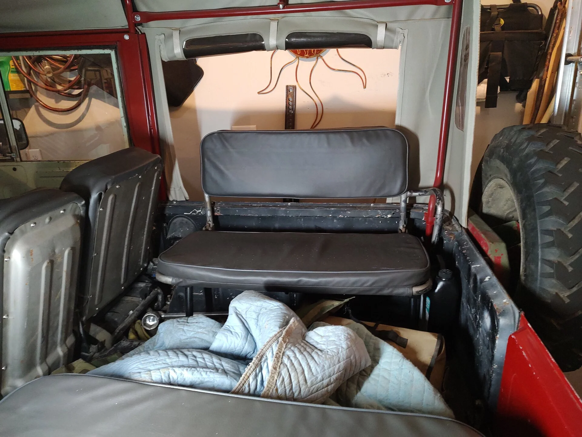

First, finished reupholstering the rear jump seats. Super easy job and was sure to use 14 gauge wire to strengthen and improve the look of the seams. Helpful tip is to fill in the seat bases with 1 inch thick foam, then fill the cushion with 2 inch foam.

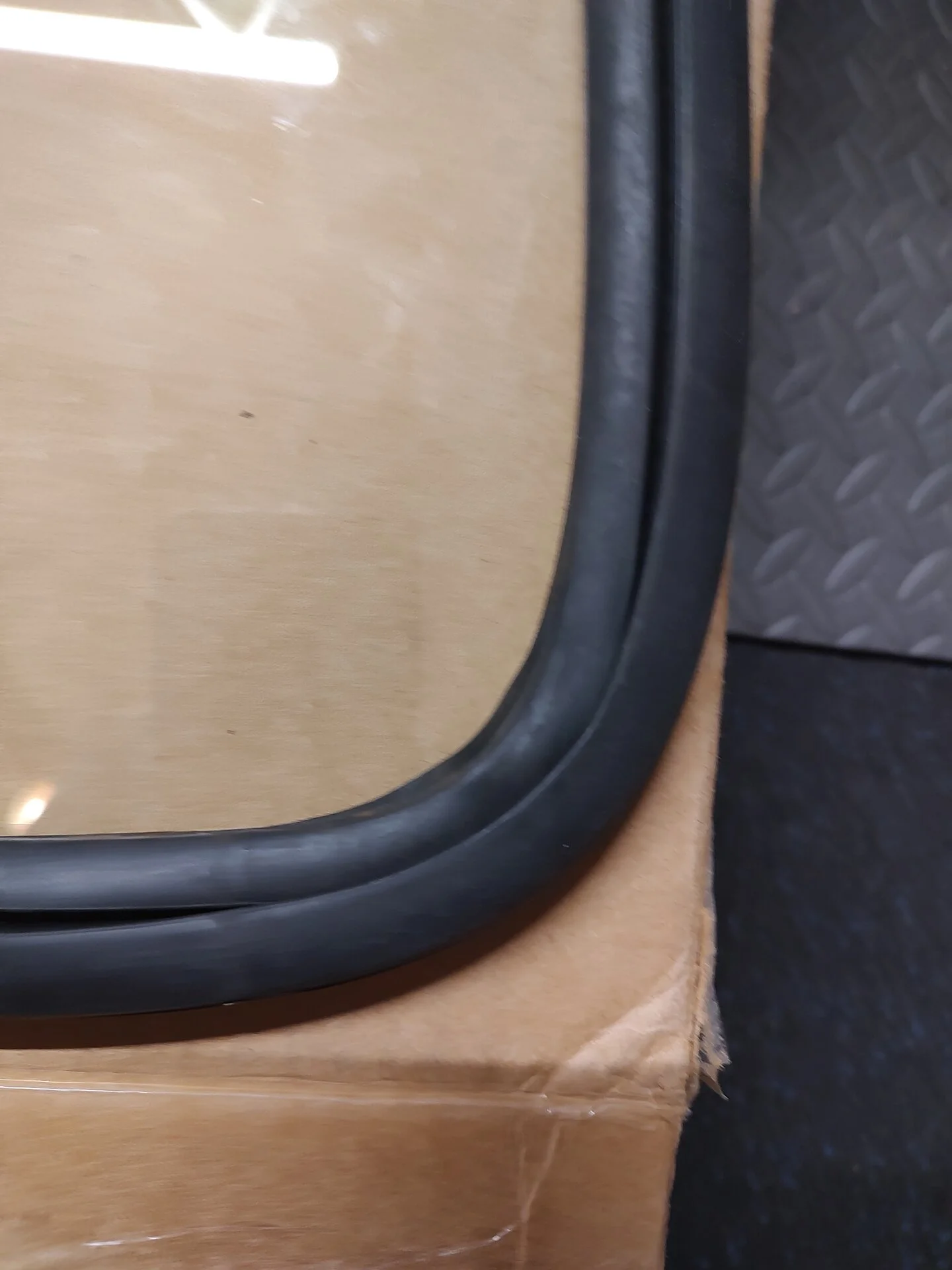

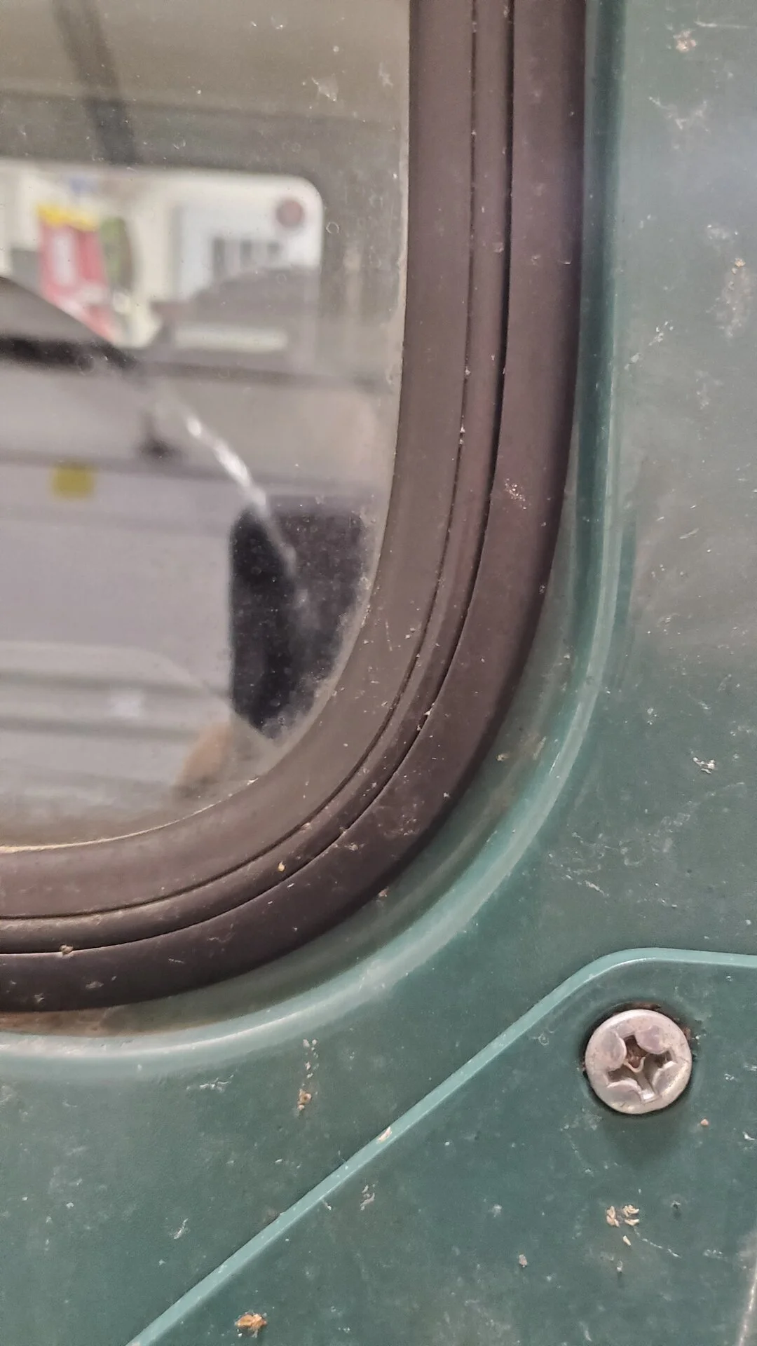

What I learned with the first one, is that installing the gasket on a flat piece of glass is harder than on a curved piece.
The windshield gasket fits poorly on the corners, bothe inside and outside the curve.
This time I will have help doing it
My window gasket looks to be even-ish on both sides, and also looks like the narrow side of the glass is indeed the top.
A heat gun may help a ton. Also I used a few plastic knives from my camping gear to help facilitate that mess.
Any chance you can remove the windshield frame and work on it while it's on a flat surface? I did mine on my dining room floor, I also remember my fingers hurting for a week once I finished.
