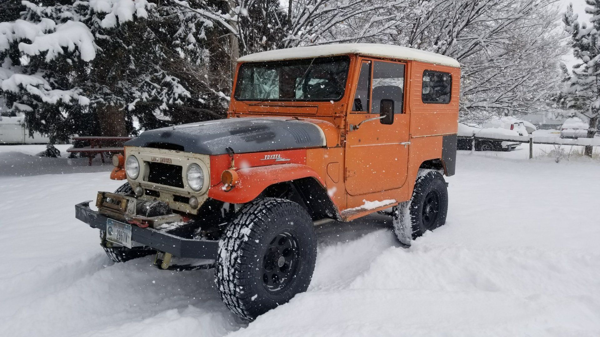

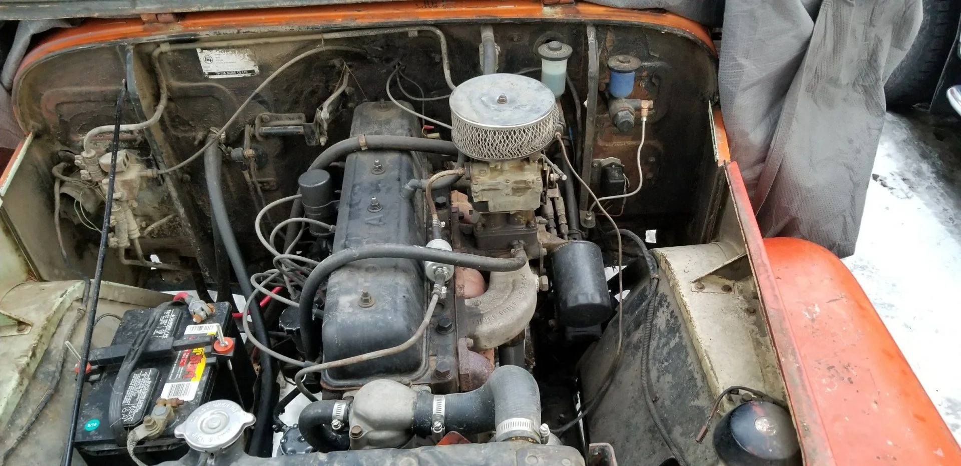

So I bought this 1965 fj40 and wound up putting a solid running motor and tranny from a 1970 fj40 in it. Not certain if early 70, or late 70? How do I find out?
I put a pro comp 2.5” lift kit on it, with 285/75/16s. Tires fit great and don’t rub, but did develop a sort of metal rub or whine, some kind of noise, under the tub, but only on acceleration or higher rpm when shifting from 1st to 2nd, and to third, but it’s fine in 3rd and ok in lower gears not under acceleration. U joints seem ok. Does it in in two and four wheel drive.

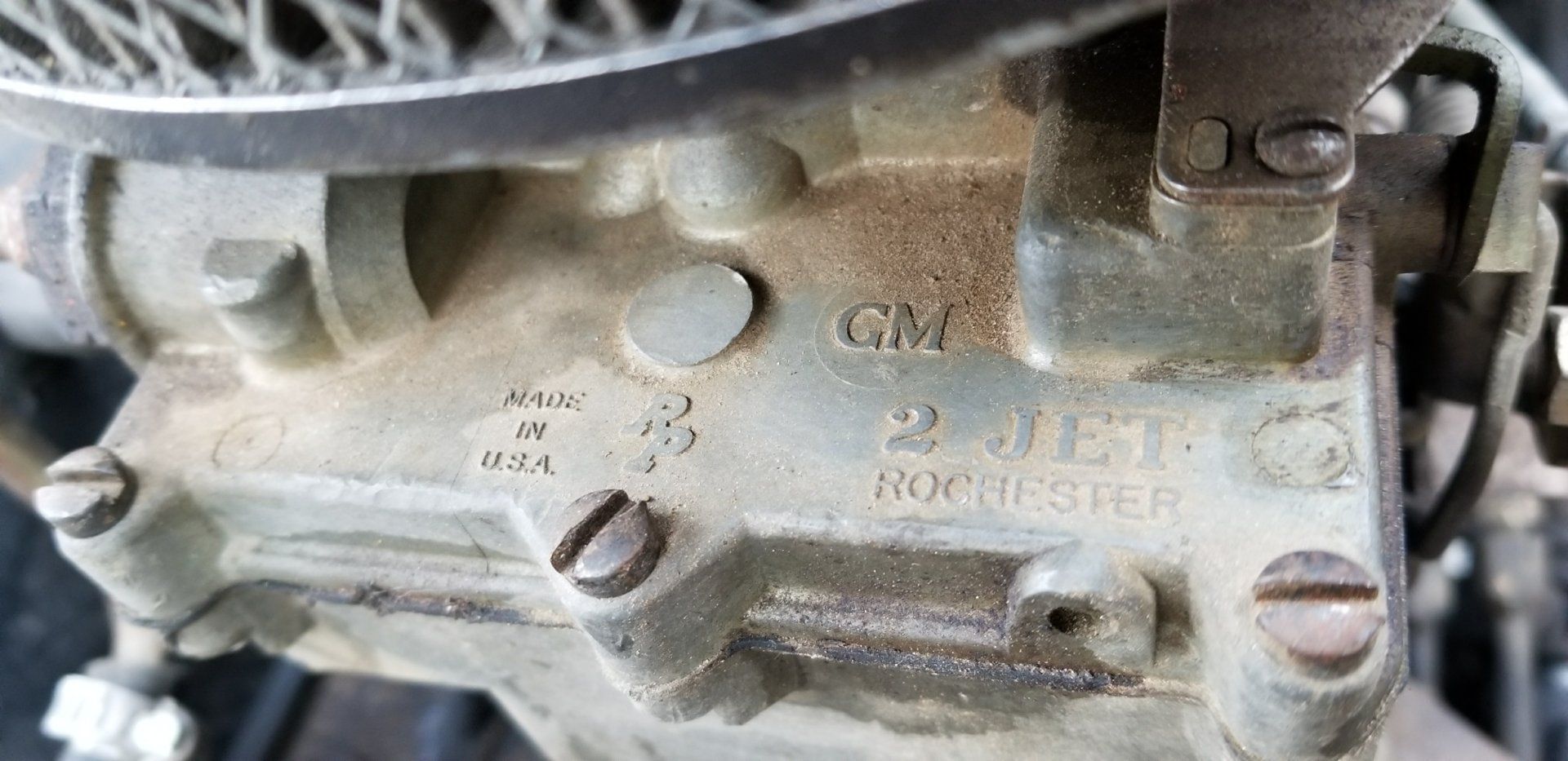

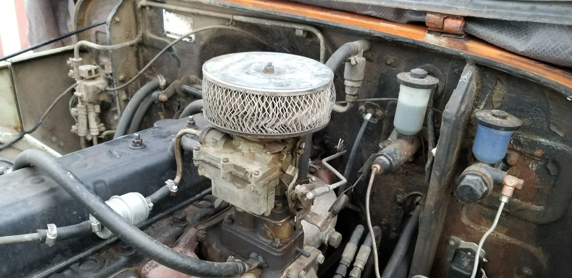

Carb issues too. It has this Rochester on it. It s ok but needs a new kits every few years, starts flooding out. Would I have any better performance out of a Webber or something else?
How about air cleaners? Never much liked this, wouldn’t bigger be better?

Mark’s Off Road Burbank, CA has them and would make sure you get a nice used exhaust manifold with a working flapper. A funtioning heat riser manifold is helpful. I just recently learned Mark’s has some 1 year production only(1969) wide runner intake manifolds too:cheers:.
Here’s a link to the Hi-Po intake’s 65swb45 has in stock. I just planed and resealed my 71 manifolds or else I’d give the wide runner a try. FWIW the fel-pro in/ex gasket is nice, it has wide flame rings:cheers:.

Your 40 is gorgeous and looks like it's living the badass-40 dream!!
