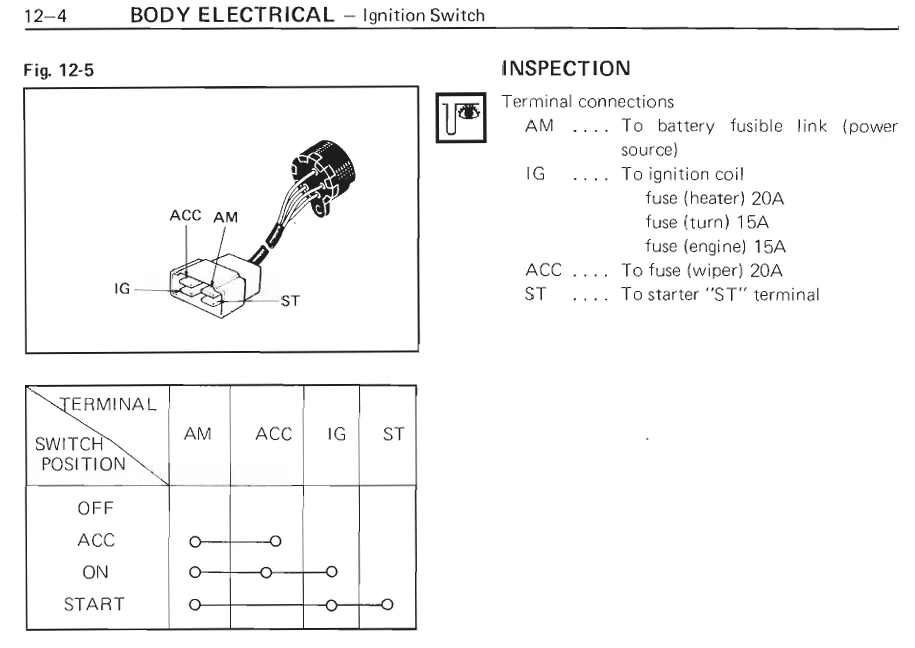

Thanks, very helpful. I'll look at this next and hold off on removing the key lock cylinder.
Start with a multi-meter and your FSM, you should have no continuity in the off position, then ACC, ON, and ST. If all that is working and it's not "crunchy" when switching, you may be able to rule out the rebuild (or verify the switch issue). FSM also has the removal steps if you need to pull the cylinder.

Sending a Big Thanks to @MatthewMcD and @Grayscale. You guys were spot on.
Confirmed the ignition switch is not operating correctly. Effectively has an open circut at the start position (hence not voltage to IG during crank). And it is not an OEM/Toyota part. Replaced it with Toyota part 84450-60070 and the rig started immediately on first crank.
