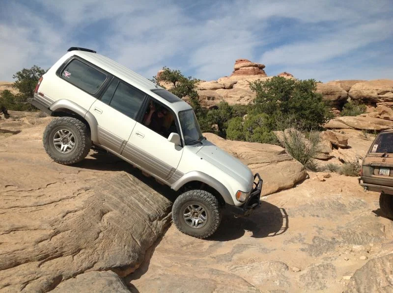

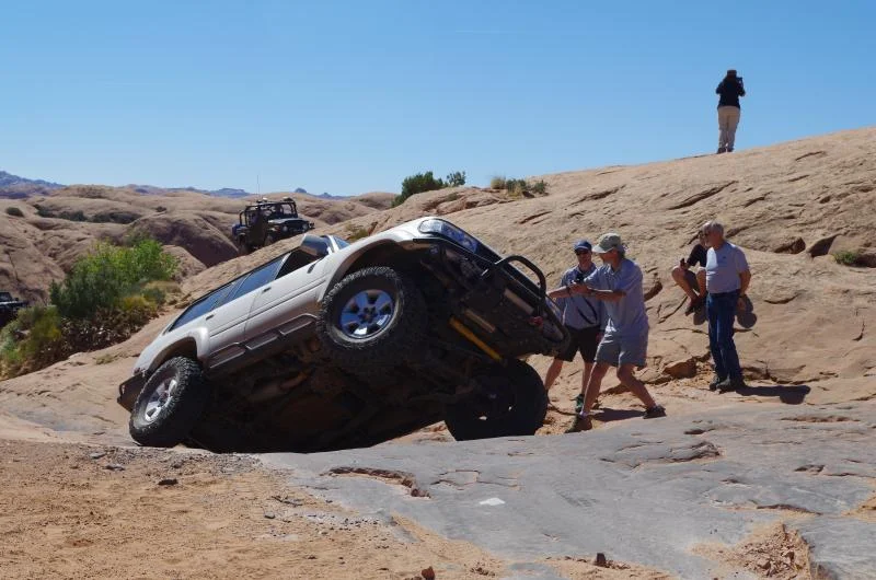

Several locals run the same setup with good success, AzTony on Coopers w/ FJC rims, clarkrw3 with Nitto Trail Grapplers on Tundra rims.
