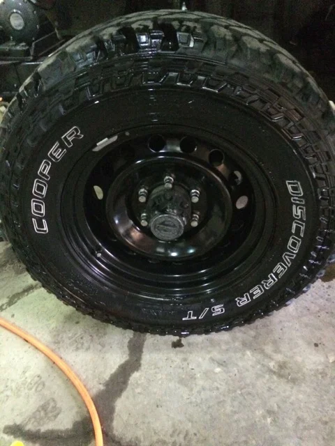

I've looked around and haven't seen anything about using wheels from a Tacoma or Tundra on a 40. I really dig the looks of them and was wondering if they will fit around my WARN barrel-style hubs and if the 6 lug bolt pattern is the same?
I believe the center bore on the wheel is 106.1mm but I don't know what the OD of the WARN hub is. I currently have 255/85 R16 tires.

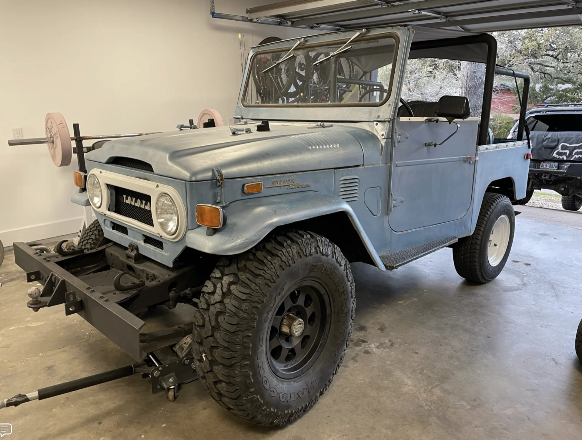

I'm curious about 17" on a 40 as well.
This issue is the center bore. The 17”
FJC wheels don’t have the issue.

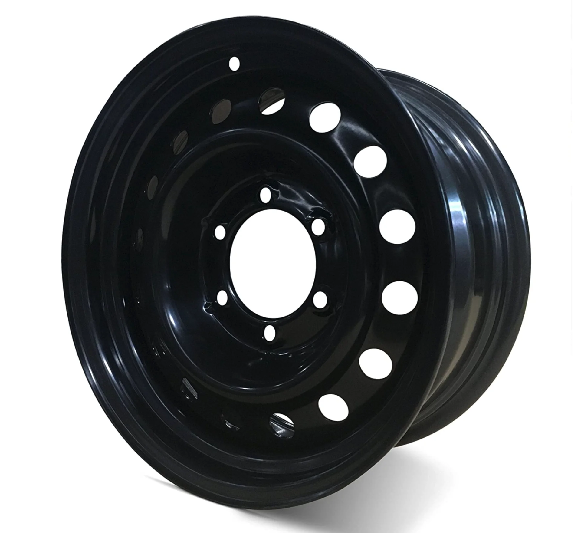

Some of the 16” steel versions fit and some don’t. I don’t know which part numbers work and which don’t, but I bought a 16” and it wouldn’t fit (center bore too small) on my 1989 4Runner (similar bore as 40 Series) but the spare from under my 1998 4Runner fit fine.

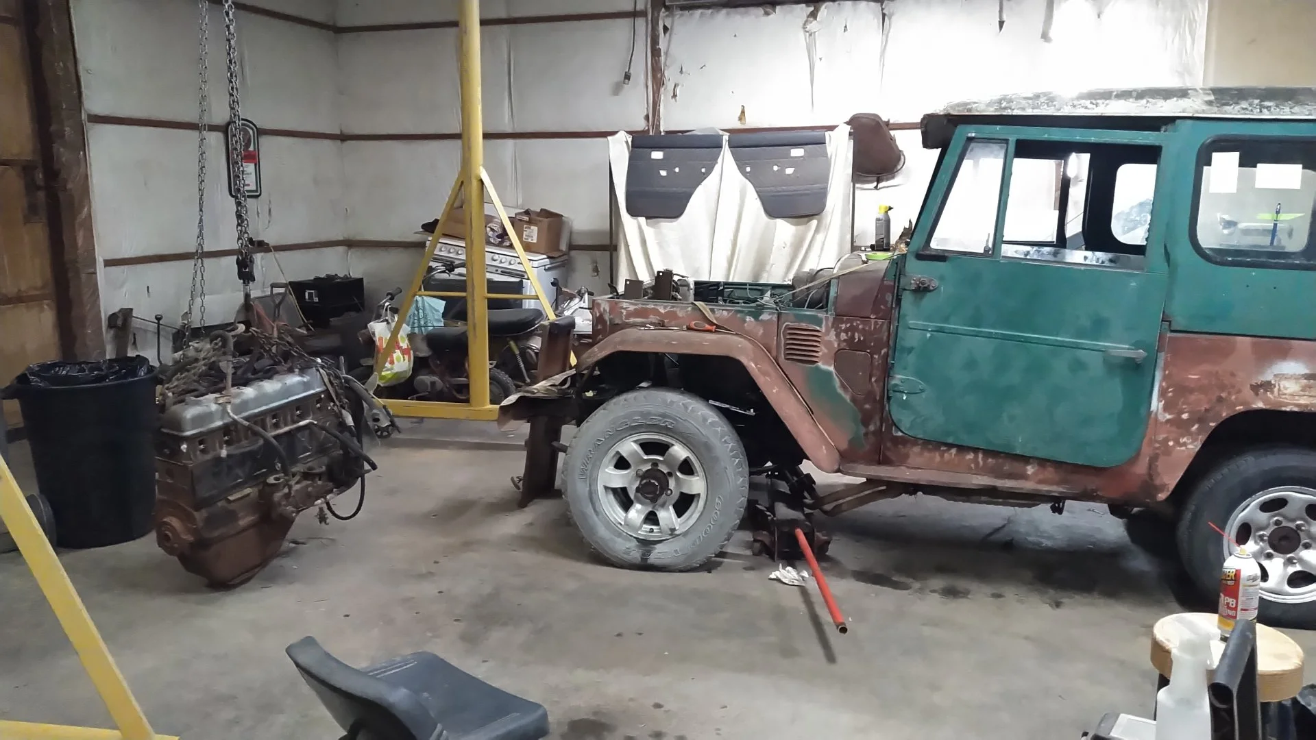

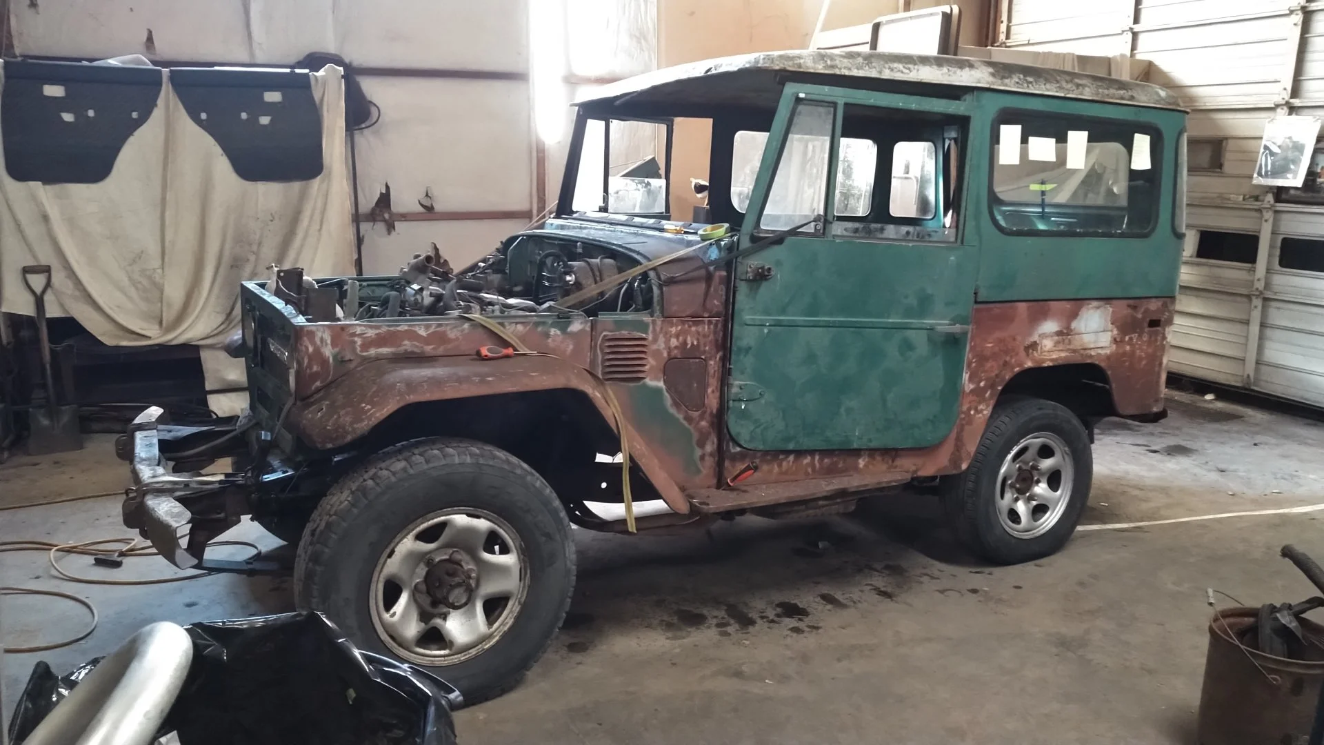

I have a 2005 tacoma and confirmed the bolt pattern is the same. 6 x 5.5 (139.7). This aftermarket wheel (16x8) fit perfectly over the hub. The wheel is 4.5" BS and I did have to add a 1" spacer to clear the brakes.
Note I still have the small wheels / tires on. This was simply a test fit of the tacos 35s to see where I stand, how much lift and what type of cutting I'd need to do as I figure out what I want to do with this over time.
