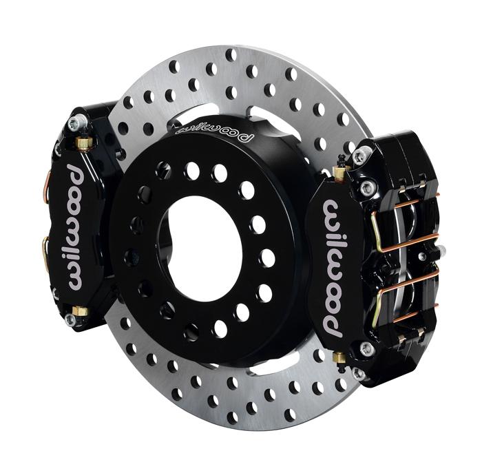

If you keep your mechanic, I'd suggest going with dual calipers. :grinpimp:
