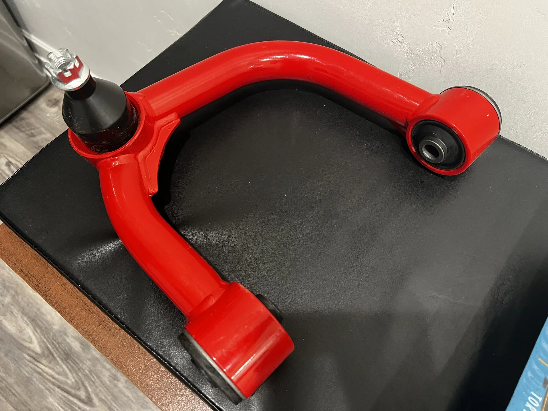

Sometimes China delivers 80% of the value for as little as 10% of the price. I just need alignment and reasonable durability for light duty off-roading. I’m willing to TOFT to find out if these cheap UCA’s from China are good enough. Here’s a picture of one:
Looks great; got a link for them? If they hold up, I'm willing to try them as well.

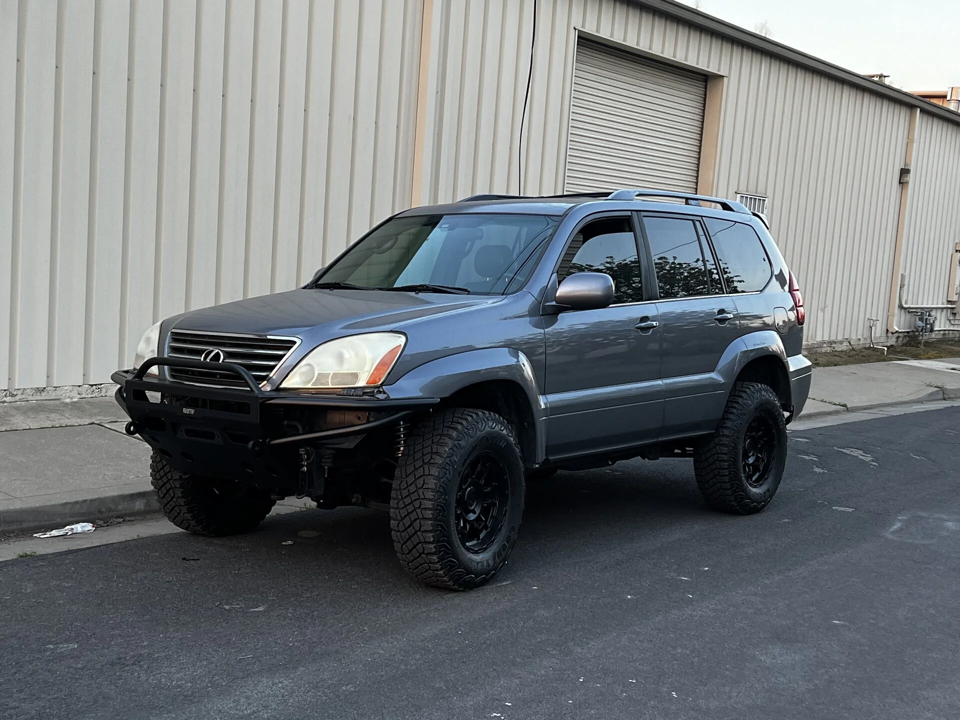

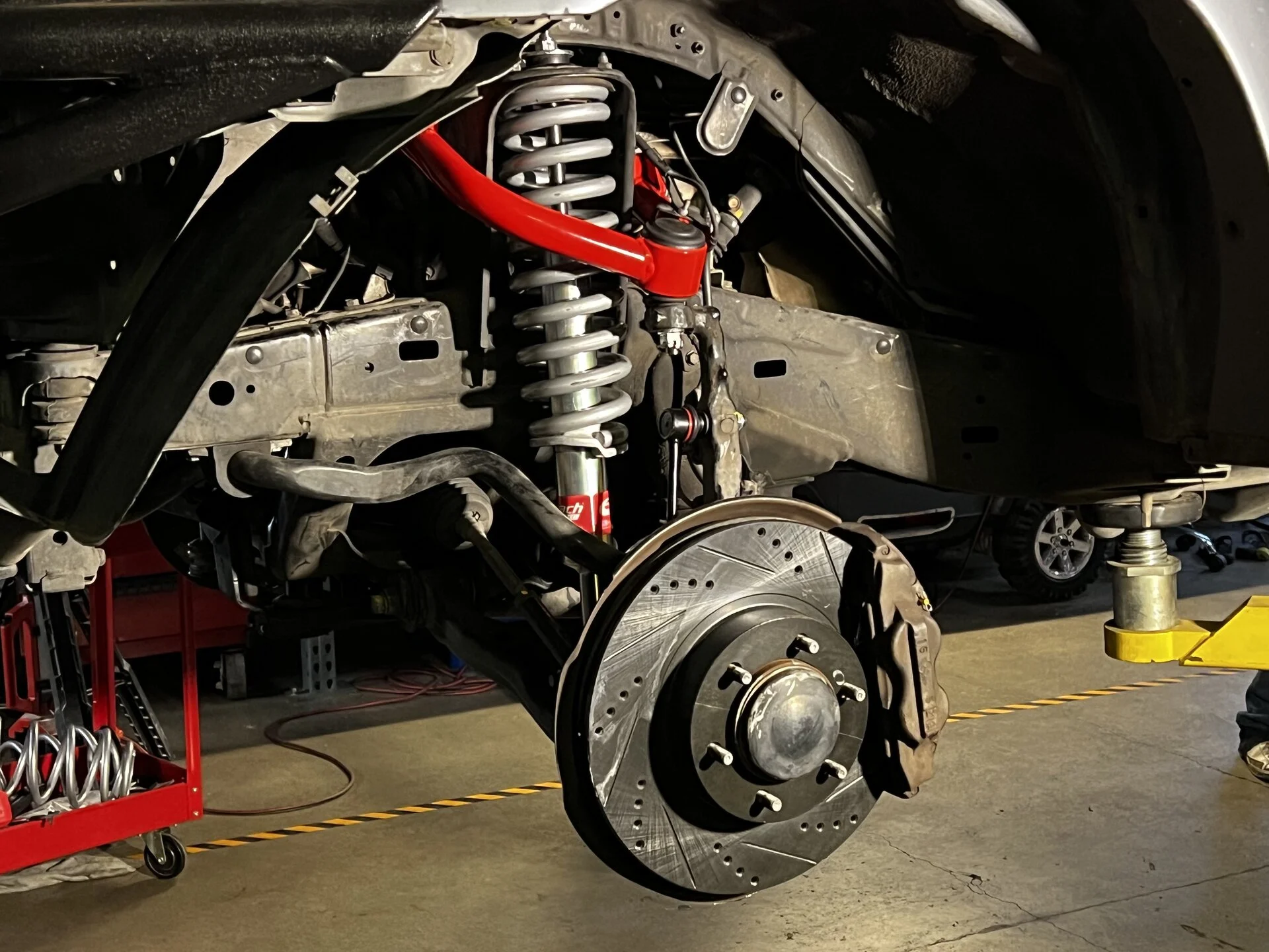

I quick update and a few questions. The budget build has begun!! BAMF high clearance front bumper is installed (see picture), running boards deleted and roof rack deleted.
This weekend the following is going to happen:
1 - Eibach 2.8" lift kit. Already assembled the front shocks which I would like to never do again.
2 - new $80 UCA's
3 - new front rotors/pads
4 - various bits: Moog LCA ball joints, Freedom Offroad diff drop & extended sway bar links which I suspect I may not have actually needed
5 - DX4 wheels (TRD look alikes at 50% less) + Goodyear Wrangler 285/70R17
This truck's mission is to safely transport my teenager to high school daily while looking great and performing well offroad. Obviously a budget build like this isn't going to do any serious offroading. If we get into it, then I'll keep going and invest more into the suspension primarily.
Question: Rock Sliders??? I've researched all the usual suspects and no one has anything in stock. Originally I decided to forgo the expense of sliders and the entire rear bumper, swing out, spare etc set up to avoid spending $$$ and looking (even more) like a poser. Now I realize that I'm not a youngster anymore and I kinda need the step to pull myself up and in off the ground.
Everyone I've contacted has 3 to 5 week lead times which is fine except that I'd like to wrap this up and move on to other projects without waiting for the sliders.
Is there anyone out there in NorCal who would have GX470 sliders in stock ready for pickup? This is a budget build. They don't need to be badass. In fact a cheap set of returned or used "scratch and dent" sliders would be perfect. Appreciate any help. Thanks!

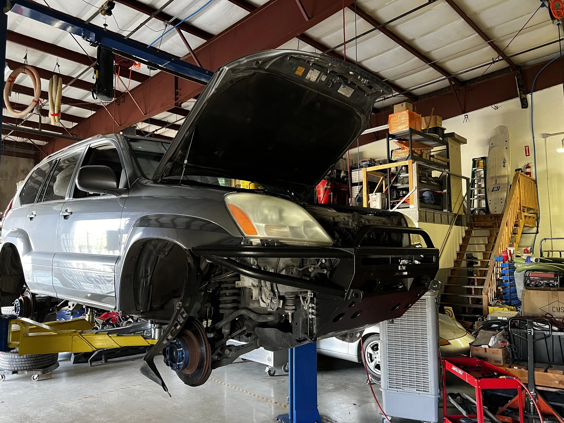

Here's the truck as it sits now in my friends garage:
2 - new $80 UCA's

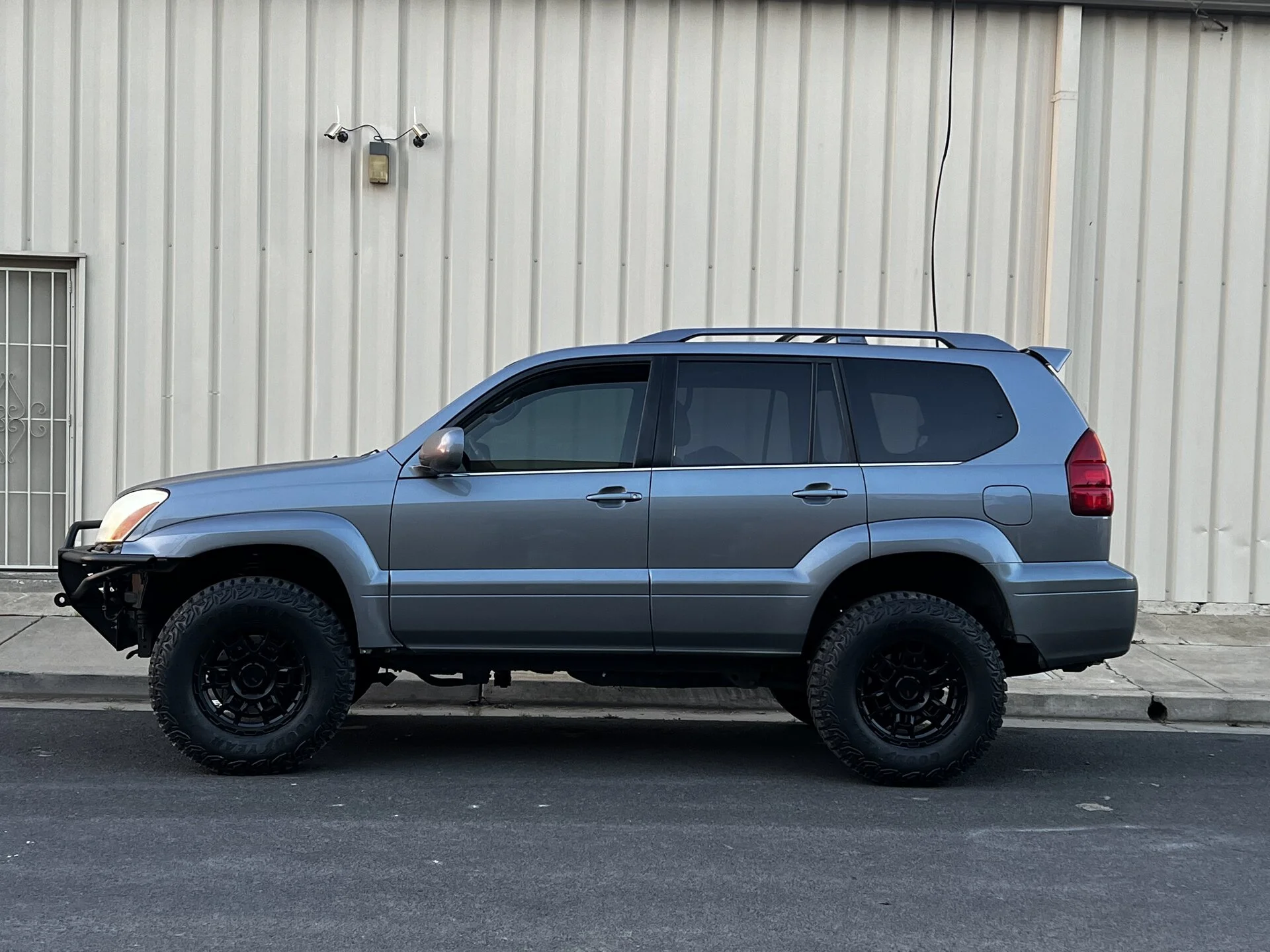

Latest picture of the front end. If all goes well, should be back on the road by Monday to get an alignment and SMOG.
Looking good as new. I’m eager to find out if your cheap UCAs hold up.
The area of concern is the ball joint and bushings. Keep an eye on those

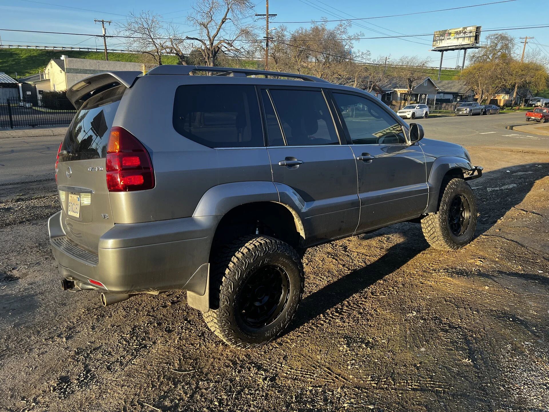

Here's the "finished" product. Although you all know how this goes...now I'm thinking it "needs" sliders, and some lights, and a roof rack, and wouldn't it look cool wrapped in desert tan like the new GX550, and and and....!!!
