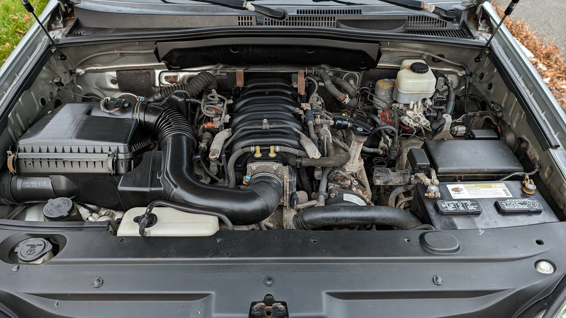

Here's the day I got it:

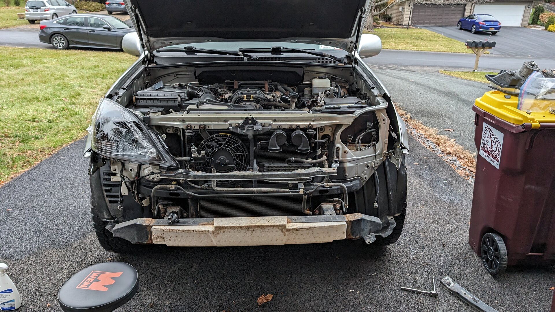

Been a while since I've posted; I've been super busy. Recently upgraded my headlights to black gloss housing headlights from USR.
Whole front end pulled
Bracket snapped... Need to glue this back together.
New!

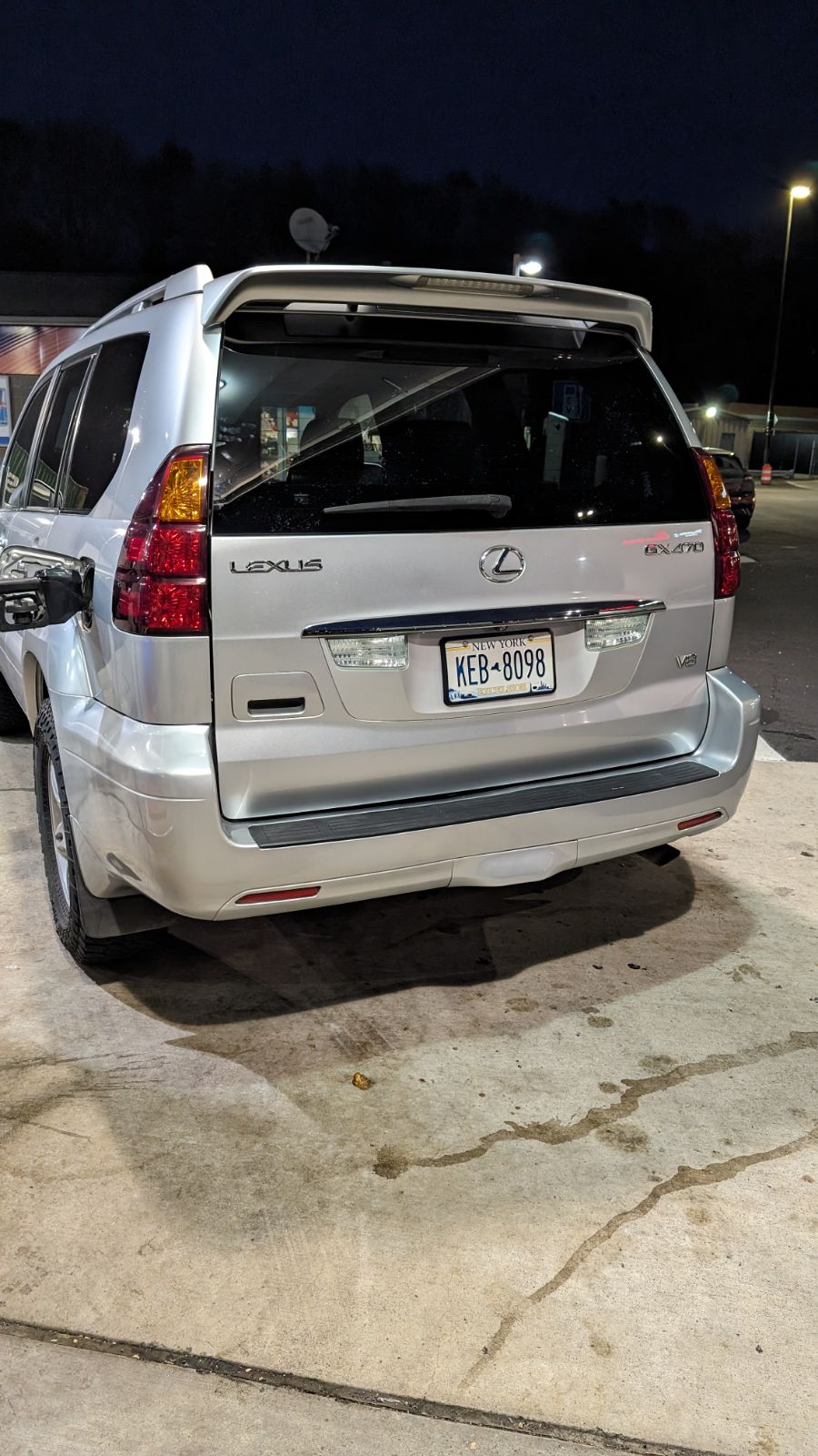

Also did the tail lights. Could not get one of the rear lights to seat properly, but after I opened the screw hole a bit more for attachment, it worked.
Might as well clean this area out now while it's exposed!
Note that the plastic tab circled in red (old light) does not come on the new lights.
Done! Here she is in the rain. Starting to come together!
