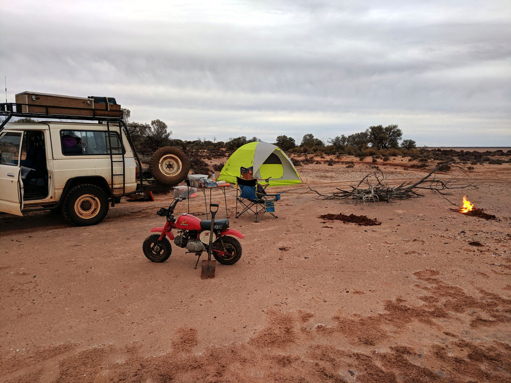

Had a ladder on the side of my oz patrol for 40+ years. It's been down 1000's of k's of tight tracks and if anything, helps protect the bodywork.
Essential to access stuff on the roof. The rack bolts to the exoskeleton and mounts to the side bars. So all of it is basically tied to the chassis vs the body.
