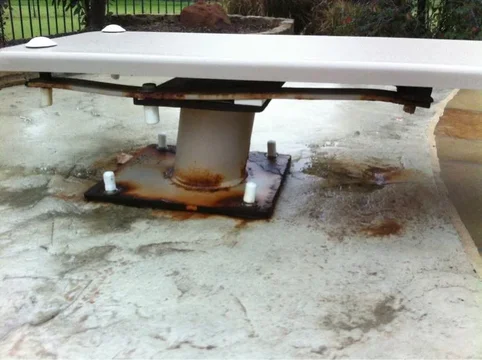

Well you are right PC is the overall choice of MUD and really mine too. On our '05 T4R we just sold I PC'ed everything I could and it all seemed to do well. I don't believe there is a fix all, especially in the conditions your describing (had no IDEA things got that bad in Tulsa). I just had a customer ask me to sand and paint his diving board base cause the salt in the pool had a field day with it over 6ish years.
This pic doesn't do justice to the damage. It seems as if the rust started under the PC and blew up from underneath cause as we worked on it the top seemed not to bad until a huge chunk would break off! But as you stated if your wiping down and treating as you go through the seasons then maybe it wouldn't be an issue?
-Daniel Kent
OT and verbose...
One thing to note regarding PC, galvanization, or any other coating that comes in direct contact with concrete is, they'll all fail, regardless of the presence of salt in the environment.
The ~80 year curing process of concrete emits very corrosive chemicals that standard steep coatings can't withstand. In the industry to which I'm familiar, connections on or below grade are oversized to a certain percentage of its yield strength, in an effort to provide more structure than the hydration process and it's byproducts can deteriorate in any real world calculation.
There are some prohibitive measures to minimize, which do work in the most corrosive environments, until they're attached to the foundation with anchor bolts.
In your pic, I'd bet cash money that the chemicals the anchor bolts transmitted through the punched base plate were the origination point of corrosion and once it began to deteriorate the PC, it was over.
Should you ever encounter a situation similar, where you may be responsible for anchoring a coated steel plate in close proximity to a pool, and want to slow this process, research epoxy anchoring systems.
It's been my observation on a structure similar in nature that the epoxy must provide some degree of insulation from the alkalinity. Out of around eighty total anchors in said building, sixteen weren't set correctly in the pour and we had to epoxy them in. They show no evidence of the surface deterioration that the other sixty four do, after eleven years.

That makes perfect sense. If concrete contact is the factor the your rigs have nothing to worry about. :D

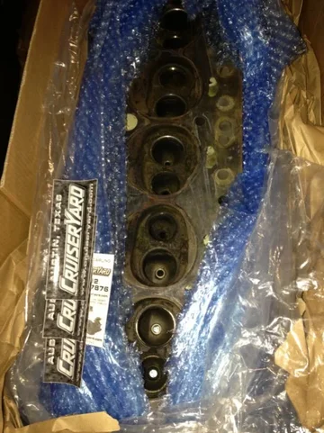

Going back to the head, since prepping and packaging to get to Robbie to get started on.
What's the best means to achieve as close a match to Freeborn Red as possible, in a paint system that'll last?
Needing to get started, finally, so this will be the first decision that HAS to be made.

Google Translate claims a Freeborn Red match through an auto parts store (somewhere the speak Espanol) in high temp.
Talked to Josh, my buddy at Cruiser Corps, about head paint and he said that they'd metal etch prime, then base and clear with the same PPG product they paint the body with.
I asked about using their rattle can version, since it won't be possible to paint at the same time the balance is painted, and he said it's a single stage paint, so would require several light coats.
Probably over thinking this ( :flipoff2: ) but since the head will be built in Boulder and not efficient to ship fifteen times to paint, wondering how viable the rattle can Freeborn Red paint would be, considering the desire to match the exterior and provide Robbie with the paint to achieve in house, versus sending it out?
