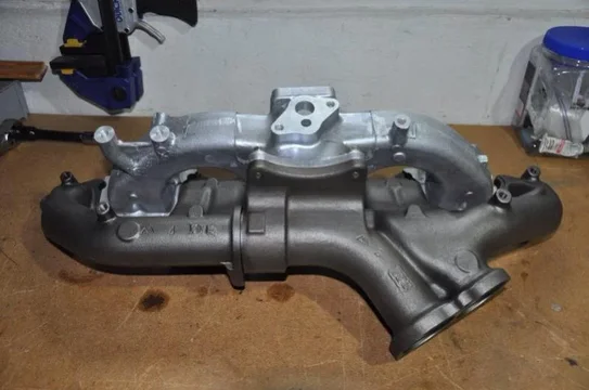

Bert to hope for is Toyota's modifications to the later years allow for more thermal movement, hopefully, minimizing stresses that crack the earlier, designs.
The joint in the center of the manifold isn't solid, but think the 3FE manifold is probably a better design.

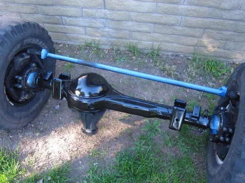

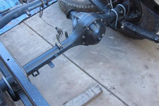

Here is an image of the SEM rust shield painted on a raw 6x6 hot rolled post with no prep work besides wiping it down with Wax and Grease remover. Attached are a couple undercarriage pictures as well. The color and finish are flat black with gloss hardener, leaves a real nice satin finish.
Nice! Thanks...
