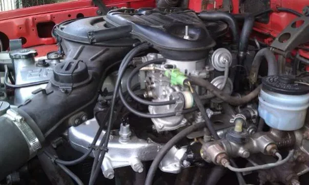

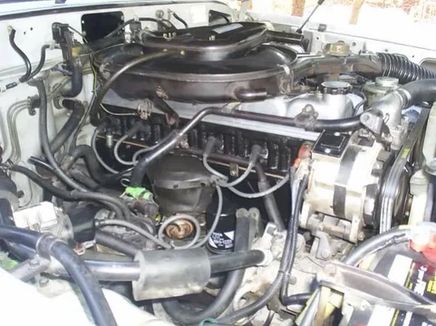

Discussed ceramic coating the intake/exhaust manifold with a local coater/car buff, and, based on a cursory glance at the manifolds, he questioned wether or not ceramic may lessen the lifespan by not allowing the heat to dissipate out of the "pot metal" construction.
Thinking others may have stated similar, so back to square one on what to do to maintain a decent finish on the exterior surfaces of the manifolds, even if the inside is ceramic coated.
Still debating, but based on the fact that these manifolds are not easy to come by, but have proven to maintain through however many heat cycles are typical 250-300k kilometers, may leave the things alone and run 'em as Toyota intended.
The exhaust will be coated. Regret not doing on the 80, but only from an aesthetic standpoint.

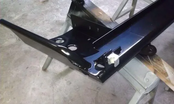

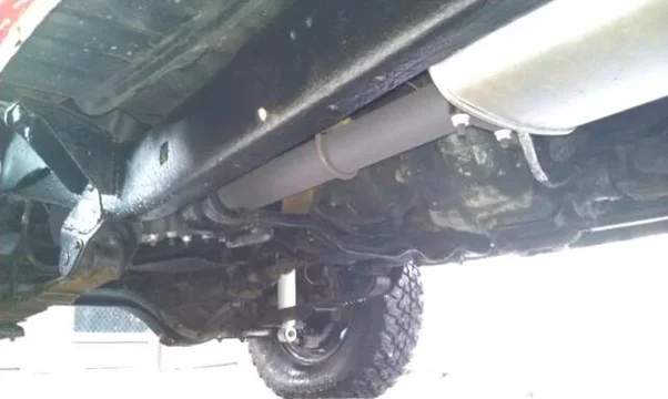

This is what I have used for frames, brackets, axles, etc... I have had great luck with the SEM product line. In the link below I use the flat black with the gloss hardener. It leaves a great satin finish. It also rolls on very well leaving a smooth finish.
http://www.semproducts.com/rust-shield/
For other brackets where I need a spray can I use SEM Trim Black. I have never seen a product that lays out like this and is very durable.
http://www.semproducts.com/trim-black/

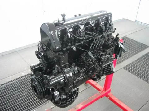

"I'm a bit hung-up right now waiting for tranny parts and for the frame to get galvanized. (The galvy shop had a breakdown and won't be up and running for another week or two) Decided I'd do a little work on the engine and get it painted. Got the oil pans on for good and things cleaned up and sprayed it today with Sem Rust Shield. Good engine paint...Sticks like glue and shines pretty well."
Considering the guy sprayed in a downdraft booth, going to assume he's experienced.

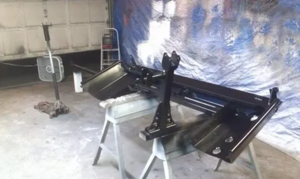

I had a long talk with the guy that's gonna paint my cab & bed, he does lots of muscle car restorations, has a room full of trophys. He says his standard method is to have the frame sand blasted then as quickly as possible he shoots it with the SEM Rust Shield. He then uses SEM Chassis Black on top of that. He shares my opinion that POR15 is a waste of time and money.

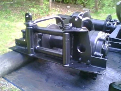

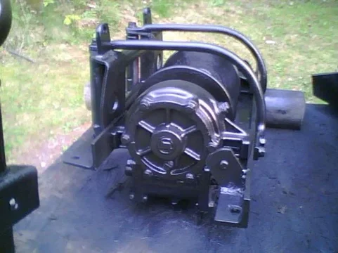

I went to the paint parts store (when I redid a chassis for a friend) and asked them what they would recommend. The paint was an SEM chassis black, and was around $40 a gallon. It was the industrial single stage, and needed a little hardener and thinner. All total was around $75, and I shot the chassis, some other parts, and two PTO winches-including vtcruiser60's. Shot great, and all in all was darn cheap.
A minor point....but it is my understanding that hardener simply accelerates the cure time for paints, it does not actually produce a final product that is "harder" in any way. If you have a need to speed up the cure time, a hardener makes sense.

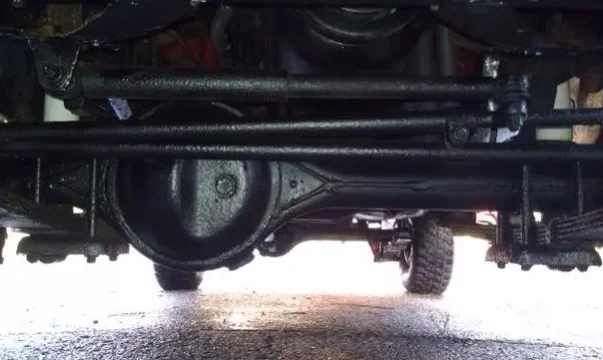

I am happy with the paint. The same paint I use for everything. SEM Rust Shield black. Mixed with Fast dry urethane grade reducer. Dry's like a rock.
One of scrowley's projects...
Another....

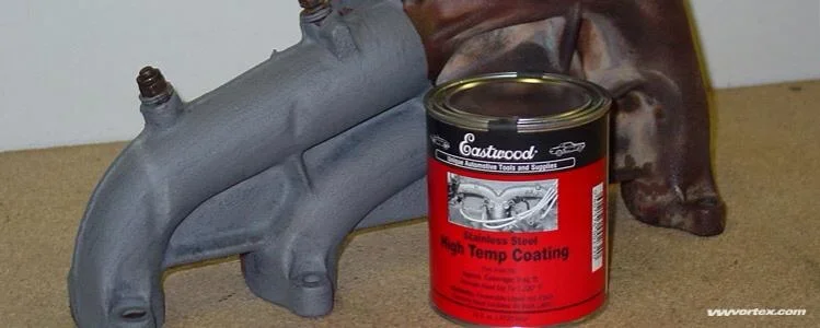

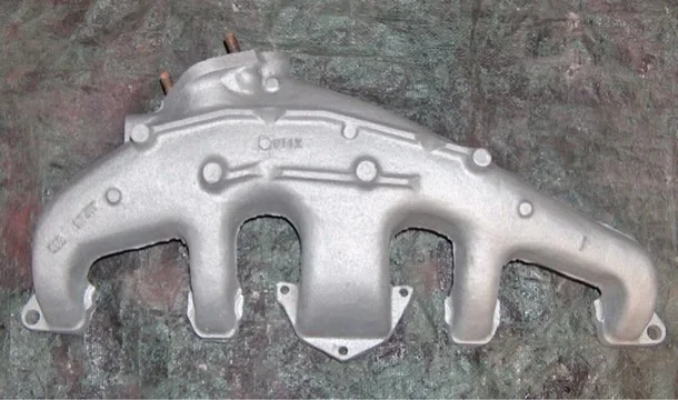

Intake manifolds last forever, not so exhaust manifolds.
Would any coating or treatment prolong lifespan
I do not think so. Mine cracked and was done
...could any type of coating prevent cracking?
There is no way IMO, to stop a cast manifold from cracking. Between it being cheap pot metal, and the heat cycles expanding and contracting it, its just an inevitability that its going to crack.
