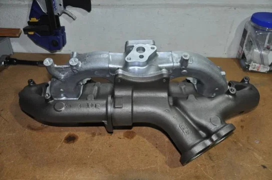

Intake manifold raw aluminum or clear powder, exhaust manifold hi-temp paint or ceramic coating.

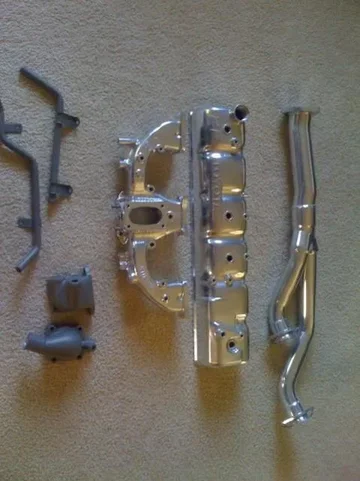

Jet Hot for manifolds, valve cover, coolant tubes, thermostat housing?

I had two exhaust manifolds creamic coated, before I bought the headers and they ran @ $125. What's nice, other than the pretty coating, is they reduce the heat to the surrounding areas. Might not be good on the valve cover, would the powder hold in the heat?
As far as the other pieces, you are right, don't bounce around with different coatings. Pick one and stay with it. The frame will need something different than the motor, etc.
My experience with ceramic coating is limited to quad exhausts and the results were mixed, but in fairness, I don't believe that ceramic coating is meant to be continually sand blasted and when the exhaust is a mere inch from your leg, a 20% reduction in temps is similar to turning down the heat from boiling to simmer....still hot, hot.

Going to submit a quote request to Jet Hot on the exhaust manifold. Based on the reply, will research local ceramic options.
I'm a little concerned about the down pipe and how close it will be to the firewall, so anticipate ceramic for it, too..,.once fabbed since the 70 series I bought with manifolds had absolutely no chance of working
Reading about the benefits of Jet Hot, assuming the process is proprietary and not a run of the mill ceramic, it sounds like there are benefits beyond ceramic in the duration department, but if it costs more than the manifolds I may be out.
