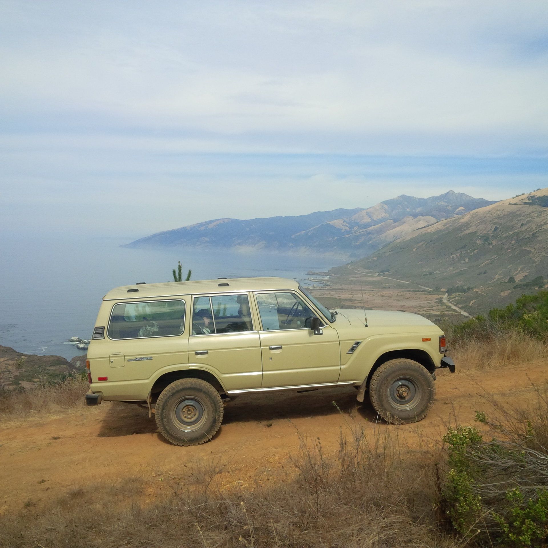

For many years I ran BFG 33X9.50s on my bone stock '84 FJ60, for rubber overdrive and more trail clearance. Sits that way still. I always got where I wanted, and I did some pretty tough trails in the hinterlands of the Four Corners area and Nevada. I'm running BFG LT235/85R16 ATs on my '86 FJ60 with 3FE, H55f, FJ62 transfer case and axles (4.11s), and OME suspension. The tires are about 32" tall. Of course this new combination is a lot better in many respects than the '84.
Here's the '86:
fj60-lift-1-jpg.1806198
