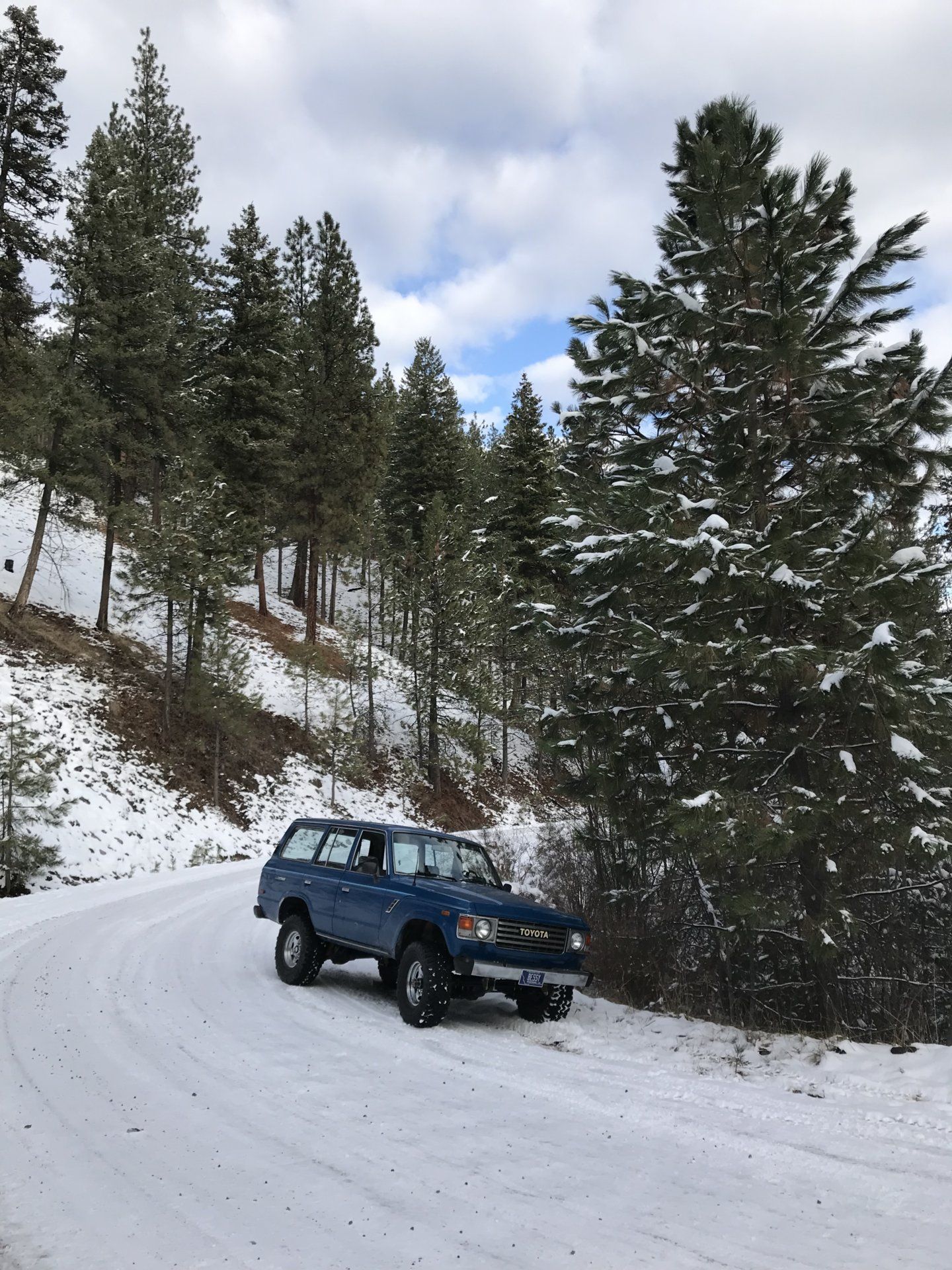

The 2 blue 60's have 32's with 2-3" of lift. Frankie has another 1/2" of body lift. The 3 light colored 62's are running 31's. The closest of these has 2-3". All are 15" rims. 32's only come in 11.5" width so they won't safely mount on the OEM rims.

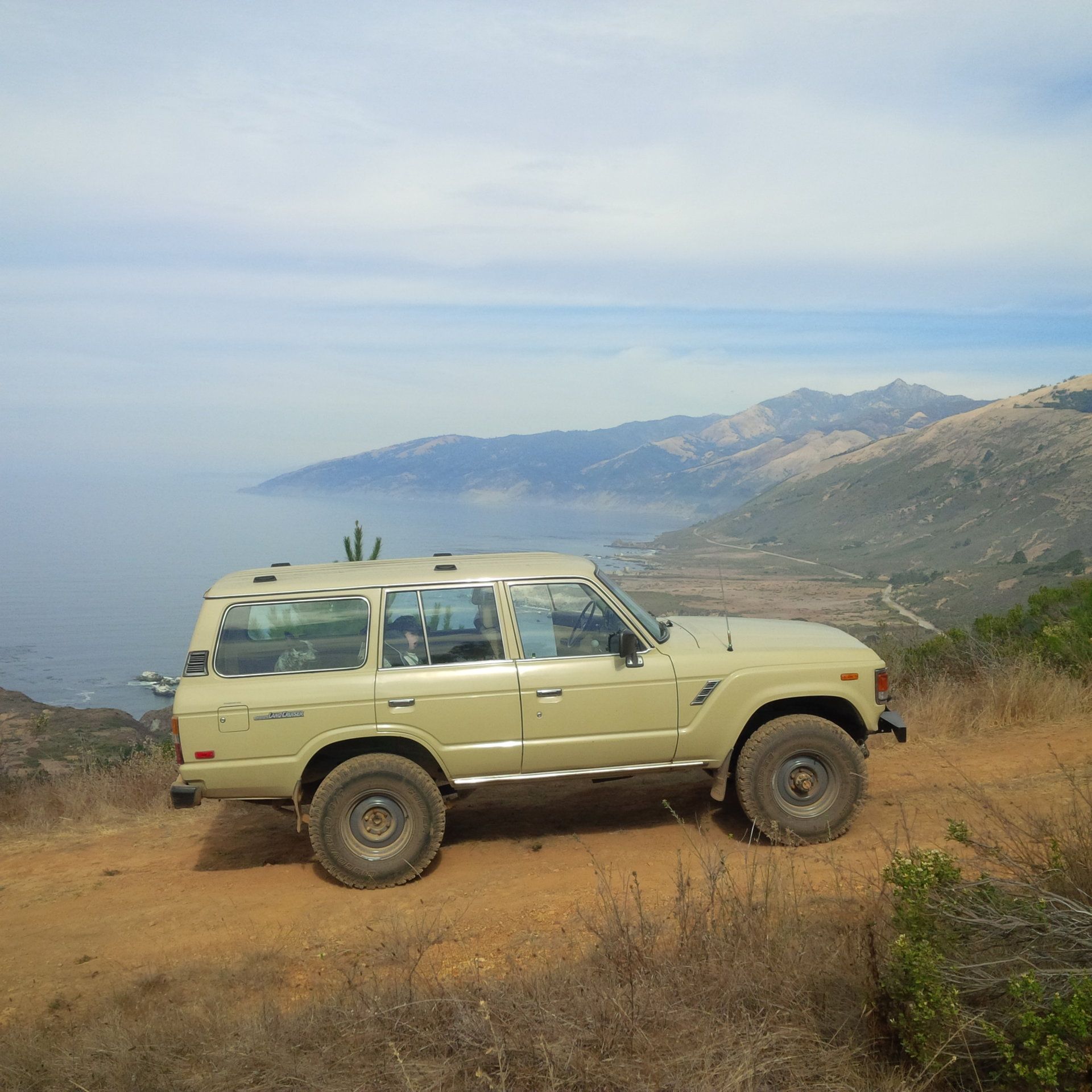

@DFXR - I think I'm following in your footsteps. I have a '03 UZJ100 and '85FJ60. Now I need to know where you took this pic. I want a pic like that! Looks like Big Sur area? Let me know which trail.

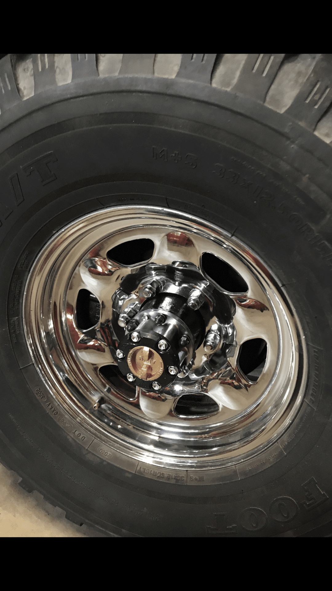

I'm sure this is a dumb question... But how can you tell if your wheels are stock? They look like it but they have 33x12.5 on it now. Is that possible that they are stock? I don't mind how it drives with 33s(under powered) but the old mud tires that po installed are terrible in the snow. I need to get a good all terrain and debating the size.
