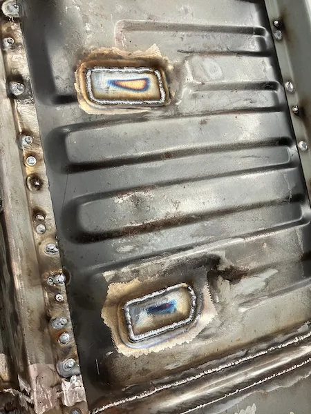

Two of the four seat 'pads' showed some pitting .. so I used some 16 gauge to replace those .. again, underside won't get any grinding or very little .. inside the cabin a little more ..

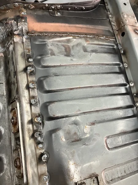

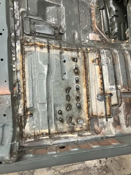

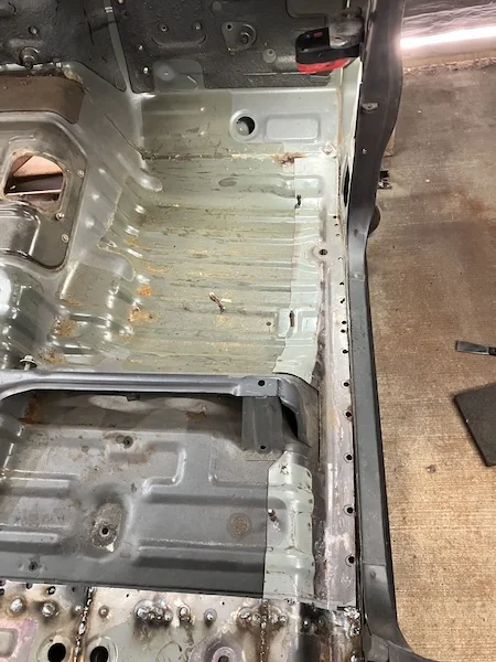

Then it was on to the passenger side floor pan .. marks a bit of a milestone for me as I started in the driverside floor pan almost 3 years ago .. although the project requires years more of work and ($) it feels good to come full circle .. little wins, right gents?
