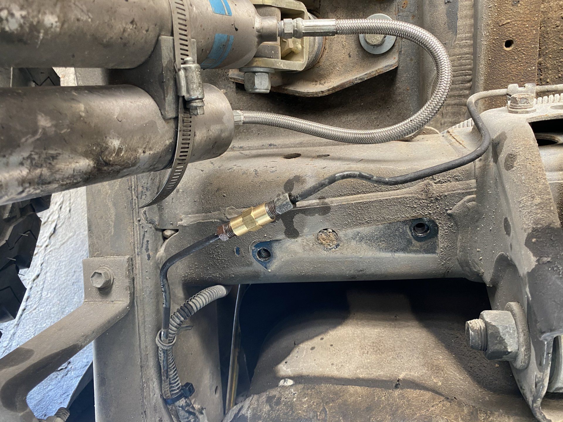

A few years ago, I removed my LSPV, installed a union, and removed the sense line. Instant braking improvement.

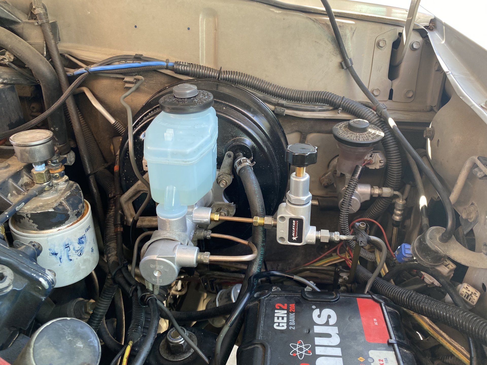

In Nov, I committed to removing the ABS pump completely and installing a manual proportioning valve. The valve was $40 and the brake line straightener was $40. Factory lines were reused to connect the proportioning valve. Afterwards, braking is consistent and strong. However before I adjusted the proportioning valve, the rear would lock up first and the truck would start rotating. I marked the top of the proportioning valve with paint and rotated the dial two full turns for less rear brake. Braking is better but I haven't had a chance to test emergency stopping again.

I'll be doing more work today on my brakes. A bit of history. I originally just removed the ABS module and put a T in and brakes were still okay with the ABS MC. Much later I replaced booster and installed proper 80 series MC for non ABS w/ disc brakes. Pedal felt awful after a solid bleed. Today I will be deleting the LSPV and installing proportioning valve. I got the Allstar 48025 manual valve that comes with 1/8 NPT fittings. I found some 1/8 NPT/10mm inverted flare adapters (EAR-02102ERL) from Summit so I wouldn't need to have mismatched lines. Also trying out a T100 non ABS MC.
Let you know how it goes when I get it sorted later today, hopefully.

Having said that when I got everything back together just now I left the valve set all the way to “less brake” and went for a drive around the hood. It felt awful and I adjusted it a few time on my way back home. I have it probably half way clockwise “more brake” now and it feels good. Still need to find some dirt as my gravel driveway is not long enough get up to speed. My neighbor was looking at me funny as I was attempting it. Damn dump truck tranny!
Valve and 10mm inverted flare adapters.
still need to make a bracket for valve.
Simple union to bypass LSPV
Pulled sense line and few other lines to get rid of the T I was using after deleting ABS

There is a lot of adjustment in the proportioning valve. I painted the wilwood "w" with finger nail polish and as indicator and rotated the knob to full open. This was not good. I've turned it two rotations from full to decrease braking to the rear but haven't been able to test it again.
If the rear locks before the front, I will turn it two more times and continue this until I get the front to break lose first.
