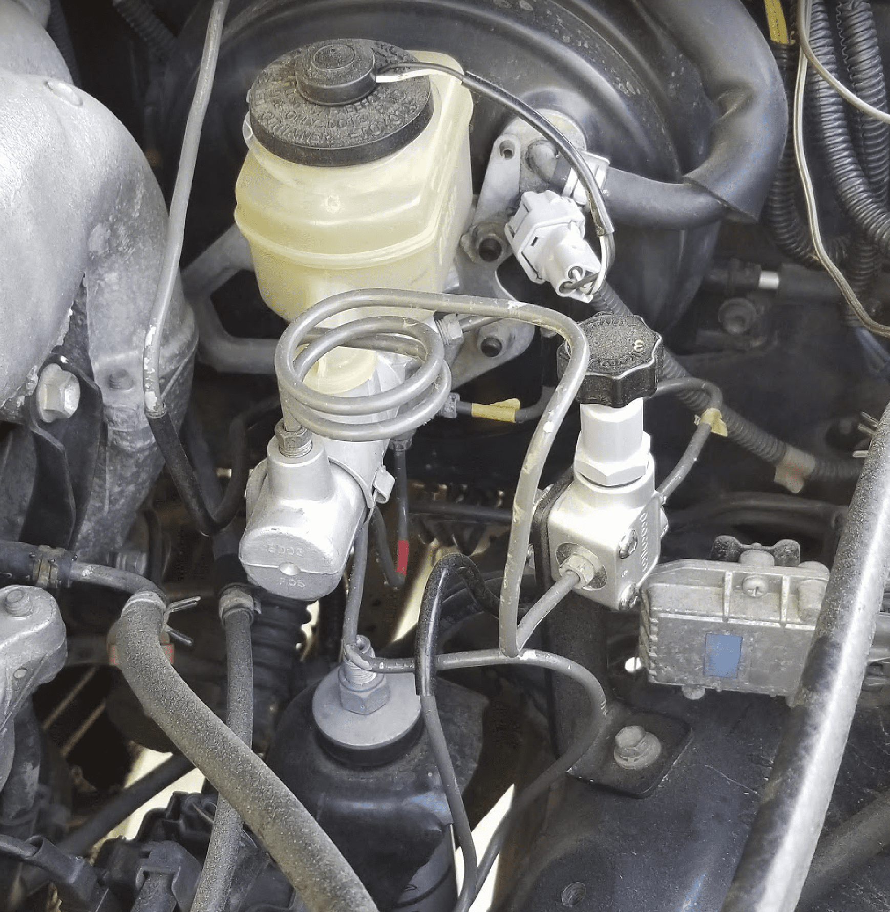

Maybe this will help (maybe not). It is incredibly difficult to photograph three dimensional brake lines. I took these photos for another friend @fourtrax so he could do his own ABS/LSPV delete. Routing the lines is done differently for each person.
I reused the T underneath.
Front passenger line drops straight to the T on the engine side of MC.
Front driver line is bent and routed directly underneath MC to the T (red tape)
Rear line goes up then down to proportioning valve and from valve to the front of the truck. A union then sends it to the rear of the truck.
I didn't cut any lines but I did carefully push and pull lines into place. I purchased a cheap brake line straighener off Amazon. It's better than hands but not a professional tool.
Red is front
Green is rear
