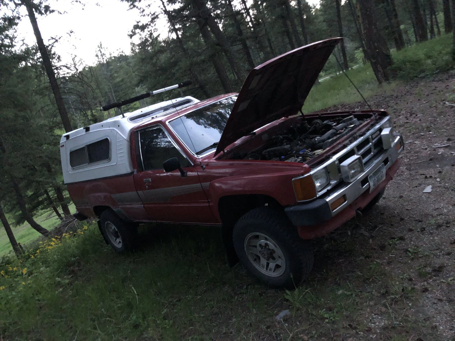

Whelp. This happened.
Turns out this couple has owned it since ‘88. Got a factory service manual with it too, which I much prefer over scrolling through a digital version.
I stand by my recommendation to buy this truck and restore and build it. Note: Do not scroll back to earlier posts.
Seriously though - that looks like a solid (!) truck from what's visible in the pics.

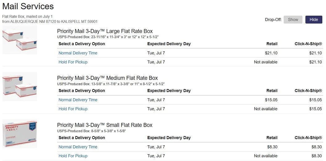

I have an OEM bottle jack. No idea what these are worth.
  • Like
Reactions: Zor
I don't know what they're worth either. How far from NW Montana are you? It might be pretty pricey to ship it.

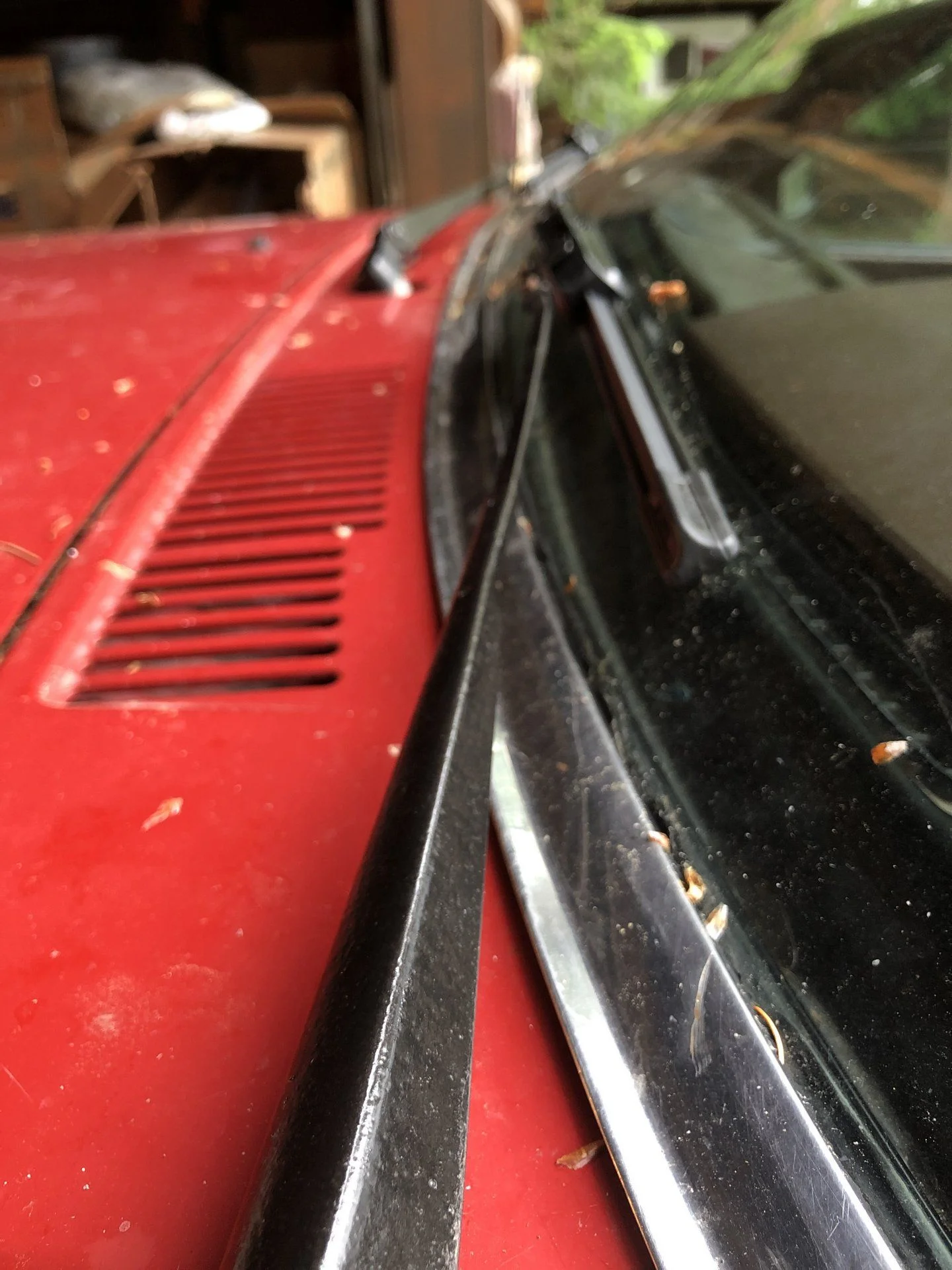

Wiper arms got painted with Rustoleum hammertone. Better than bare/rust, far from great...

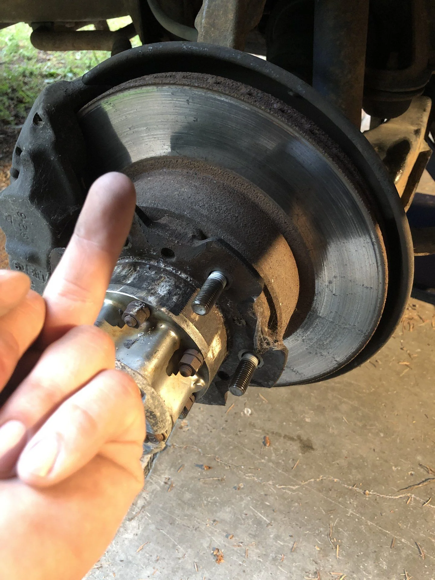

And has anyone else had issues with factory aluminum wheels getting emotionally (chemically) attached to the hubs? I had to do some whopping and whooping with a dead blow the get em off. The good news is the rotors aren't horrible and the pads have lots of meat left. Note the crusty white residue where the dis-similar metals got busy with the help of the crappy ice-melt the county uses up here.
I have had a few issues getting my alloys off also. probably the salt, or I just let them sit on there too long. Procedure for pulling diff will work. Drain fluid first. I pulled the rear diff from a '94. It had 4:30 gears. I think 4:56 were available as well. You might be able to check with the VIN on Toyota DIY, or look at the paint colour on the pin flange, if there is any left. I sold the 4:30 diff because I'm trying to put an e-locker in instead.
