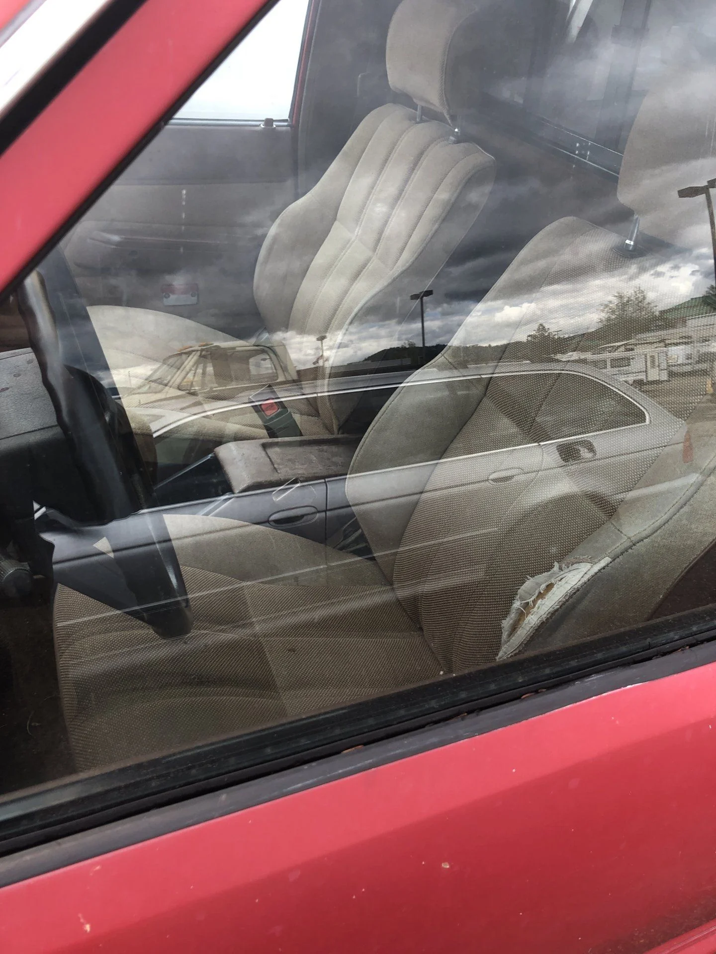

Looking at the truck now, waiting on the owner to show up. 22re, has factory looking sunroof, a/c switch on the dash, clock, no vent wings, buckets, Aisin front hubs, tired rear suspension and stock bumpers.
Cab floor, rockers, pinch weld and body mounts are solid. Frame looks Pretty good at the tire carrier. Lots of oil around the passenger side cv by the flange on the differential side of the cv. Looks to be a fairly stock truck with saggy rear suspension.

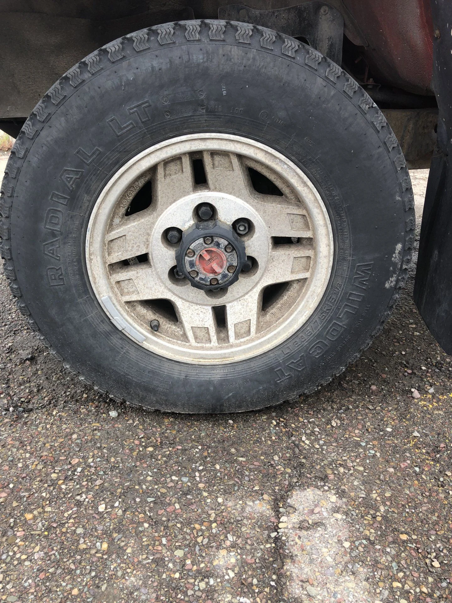

-Tires have about a season left.

Truck probably has 235/75/15s on it, you can get a set of 4 decent(kuhmo road venture, falkens) tires new from amazon for like $400 in that size.

Just to add that tire looks like over ten years old it might look ok until you hit the open road. I wouldn't drive that past 40 mph.

Tires are sketchy at best, but I just need to collect fire wood close-ish to home. They’ll get replaced in due time. If I lose a tire, or engine for that matter, and worse comes to worse, I hitch hike outta the forest, and come back with a trailer behind my landcruiser. I have a winch and all the recovery crap so I can get that lil truck outta anywhere I get it stuck.
