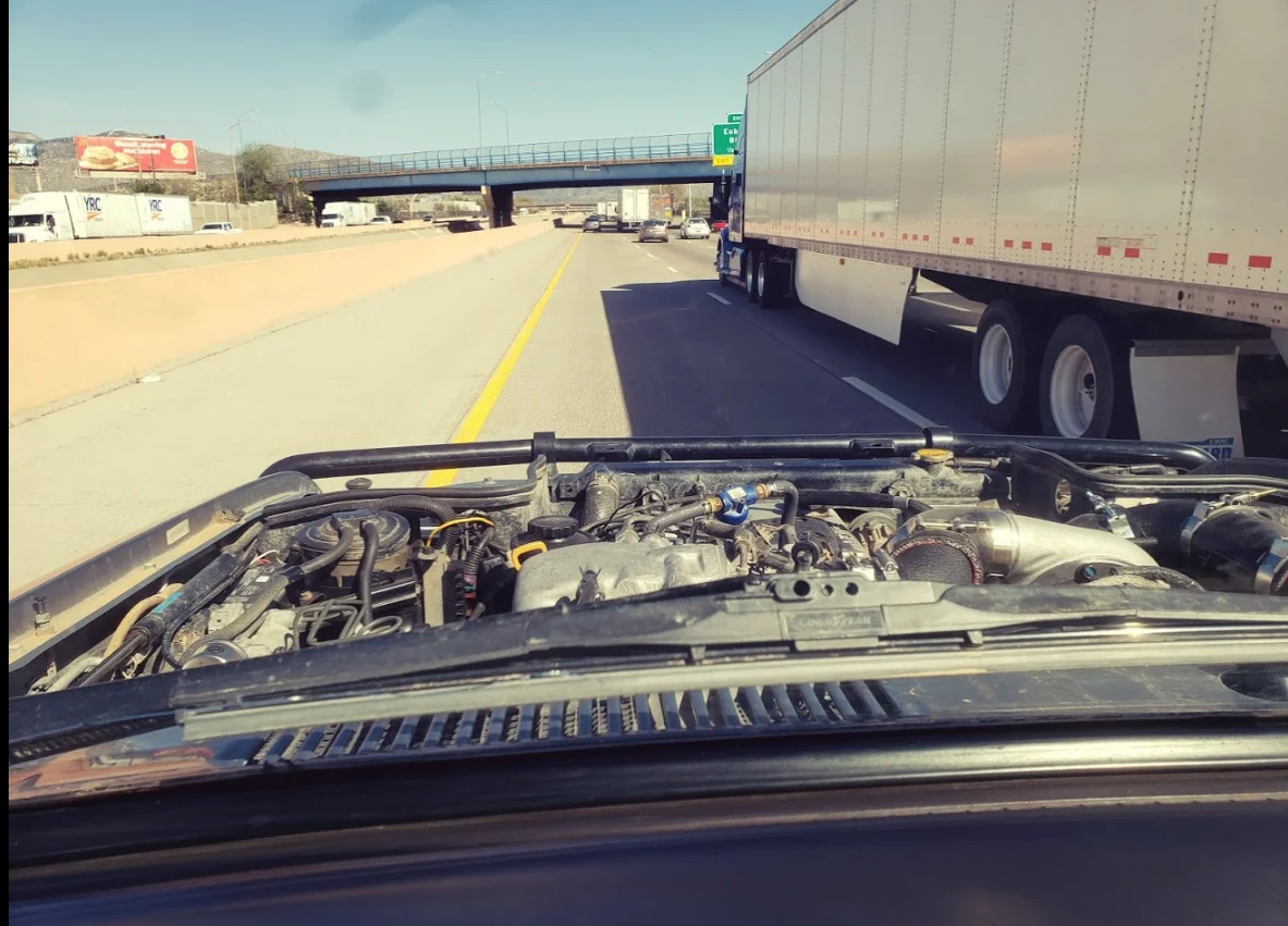

or do what I did, drive down to the exhaust shop with a missing hood and open pipes. It's quite exhilarating I tell you what! :hillbilly:

@alia176 - Did you take the hood off just in case exhaust heat was being trapped in the engine bay since downpipe is short?

How long is your drive to exhaust shop?
I can’t imagine a 10-20 mile drive with the Downpipe dumping straight out would be detrimental as long as the hot exhaust gas is not pointed at anything important.
If anything you’ll be amazed at how quickly the turbo spools up without any back pressure 🤣
I’m going to look for some flex pipe as a temp solution for the drive.
oh COME ON, open pipes all the way to ABQ exhaust shop from Durango :hillbilly:
