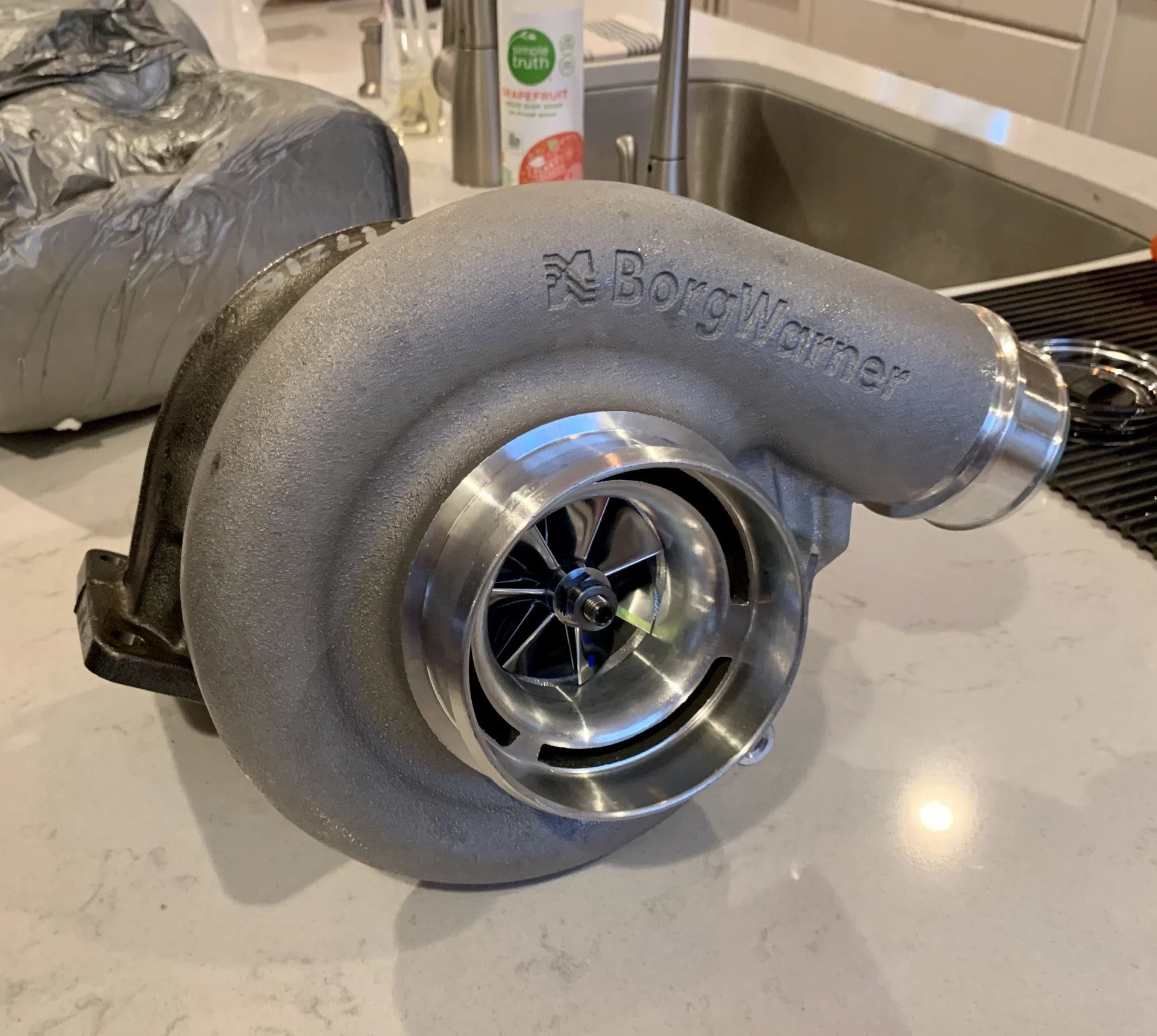

I am running boost, AFR, coolant temp, oil temp, oil pressure, fuel pressure, voltage, and intake air temp after the turbo. I wish it could do trans temp.
With all the sensors the 14in1 provides, I think most people with this build are only running 3-4. Boost, water, oil, and AFR. @jjdeneen918 is running one or two more I believe.
I am not running the 14-1, i have a set of innovate guages, but I have Boost, AFR, Oil Pressure, Oil temp, Coolant Temp and voltage.
Pix or it didn't happen 😋
Just kidding. . Congrats 👏
more over on my ig @_haulin_auss :grinpimp:
Ahhhh, you are killing me! When did you order?
5/19 - It worked out perfect, I was starting a full overhaul of the truck at the time and just now feel like I’ve got all the little post-op gremlins worked out.
So, naturally, now that the truck is running flawlessly and cool, it’s time for me to throw a giant, heat-producing turbo into the mix :grinpimp:
