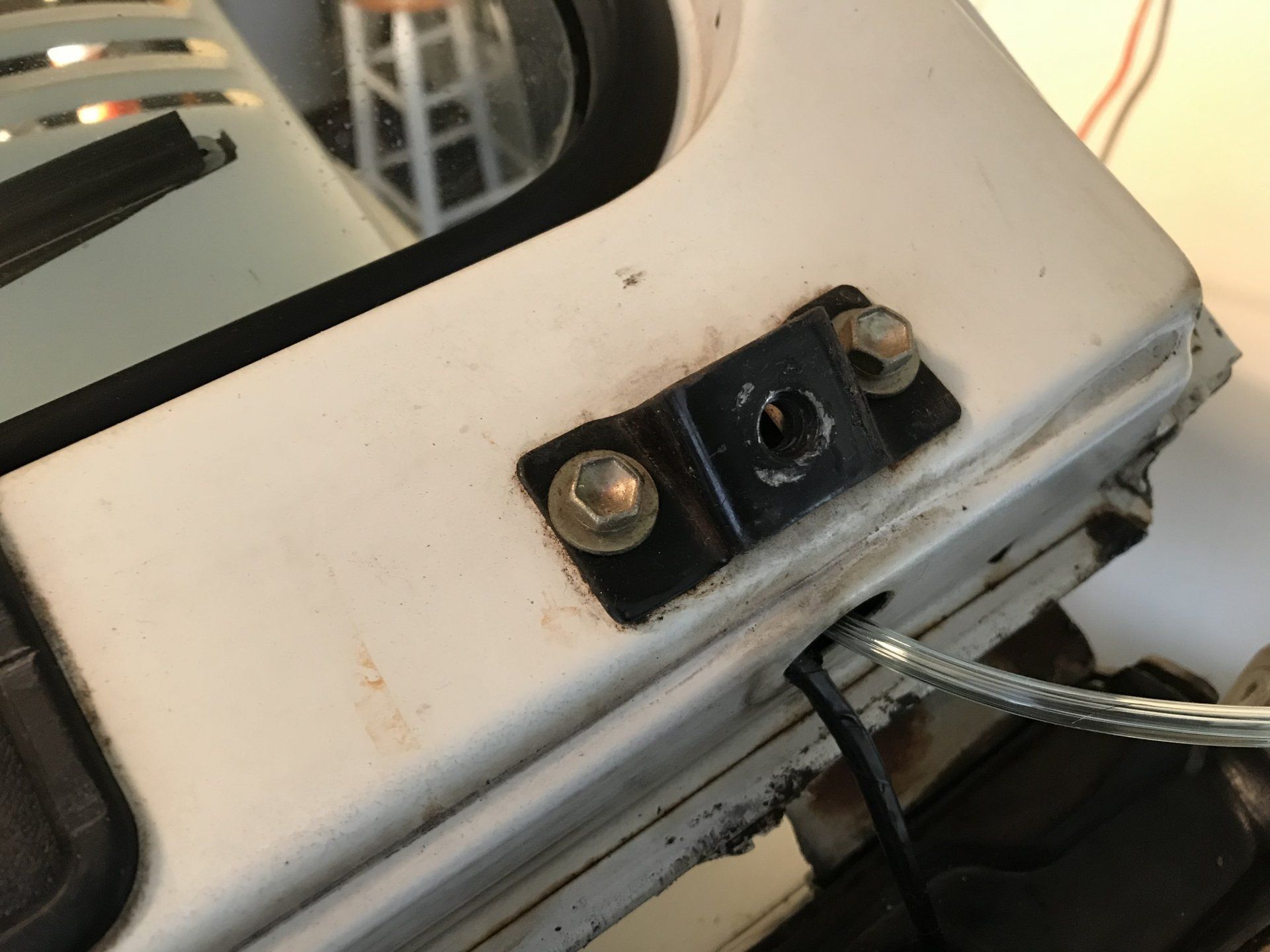

@SteveH I have this connected to the pump, but still have the original one above the windshield painted over

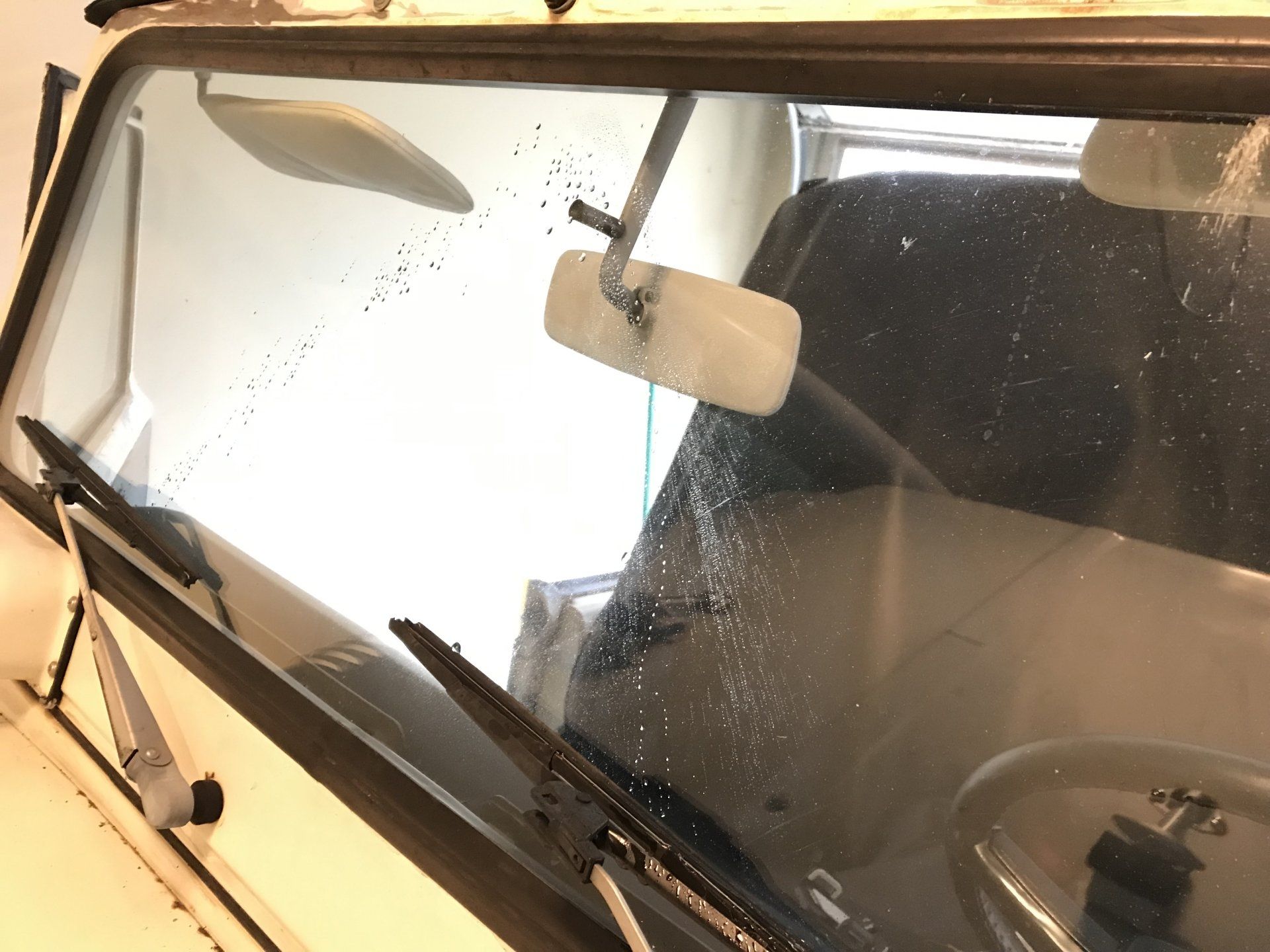

Amazon sells this Clear washer hose. Worked fine to replace the original I was thinking of trying to Y the hose and include the original top of windshield washer - curious if anyone has made the "blow a string" trick work to fish the tubing.

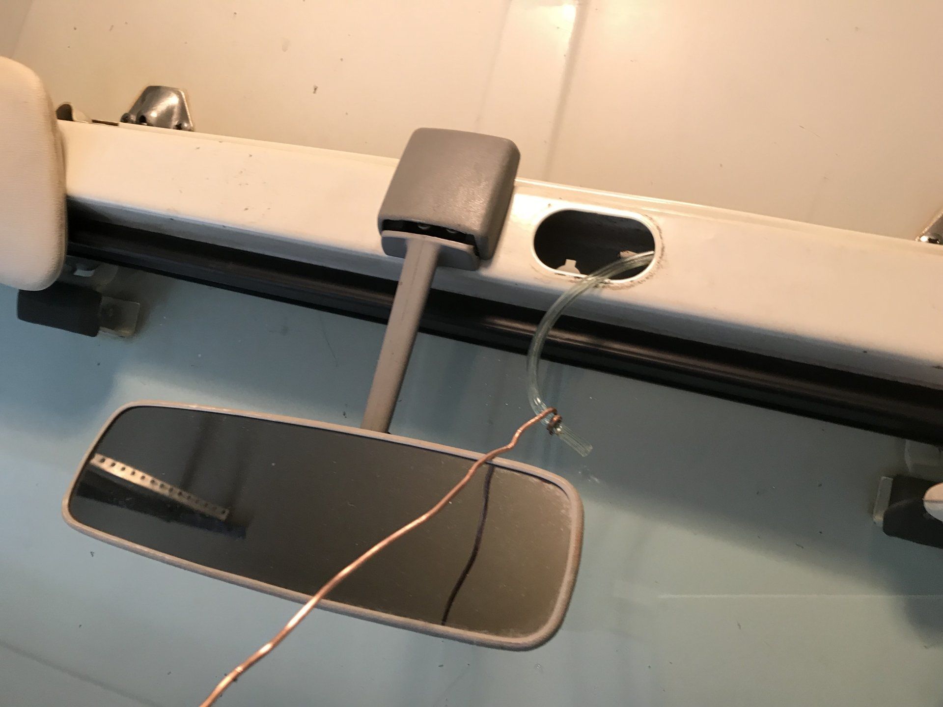

Damn..... there’s always smarter/easier ways to do stuff than what I come up with! I fished some copper wire down ..... took some fancy cussin but I finally pushed it through!
Just blow the string through with an air gun (preferably a non-OSHA type, as they have higher flow), starting from the hole above the center of the windshield and blowing to the passenger side. Feed the string as required and it will exit just outboard of the glove box under the dash. Tape/tie the tubing well to the string and pull the tubing up towards and out the windshield center hole. You may have to guide the string as it initially enters the hole under the dash, just to avoid wrapping around the wires there. If it gets tangled around something in the windshield and won't pull through, just pull the string back out and try it again. There's a plastic check valve above the glove box door where you can connect the new plastic line with existing plastic line.

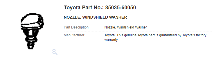

SOR has them. I don't know if they're available OEM. You can run without it, but it takes longer for water to get to the squirter.
It really was a poor design by Toyota. They should have run rubber or nylon hose all the way, or left out the check valve to prevent holding water in the metal tube. I think I started having issues with the metal tube within 10 years of buying the truck new.
194-25J
CK VALVE WASHER-
Fits 9/77-1984 40 SERIES
