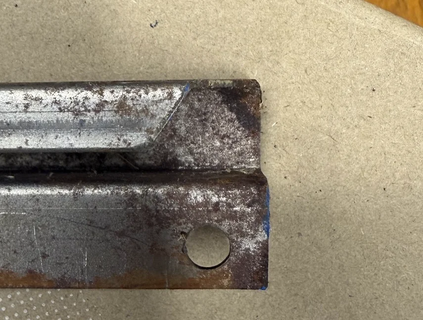

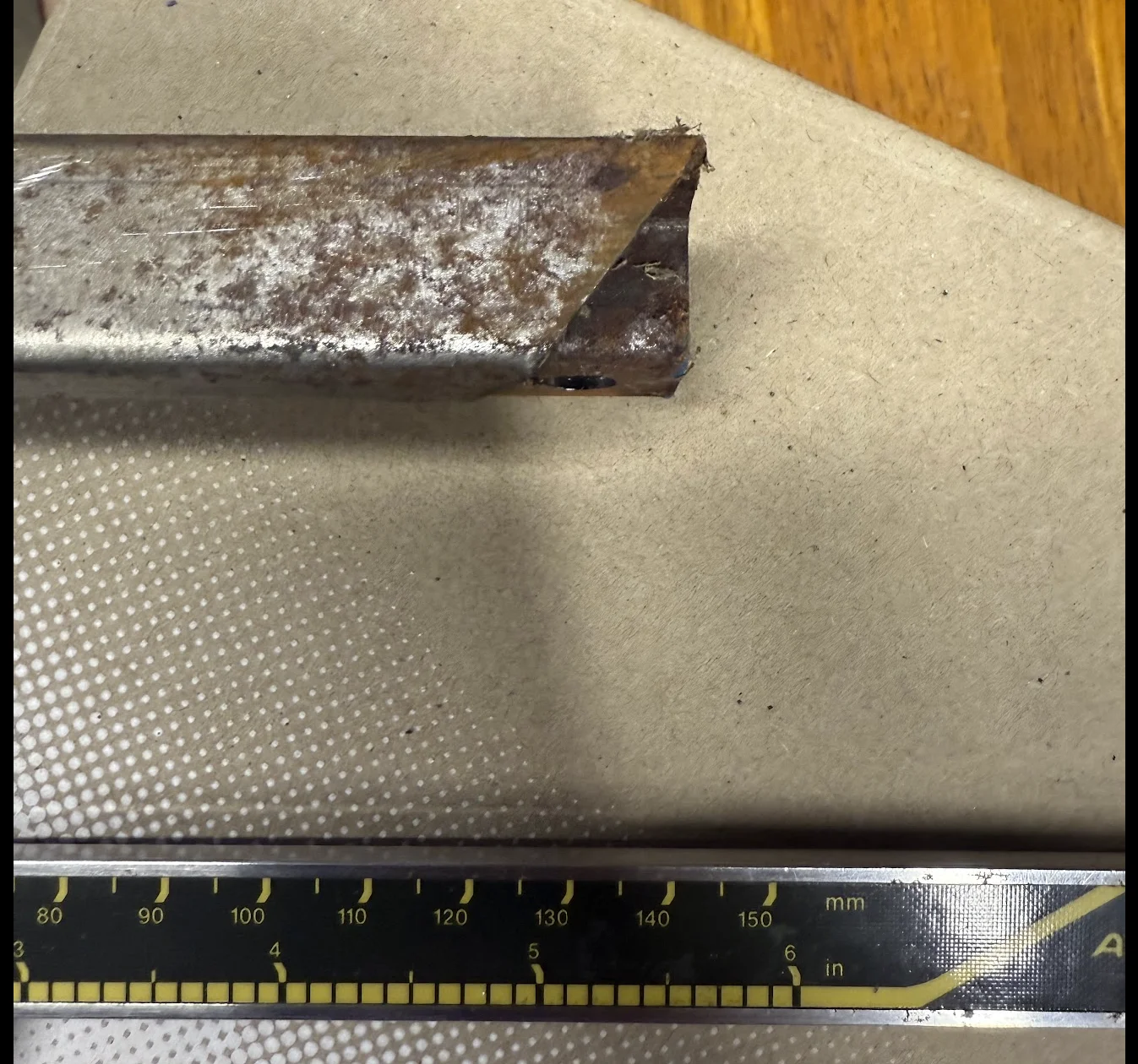

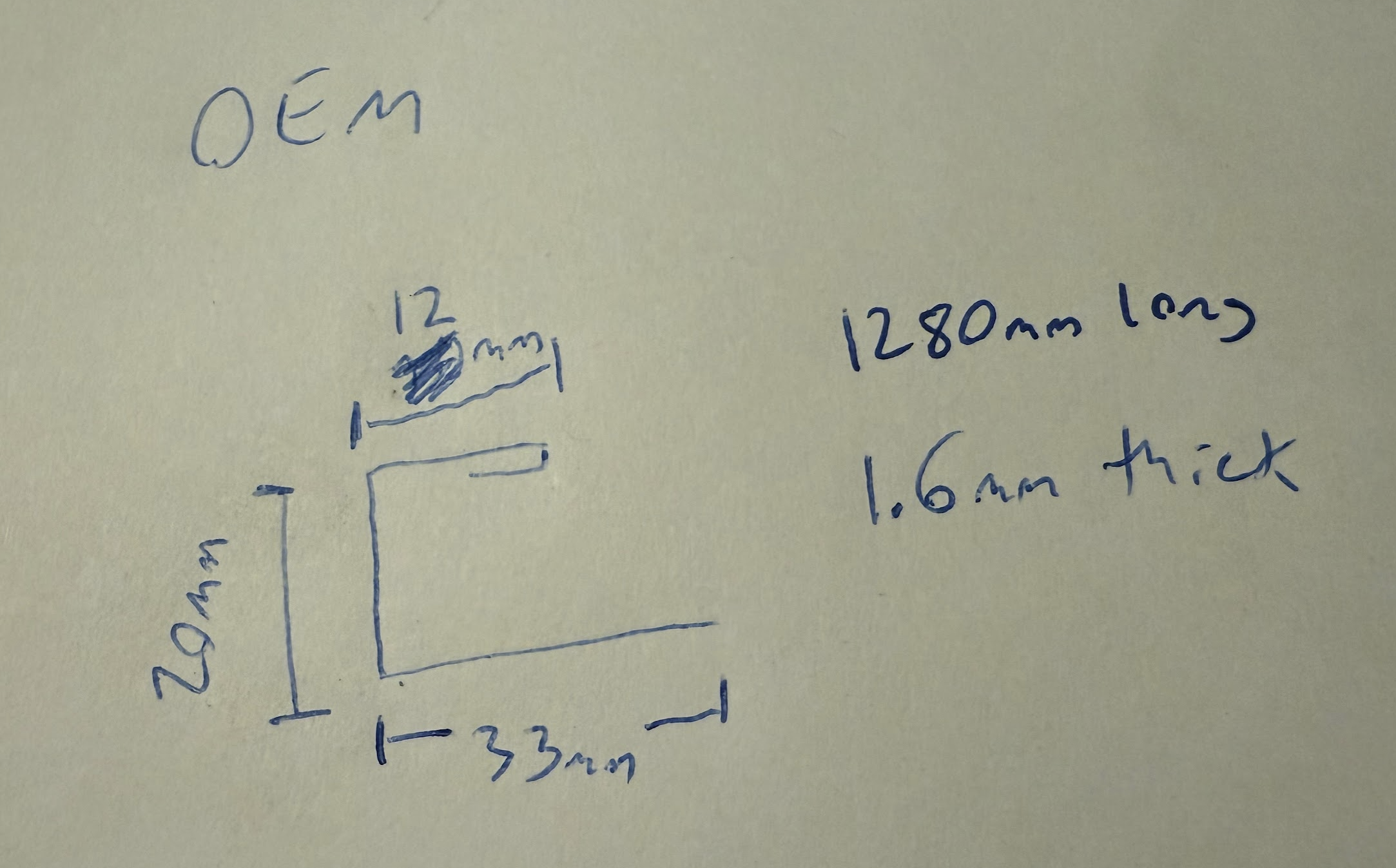

The first is OEM. My FJ40 is a 1965, I did a little research and it looks like Pre 9/67, with the dual wiper arms, this is the FST channel. It can also work on 1/75 and later due to the wiper being moved to the bottom. Credit to @Living in the Past for that tidbit of knowledge.

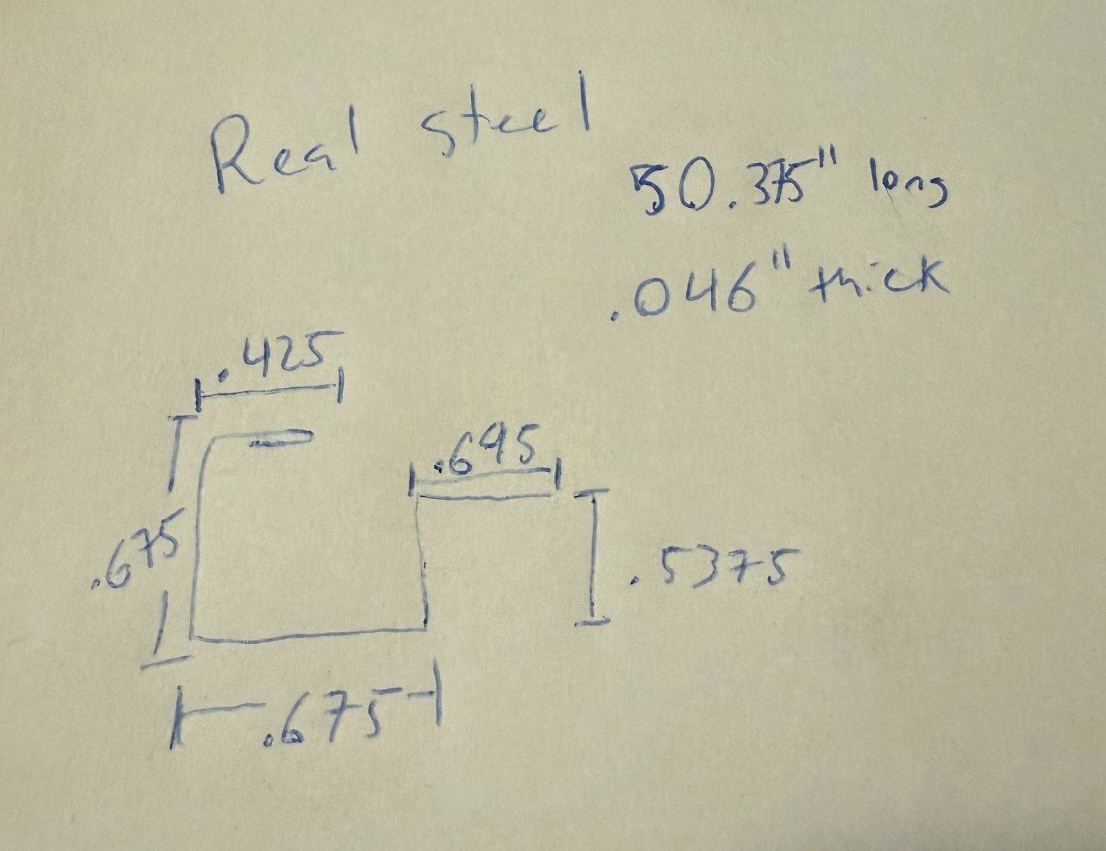

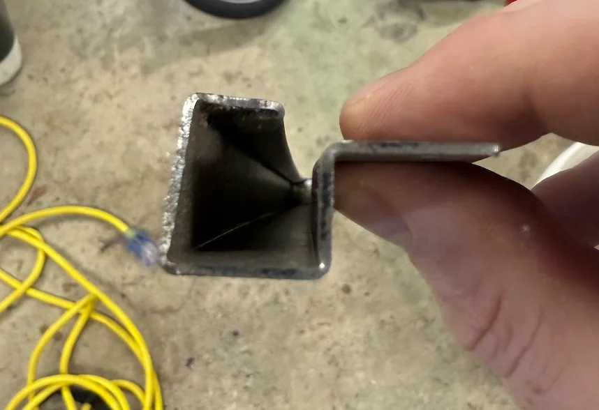

Here is the Real steel channel.
Note: all measurements taken from outside dimensions.
