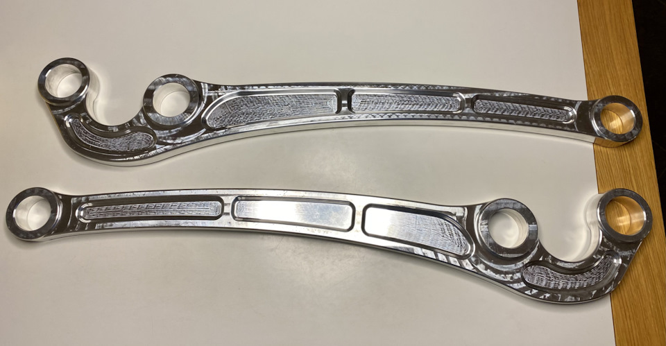

Someone made aluminum rear radius arms for a KZJ78 out of 7075. I suppose the fronts could be done in a similar manner.
Great photos in this link:
Here's a video:

7075 is not lower strength than mild steel so it would be fine to make the bosses surrounding the bushings same as stock. I would want to keep the section of the beam pretty thick, like the Slee arms. In my mind's theory of what happens to the front radius arms in a panic stop at speed with big sticky tires the last thing I want is a floppy/wiggley mid section. I'd like wide and tall.
The design in that Russian video posted above is very close to what I had in mind. Fat radii and smooth transitions.
