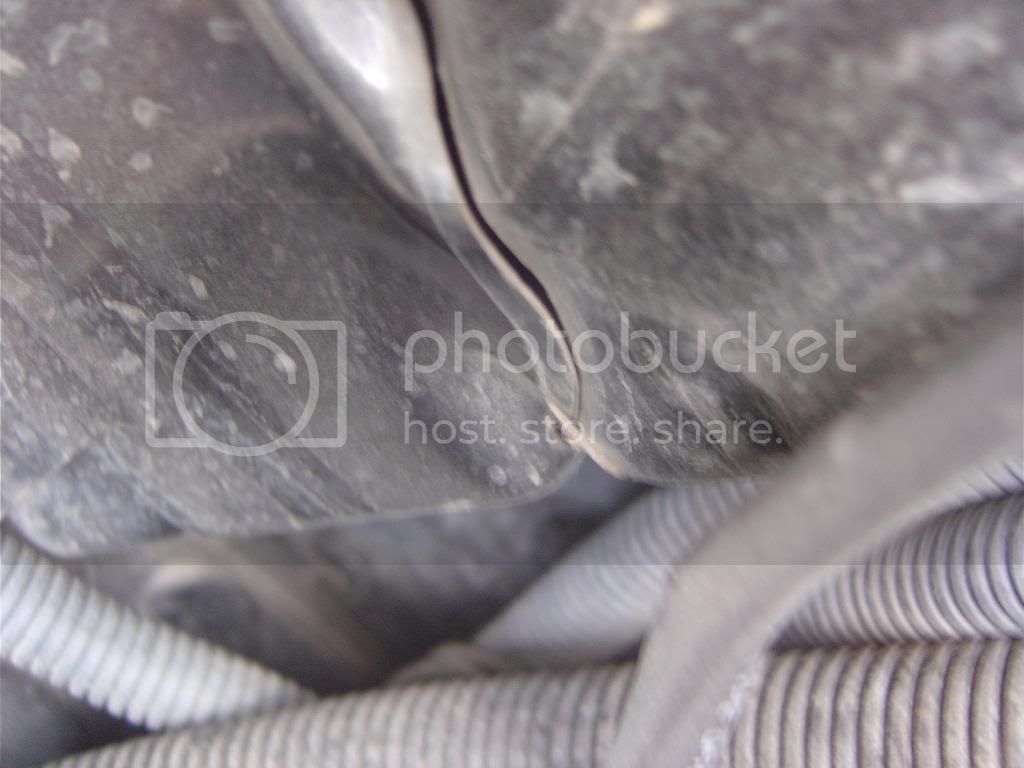

Its a known issue with the FJ. If you don't have them, you will and 2007 didn't fix the issue. Mine is a 2007 and its cracked pretty good. I don't heavy four wheel with my truck, just fishing and hunting trips on forest roads about 3 time per year.
Anyway, if you know of folks with FJ, let them know. I'd be willing to bet many folks have the problem but don't know it. A slight bulge is the beginning (barely noticeable, followed by a large bulge and cracking.)

I just left mine alone. The crack travels a few inches and then stops. If you weld it up a new one will show up near by. Drill a 1/4" hole at the end of the crack and let it be.

For those of you that have not seen these, here they are.
