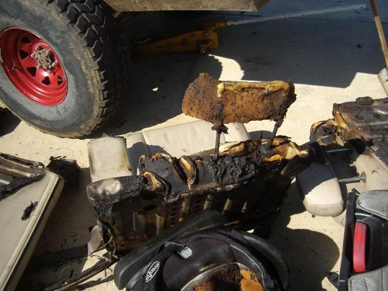

The RR seat is down to the metal. Both child seats are melted. The rear cargo panels, melted, same with rear hatch panel. 3rd row seats, toasted. Back of front head reasts - melted. rear door panels, melted to a degree. Headliner - completely burned - visors singed. PS rear window the divider thing is melted. RR window, shattered (guessing from going hot to cold w/ water). Guage cluster, smoked. GPS, smoked.

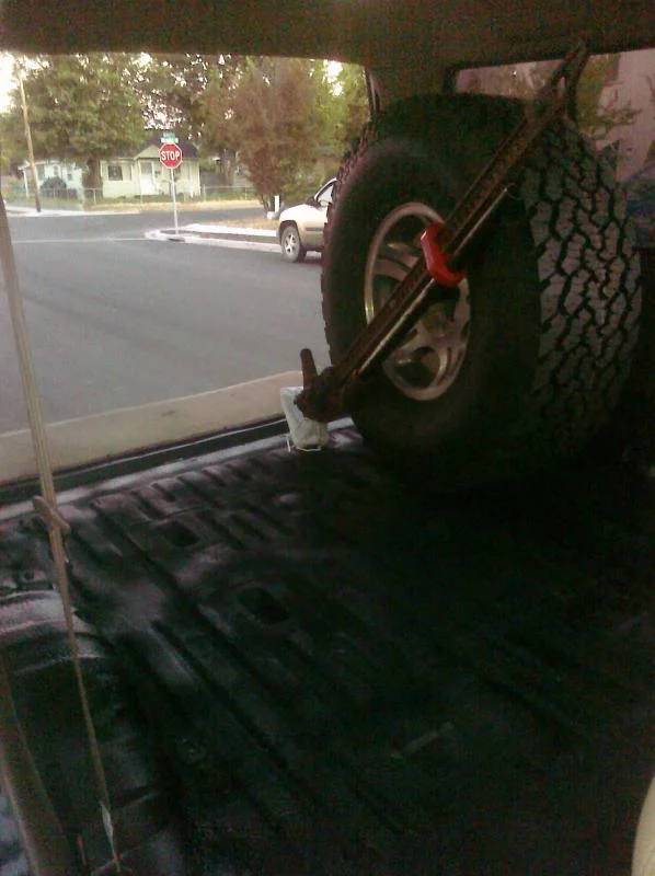

After the bed liner:
attachment.php
(No comments on the boot! It was just to keep it from digging into the still soft bedliner, and is gone now. :hillbilly: )
Wash everything down with TSP to clean it. Spray Second Skin Spectrum for sound deadening (unless you don't care how loud it is, it'll be much louder without carpet). Spray over that with the bed liner of your choice (I used Duplicolor, only took 2 rattle cans to do up to where the second row sits).
A day or two worth of work, depending on how fast you move and how pretty you make it. New panels from a parted out truck to complete the look. Heck, if you did that I bet it'd cover 90%+ of the damage. Some new seats and you'd be good to go....
