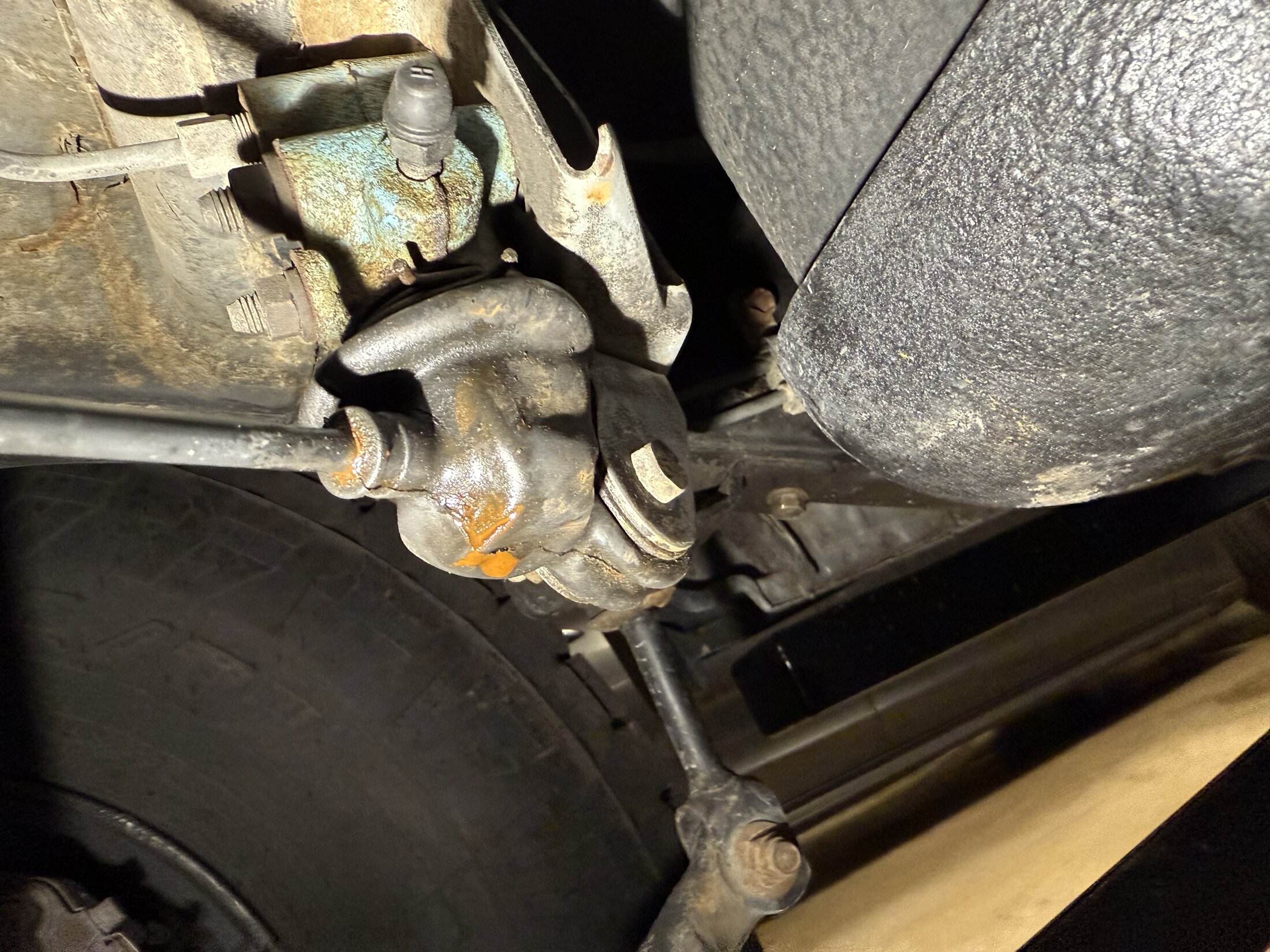

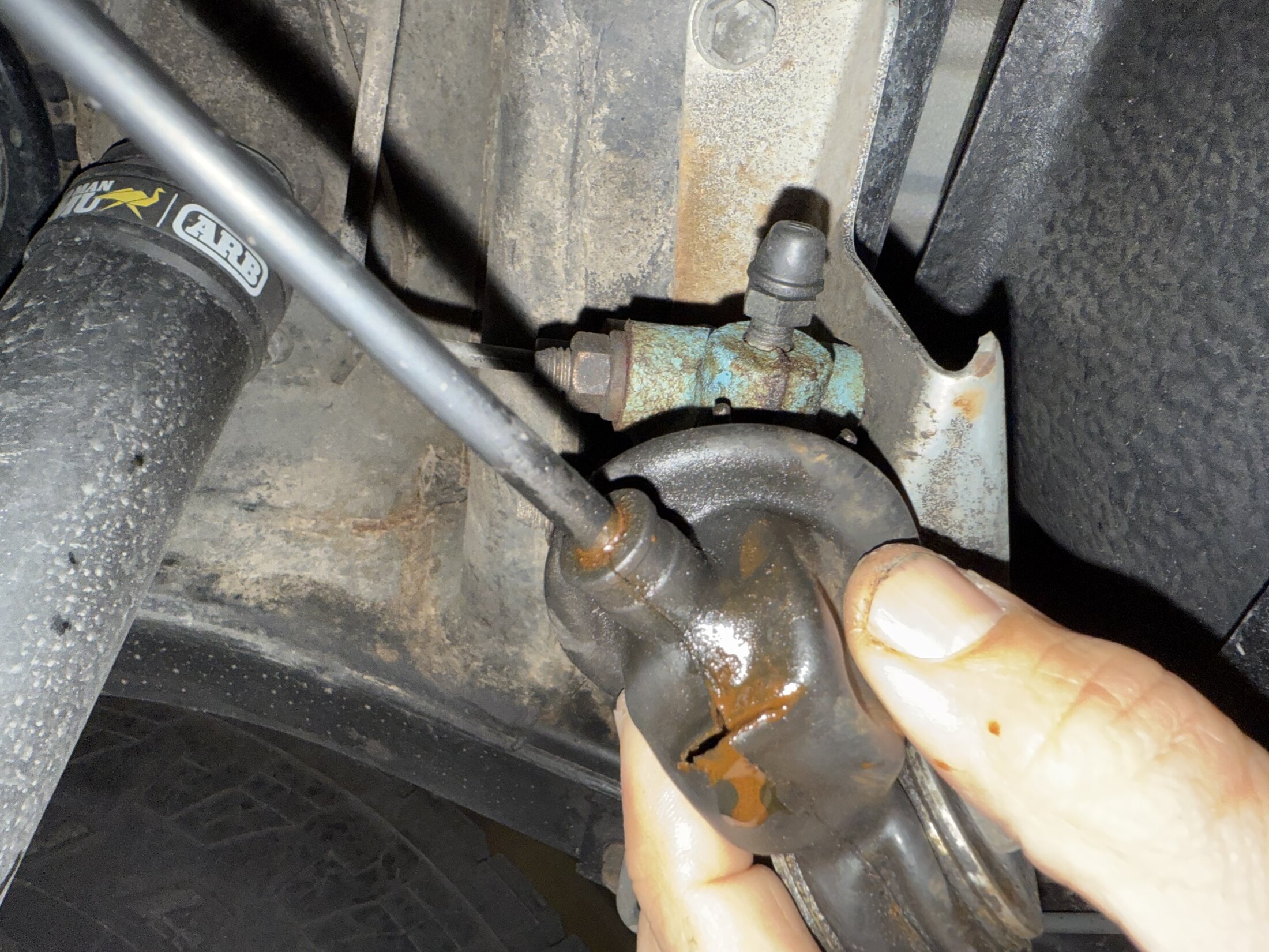

I think this is part of the hand brake, but I can’t find this rubber boot on any diagrams on PartSouq. Mine is split and was full of rusty, muddy water. I want to replace it once I figure out what it is. I know it’s not a dikfer, turn-signal fluid reservoir or left handed windshield retainer.
Load sensing proportioning valve. It adjusts braking bias based on load in your truck
That is the LSPV.
Load Sending Proportioning Valve.
That was probably not water that came out, but brake fluid
Has your brake fluid reservoir been losing fluid?
I believe you can get a new boot with a rod kit. However, if it is leaking fluid it needs to be replaced. I replaced mine about a year ago and it fixed some of my braking issues.
Many folks here will say to bypass it and install your own Proportioning Valve.
I like to keepy truck original with systems so I keep mine.
You decide what you want.
