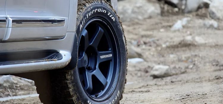

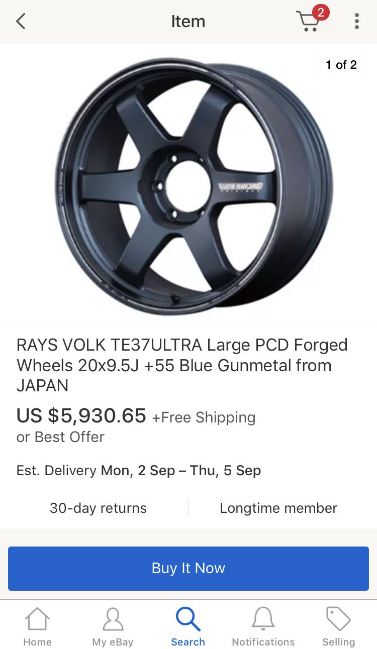

I’d go for these for a 200 series or my LX470,
But at $6k just for the 4-piece wheel set, it’s tough and may cause sudden death on the wallet.
Why are these worth $1500 each?
Serious question. What’s the draw?
I like it, alot. For a “stock looking” truck like what I have that is a DD, I beg the same question..
EBay price.
No question, if I had the funds it would be Volk TE37s. If wheels are to basketball shoes, then the Volks are to Jordans. Volks are def race car /dedicated track car quality and strength. Japan made car and Volks is bread and butter. Cheese on pizza.
Here is some reading on how they are made. http://www.superstreetonline.com/how-to/wheels-tires/1305-how-volk-racing-te37-is-made
Second would be the Evo Corse wheels. Great style, strength, decent price.
Third - TRD wheels. BBS makes them. Can't go wrong with BBS.
