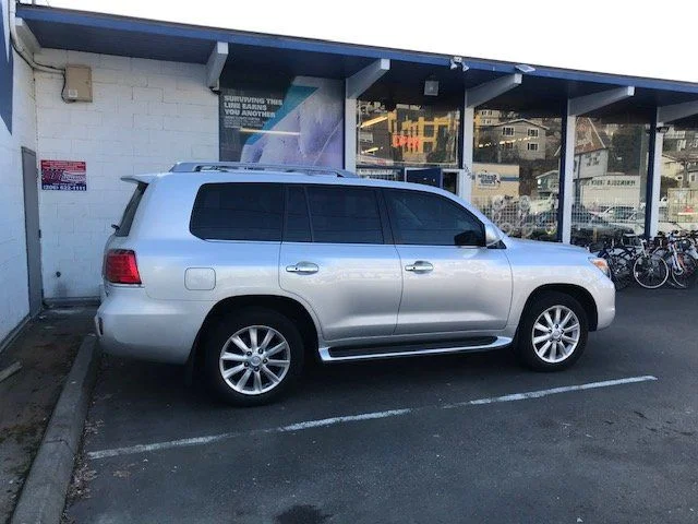

Hey Folks, This is my first truck build so I apologize in advance for the silly questions I will be asking.
1962224
My plane is the buy or build a trailer so I can take the wife and spawn out for adventures.

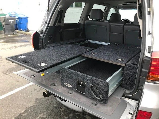

I started by adding some much needed storage to the cargo bay.

Oh, I picked up this 2010 LX570 with just under 33K on it. Can't wait to get it dirty! No cool box though, not stock in 2010 :confused:
Congrats! Looks like you're well on your way to modding already.
33k for a LX570 is just stupid good value! Nothing else can touch that kind of quality or substance. I trust that she'll deliver on the promise of a satisfying ownership.
I think you'll find over time that not having that cool box is actually a great thing. Really opens up the storage available in the front row.
Yeah I'm stoked on this rig! I feel like I found a bit of a Unicorn.
I think the storage will be nice in the log run, these trucks ar lacking in storage, but a nice cold soda or sparkling water on call would be nice at times. Yes I said sparkling water don't hold it against me.
#unicorn
That’s awesome! My 2010 had 50k when I bought it last August. I thought that was a unicorn. Welcome to the club.
Mine did come with a cool box. I wasn’t aware there were options. Maybe this and radar cruise were the only ones.

How do you like the Dobinsons drawers? I have been eyeing them for a while as the construction seems nearly identical to the ARBs at a decent savings.

I like them! And Dobinson was really nice and easy to work with.
I need to fiddle a little with the fitment. The side compartment doors are a bit tight. I just haven't taken the time. It was a pretty straightforward install. Took a few hours so plan on that. I had to drill 4 new holes to get one of the mounting brackets in the right spot, seems to be the norm as it is in the instructions. They send you a bunch of thick washers to level the box with the floor. I used all of them and then some. So if you don't have some or live near a hardware store get them before you start. Get a 90 deg drill or adapter. Also they weigh 250lbs so have a friend to help you get them in.
I was looking at the ARB too but it was hard to figure out the cost. I like that Dobinson has kits ready to go.

Strait through the Dobinson website. Mike @ Dobinson is super cool and helpful. Have you romoved the 3rd row yet?
