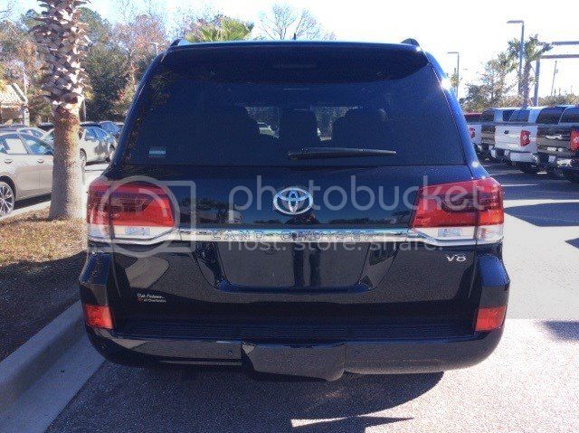

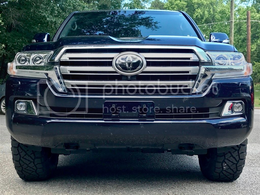

Sorry for dragging I know a good many mudders have asked for pics of the Blue Onyx Pearl, several have asked about the Ridge Grapplers and several have asked about the EvoCorse DakarZero wheels.

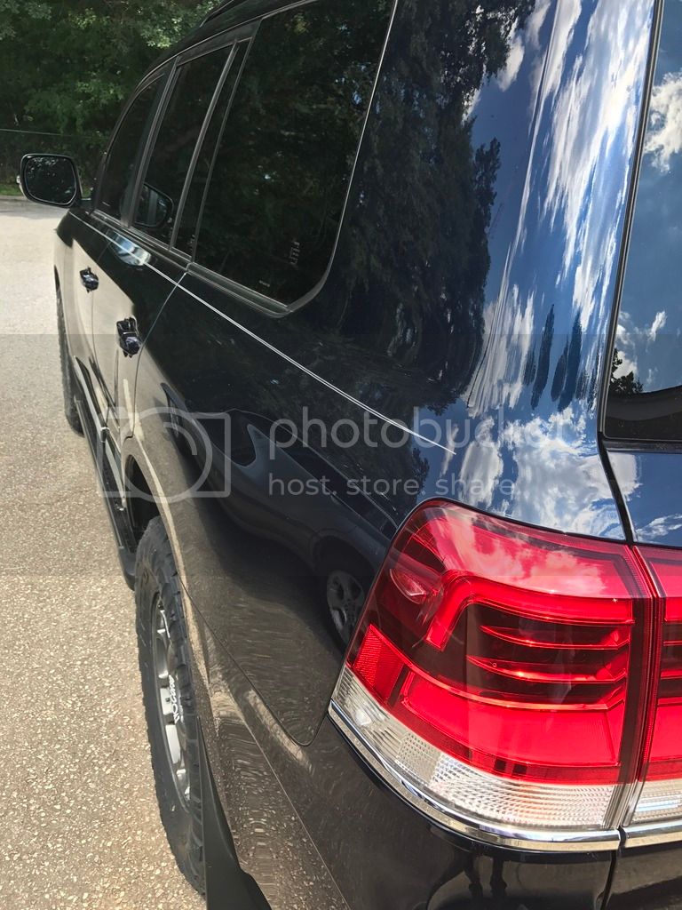

To start here's a few pics of delivery day of the 2016: As most of you know the blue is awesome looking but extremely hard to capture in photographs.

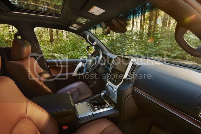

That last one is a stock photo of the interior. Didn't have any pics worth a rip of it!

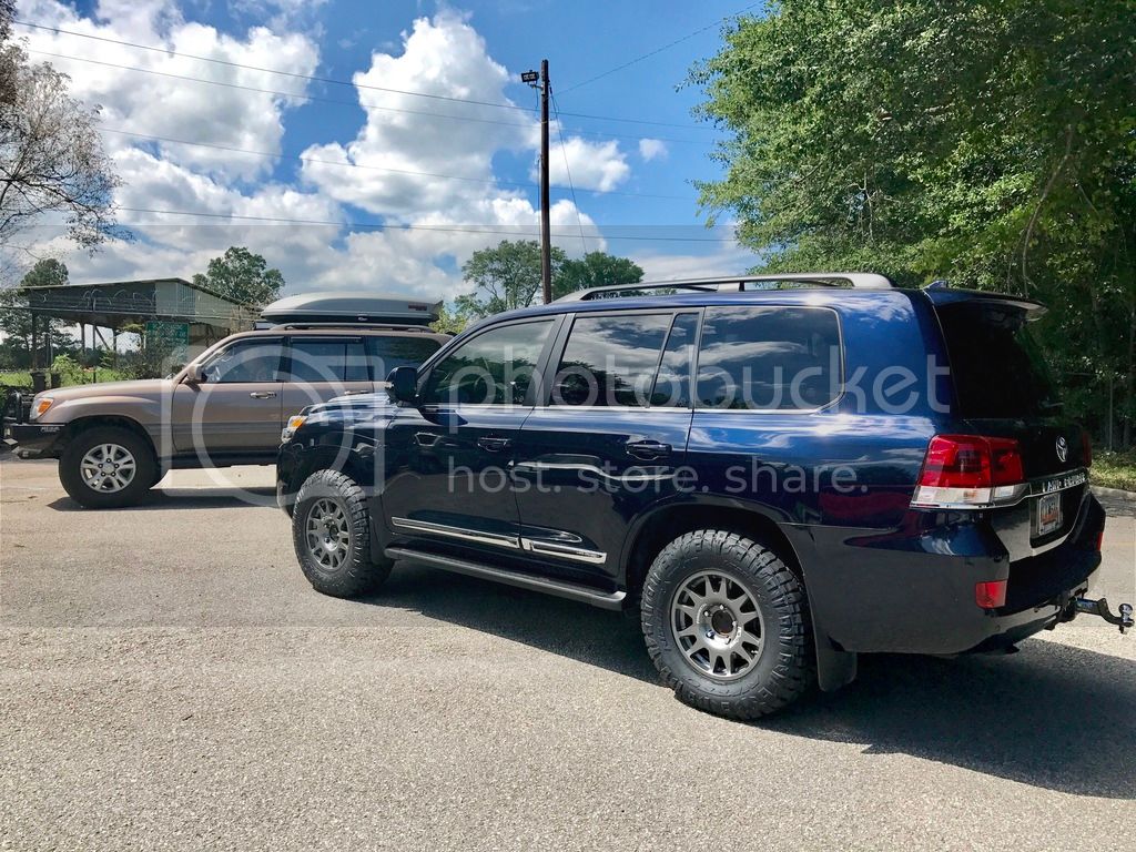

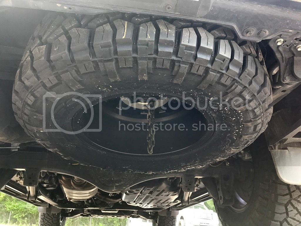

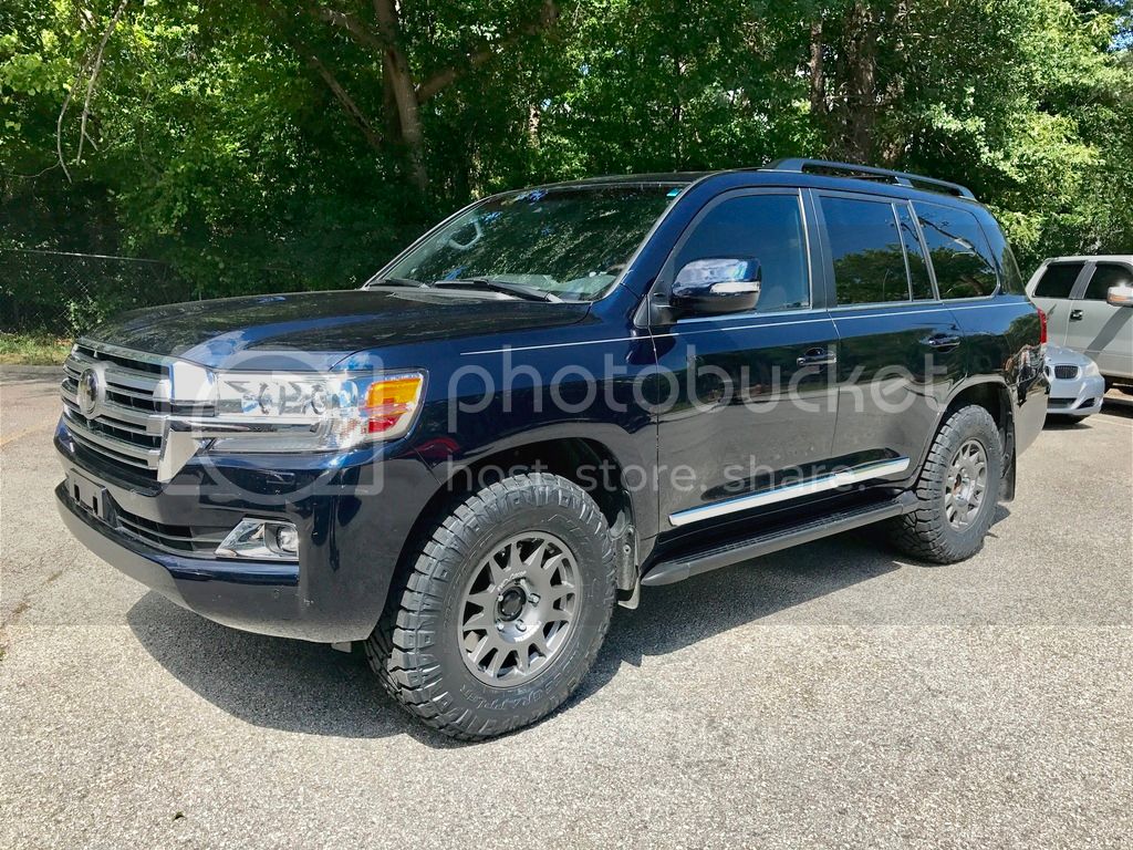

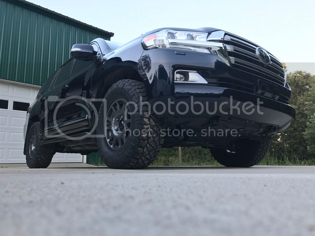

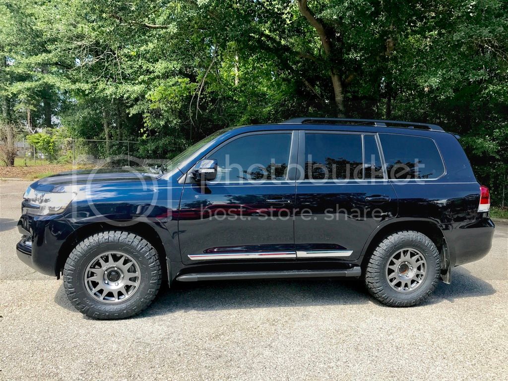

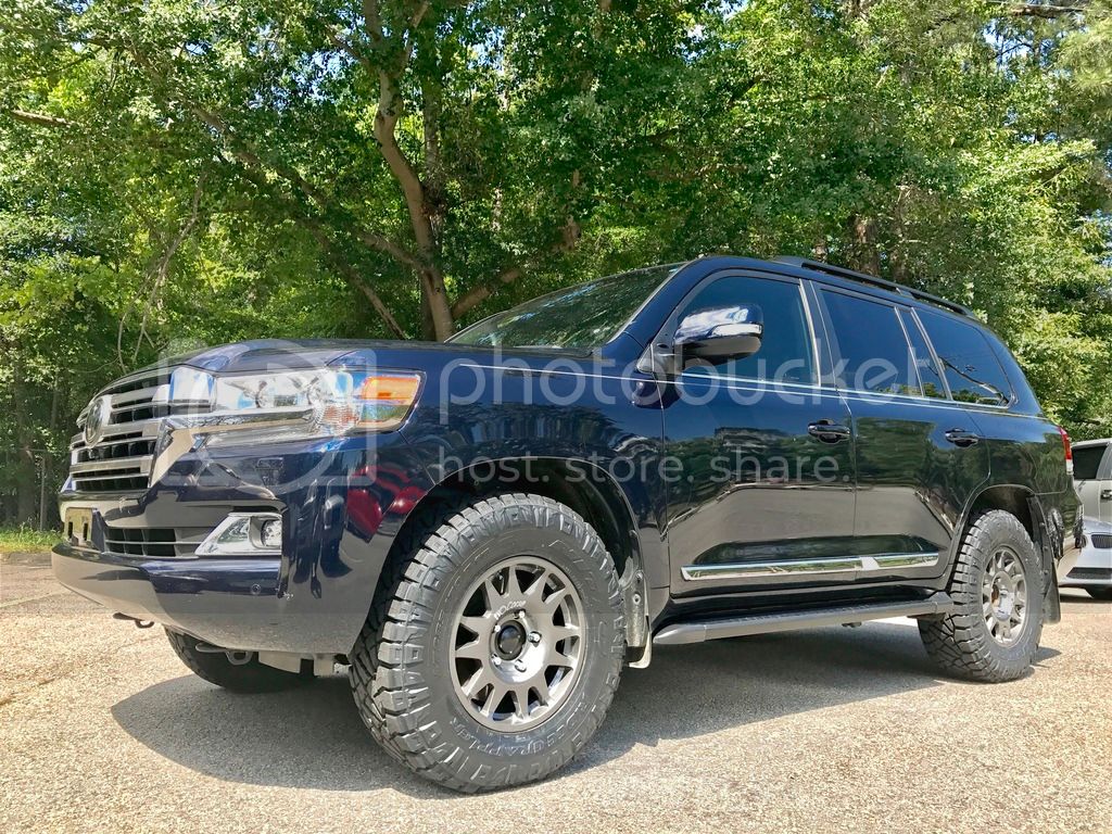

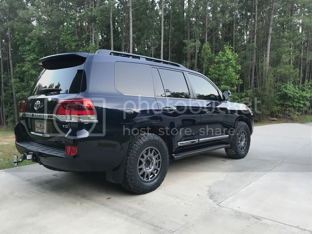

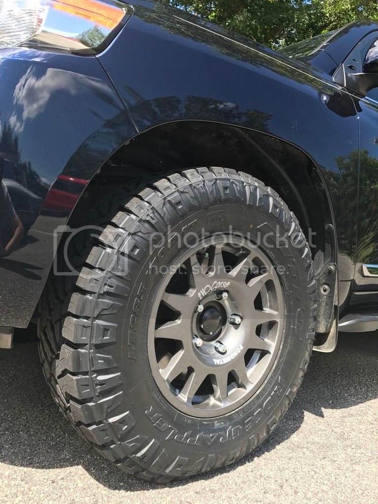

Saw a post on ExPo from Main Line Overland about the Evo Corse DakarZero wheels that they were bringing into country. I was planning to replace the 20" OEM wheels on the white LX570 with these but the LX refused to cooperate suddenly with immobilizer issues the week before we left to go on a ~6000mi trip so it got benched. The Blue 200 was next in the bullpen so here's what we ended up with. Ton of pics in this post because I've had a ton of requests for pics on the whee/tire combo!
17" Evo Corse DakarZero wheels, 40 offset.
They meet FIA T1 and T2 Technical Regs so in case I decide to enter that I'm covered. :rofl:

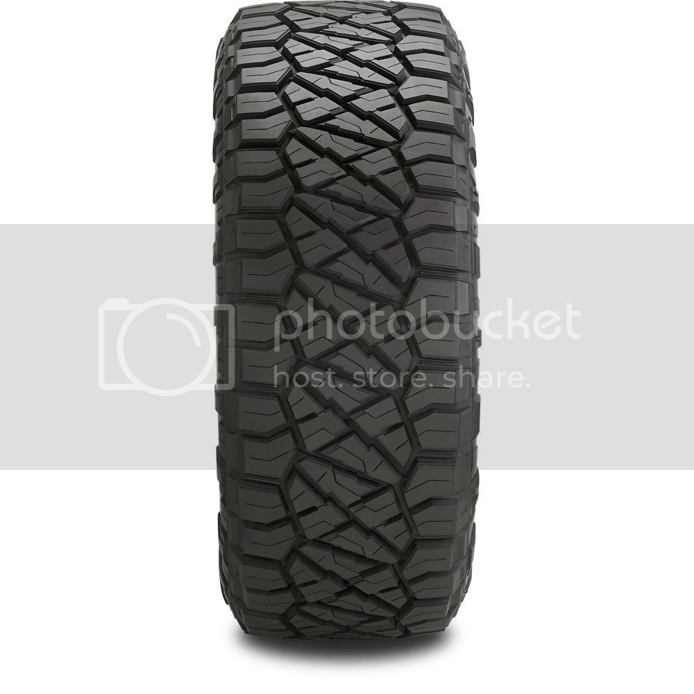

Decided on the Nitto Ridge Grapplers even though there is relatively little feedback on them at this time. I have 3 vehicles with Super Swampers, Trail Graps or Toyo M/T's on them so another vehicle with a true M/T really was a tool with no purpose for me. The Ridge Grapplers seemed to offer a quieter than M/T ride but a more aggressive than average A/T pattern and a nice stout load range.
I went with 285/70R17 in Load Range E. No plans to do a big lift or regear on our 200's at this time. I'd have to part with the built 100 before I need to dip my toe in that water again but I wanted a Load Range E because I know how fat these things get loaded for big trips and an expo trailer in tow.
Wheel/Tire Combo:

Love the rims/tires combo you have. It has a slight of a Baja look. You are giving me ideas. This is the best looking 17 rims I've seen after the rock warriors.

Also forgot to mention I weighed the rims with me on a bathroom scale (highly scientific) and iirc they came in at 29.3lbs/ea.

Great looking wheel/tire set up! I'm in North Carolina - so hopefully our paths will cross on the trails (or even for a beer) at some point!

Great looking rig. I have the Nittos as well, and absolutely love them.

That interior color is gorgeous. The blue paint probably is too, but I can't actually see it. Try adjusting the exposure or saturation to make it pop.

I know!!! Those were with my phone and not my dSLR so there's room for improvement but check out Toyota's stock pics of it and you can see they have a hard time too. A couple people at my office thought it was black for the first 2 days after I bought it. :D (It is if it's overcast for sure.)
I'll be adding more pics from our recent trip and maybe a couple of those may catch the light a bit better too. But we got pretty dirty so probably not... :lol:

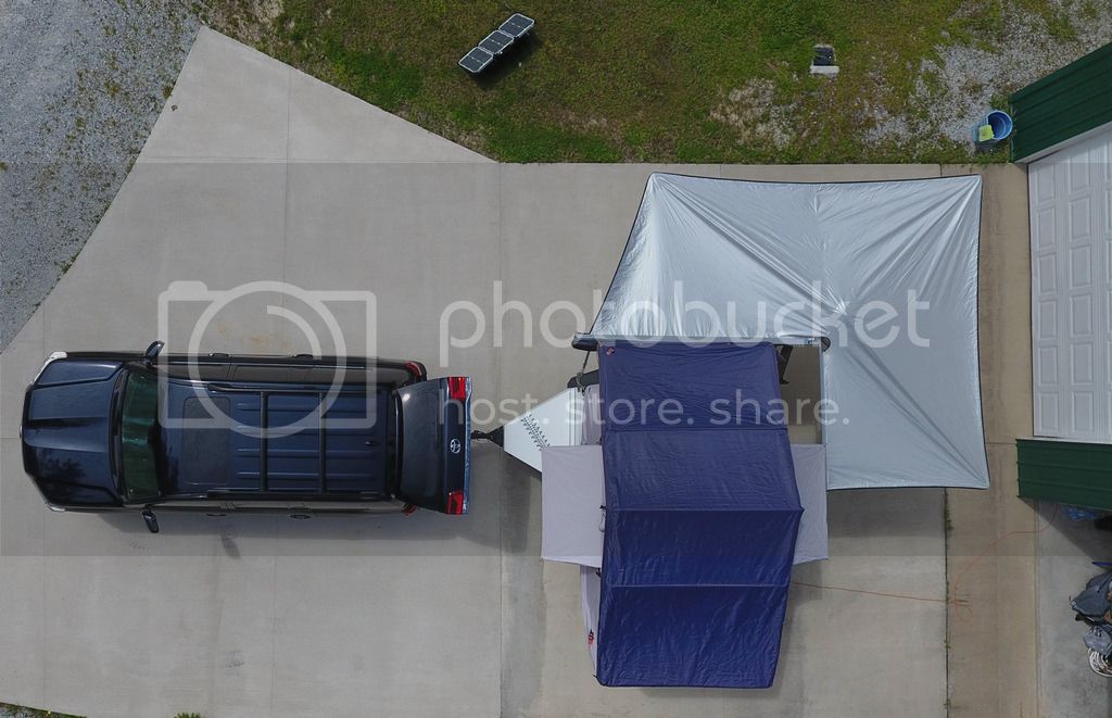

Here's a drone shot with the tent and AluCab Shadow Awn deployed at the house. I try to setup and breakdown a couple times before we go on big trips if it's been awhile just to make sure a) I'm not forgetting to pack anything essential to setup and b)I can get back into the mindset of making the setup/breakdown look easy and go smoothly.
