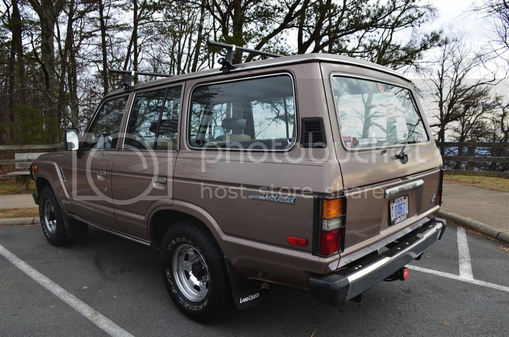

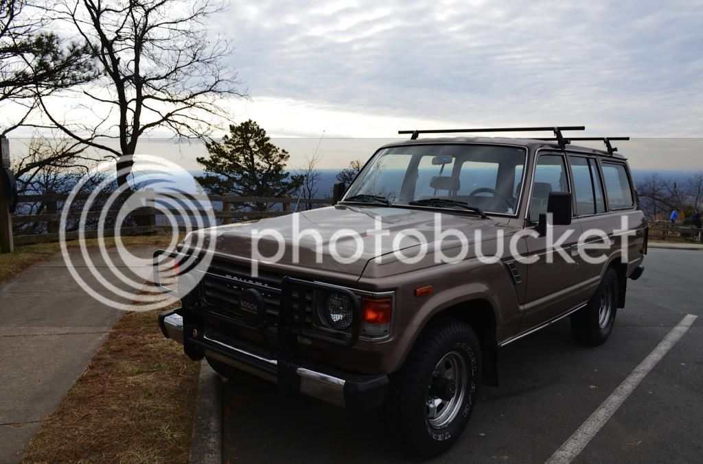

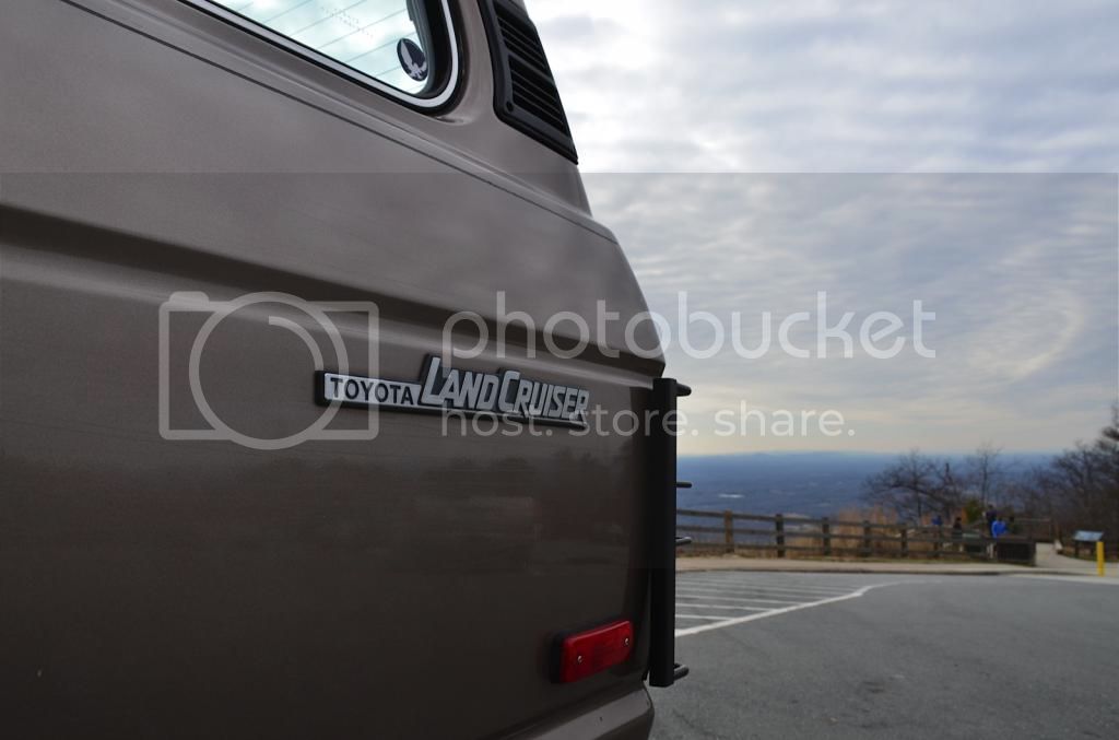

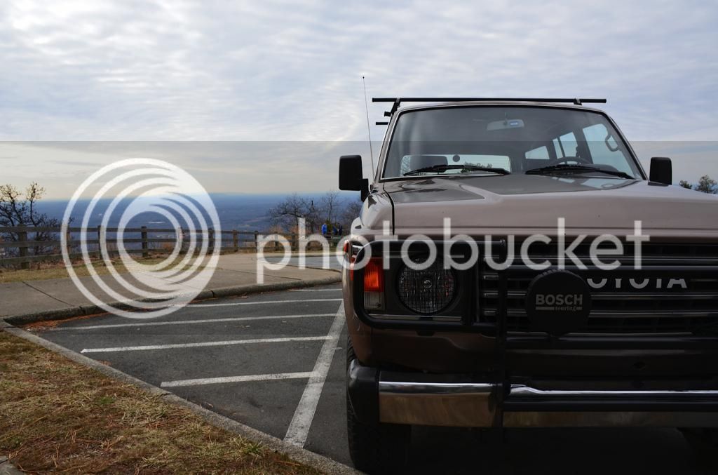

One more Mountain shot I pulled from the wife's phone. Love this one!
Got my wife a new camera for Christmas. New Year's Eve I took the family up to Pilot Mountain. (Yes the same Mt. Pilot from the Andy Griffith Show) It is about 30 minutes from the house. So we could spend some much needed family time, Hike a bit and try out the camera.
First pic is iPhone. Rest are with the new Nikon. All said, she took over 200 pics. I just stole the cruiser ones for my thread.

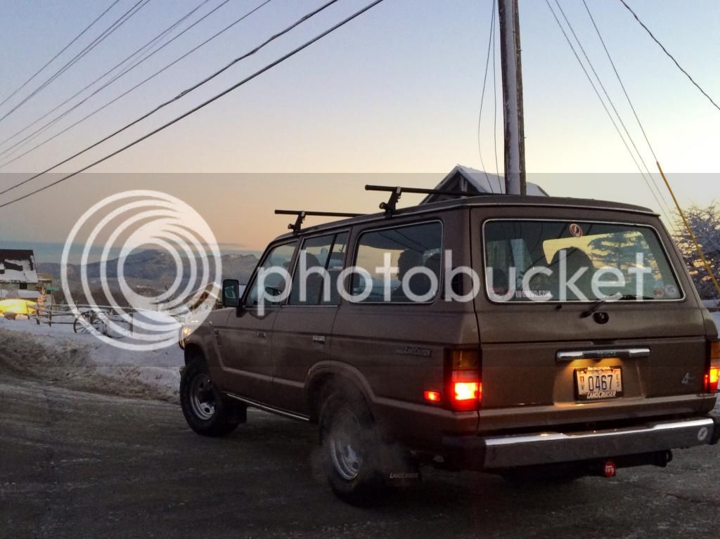

Here are a couple of pics of our 'Massive" NC winter snow storm.

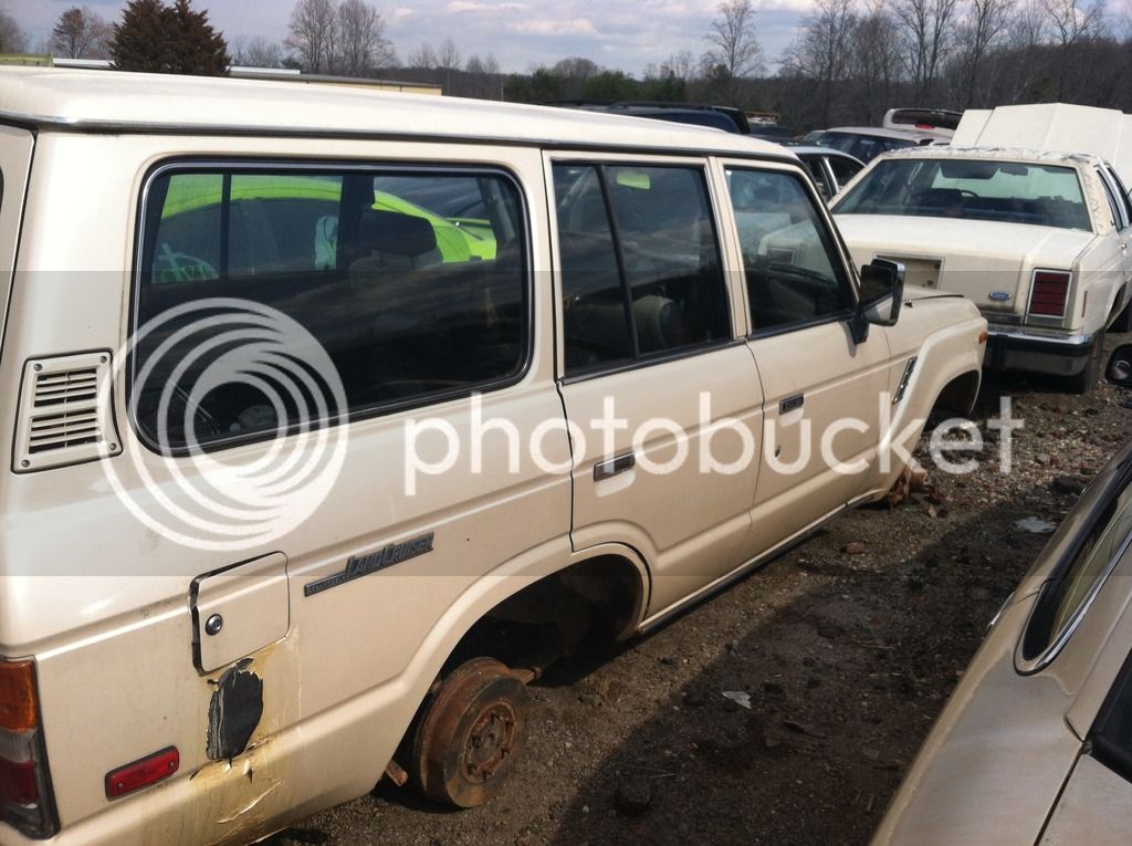

A buddy of mine up in VA was browsing his local junkyard and saw this 62. He snapped a pic for me.

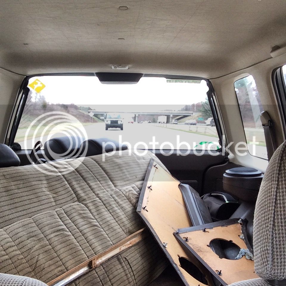

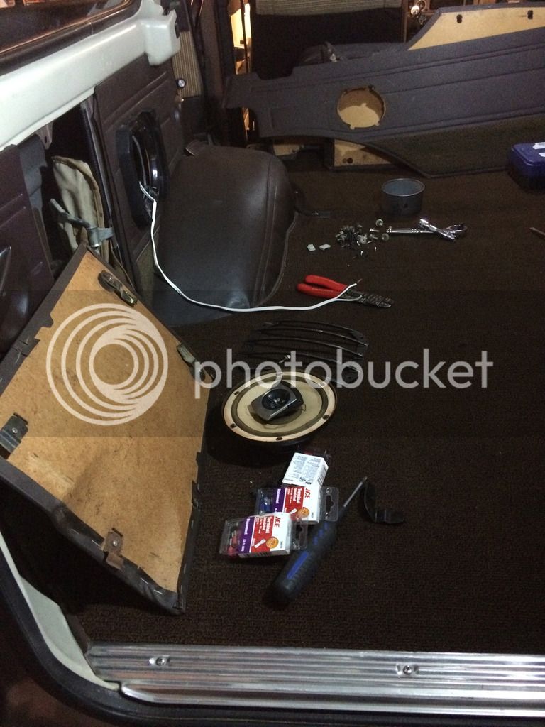

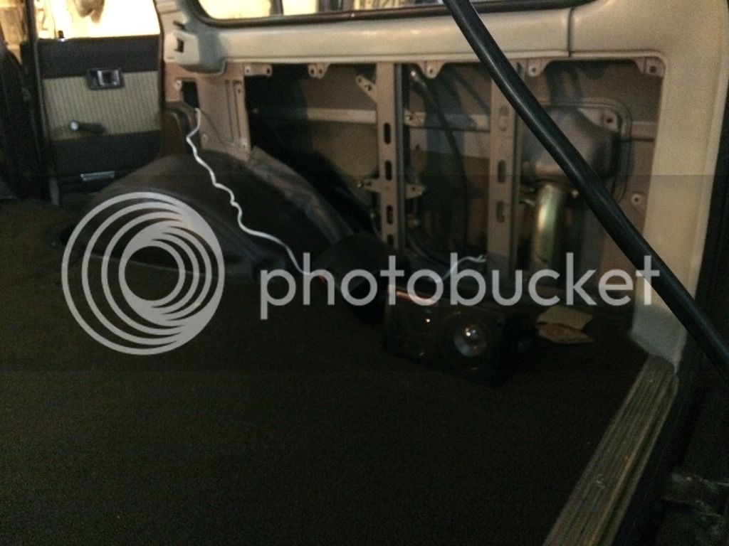

I got real excited and being only about 70 miles away, I jumped in my car the next day after work to see what I could find. When I got there they were closing in 45 minutes. However, I found a complete minus the wheels - FJ62 with brown interior. I quickly snagged the complete rear seat and headrests for a rear headrest conversion, rear cargo panels with speakers, grills, and brackets for rear speaker conversion. I got a bunch of trim pieces, a clock, seat belts, chrome rocker trim, washer bottle, and… ran out of time. Walked away with it all for $80! A steal I do believe.
I did the speakers first. Nice to have hard mounted rear speakers instead of those mobile POS ones I had. Then the washer bottle as mine was broken and never worked. Nice to squirt again!
