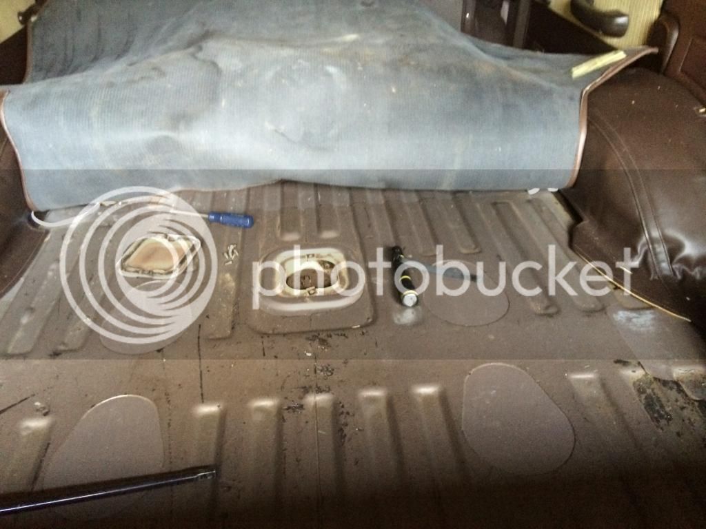

Just a little update. Been driving the Cruiser a lot lately and loving it! Got some rust issues in my gas tank causing my carb to get trash in it. Not to fret though. I have sourced a replacement tank and it is on it's way as we speak! My tank already had the recall done way back in 1990. Hopefully the tank that shows up is rust-free as promised.

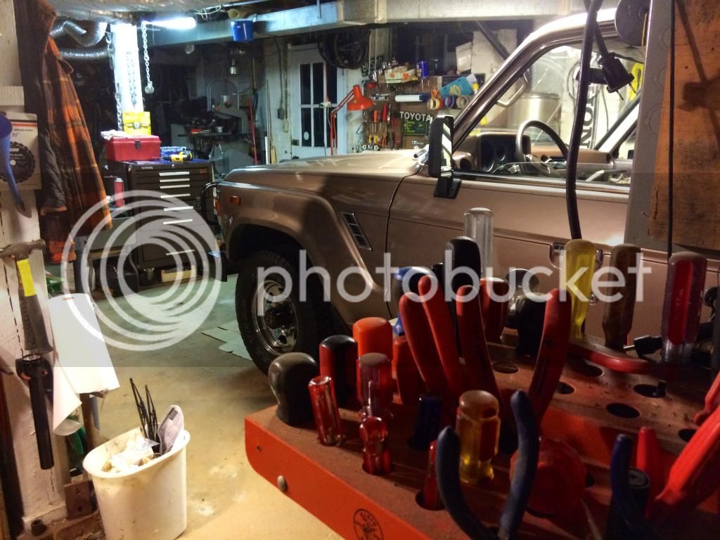

On to some work…

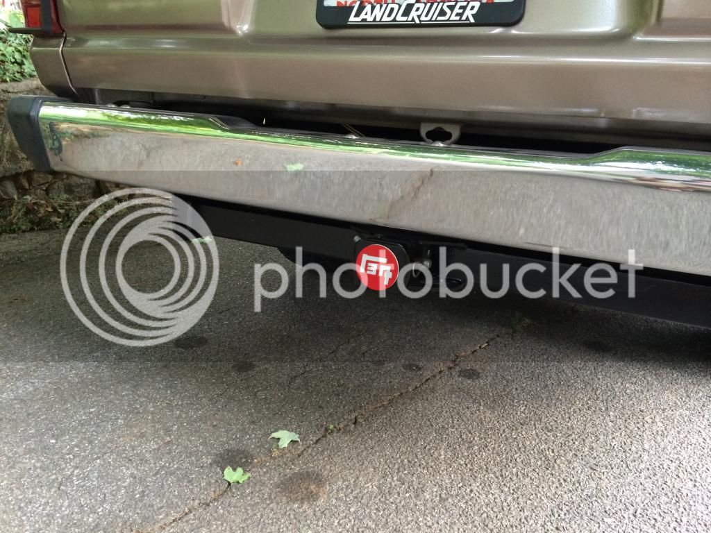

Got a TEQ badge for my hitch cover

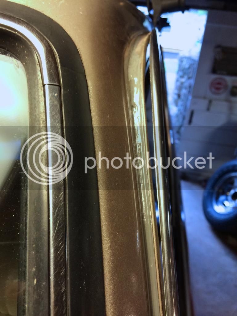

Checking the tank rust and resealed rain gutters.
Also rebuilt my spare tire carrier. It was almost froze up so I disassembled, cleaned, greased and painted it. Works great now and looks nice too. Figured I had to pull it to drop the tank anyway. Might as well clean it up.

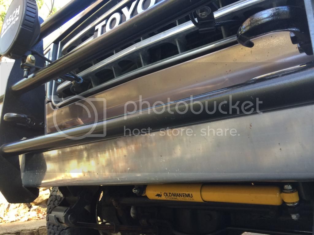

Also added Tow hooks to my brush guard.
More to come after the tank arrives :)
My rain gutters were not bad. I did not need to chip away the old sealer. It was still intact. It was just cracked in a few places. I cleaned it real good with acetone. (Be careful! It will take your paint off. You may wish to use a milder solvent.)
I work in the aviation industry. We use some pretty amazing sealants on aircraft. I was able to source some sealer from one of our suppliers that was out of date for pretty cheap. I don't know if it is commercially available but I will check. It is basically the same as an automotive seam sealer.
I used a syringe to inject the cracked areas. Once they were repaired, I ran a bead down the gutter and smoothed it out with my finger.

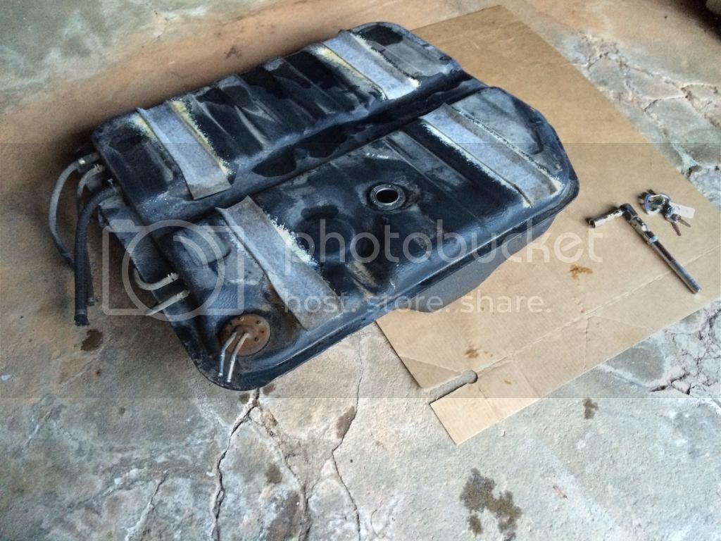

My tank showed up from sunny California today!
It is beautiful inside. Nice and shiny. No signs of rust!
I washed it off and am going tomorrow to get new fuel lines.
Hopefully I can get it installed by the weekend!

Got the tank swapped out last night. Also did all new fuel lines (the rubber ones - left the hard lines.). And put a new filter on. It was a pretty big job. Took me a and my buddy about four hours.
It wasn't until the old tank was out that I realized just how nasty it was inside. Can't believe the truck ran at all! Fresh clear fuel now runs through the filter. I'm sure I'll have to change filters a couple of times to push through any residual sediment that might be in those hard lines. Feels good knowing that there is no junk in my tank. Remounted the crossmember with the rebuilt tire carrier lifter mechanism thingy and got the spare back on.
