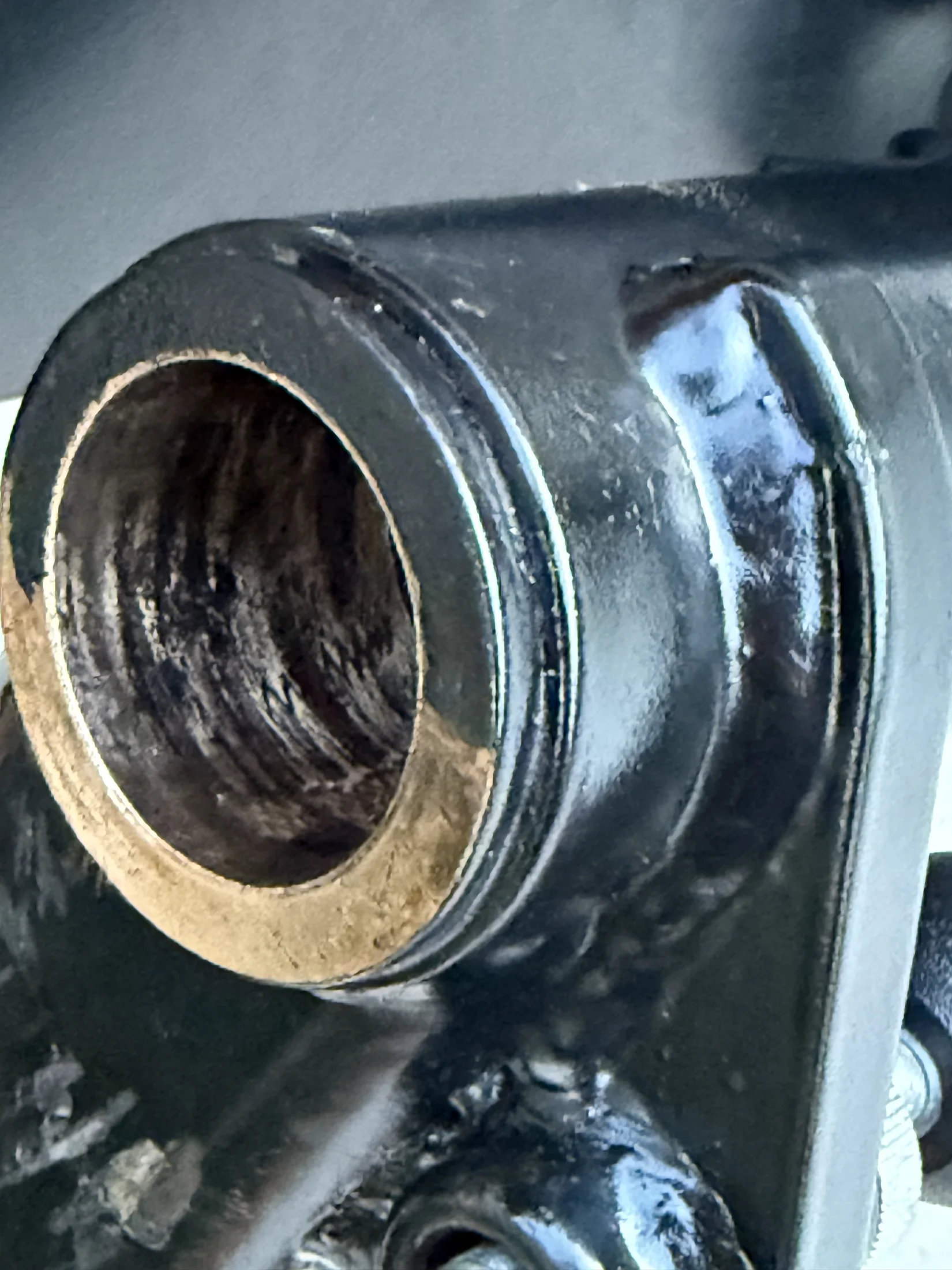

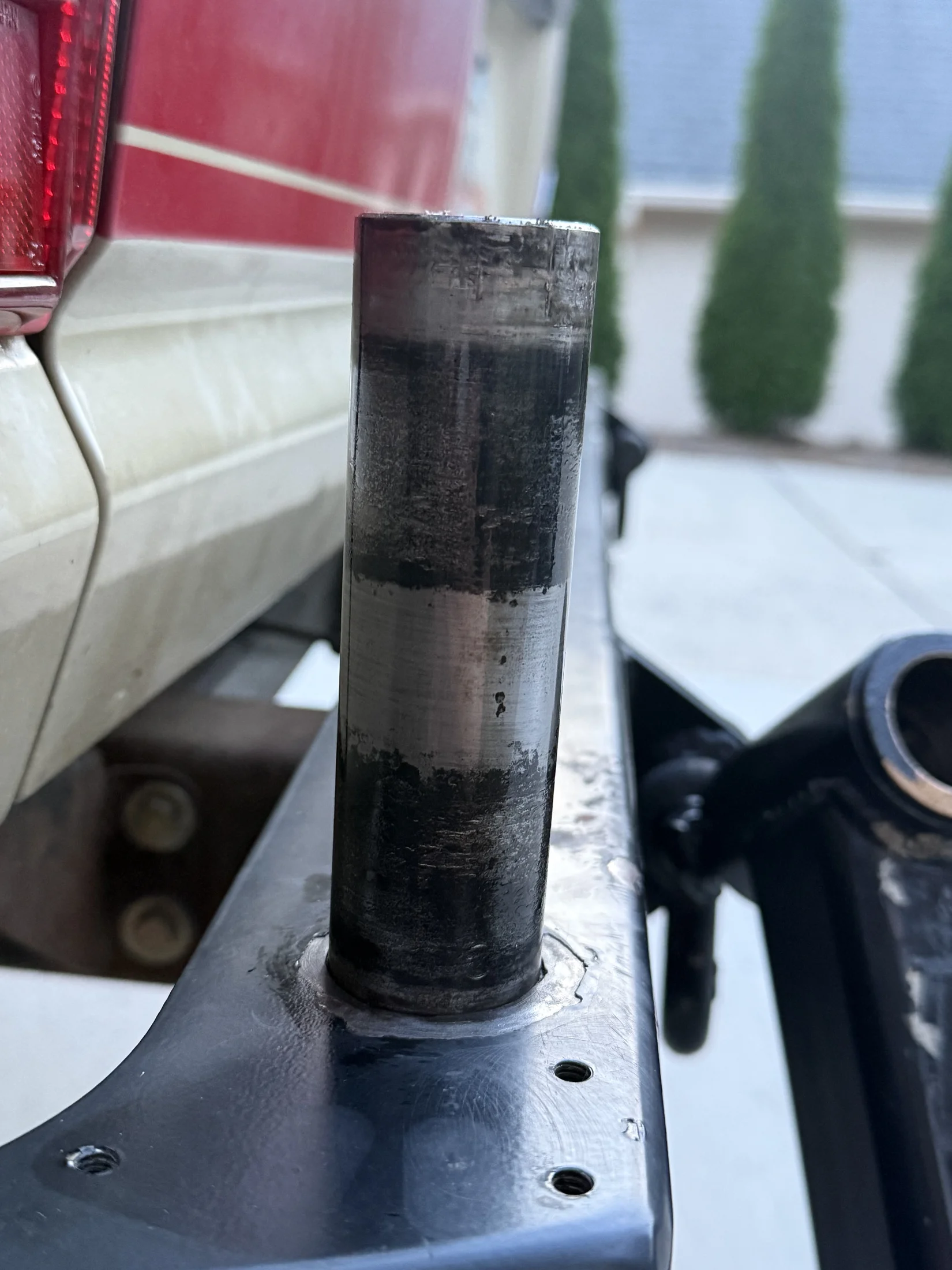

Good- tonight I spent a couple hours trying to clean up the post and bushings with everything I could think of.
Bad- both surfaces are seriously galled and pitted. I even ran a cylinder hone inside the bushings to try to smooth them out, it’s hopeless. I don’t think I’m putting these arms back on.

Possibly? The bushing are pushed into both ends of the tube, and have a collar preventing them from being pushed in. I can’t think of a good way to press them out. There’s no way to get to the under surface of either bearing from the opposite end. I’m open to suggestions here.
There’s also the issue that the posts on the bumper are fairly galled and I think they’ll just tear up any new bushings I put in.
To remove the bushings.... cut/remove the collar off of one of the bushings ( I would do the bottom one to hide any whoopsies) and the press out both bushings in one go.
you can use a saws all inside too so there no collar damage. once you’ve made the kerf they’ll be loose enough you should be able to hammer them out.
I dont think the galling will affect it that badly since its just a slow moving pivot. I would drill and tap for a grease zerk, sand things relatively smooth the best you can, grease it up and put if back together. You can pm lcwizard and he can get you new bushings though if you want.
