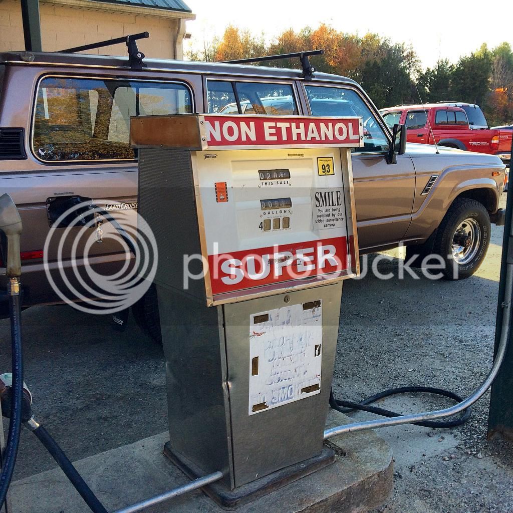

Filled up the coolant after work today. Then we went for a little drive. It is nice to be back after a few weeks down. I figured the new fuel tank and lines deserved only the finest on their first fill-up so I drove to the little country store down the way that sells non-ethanol 93. Cruiser likes it.

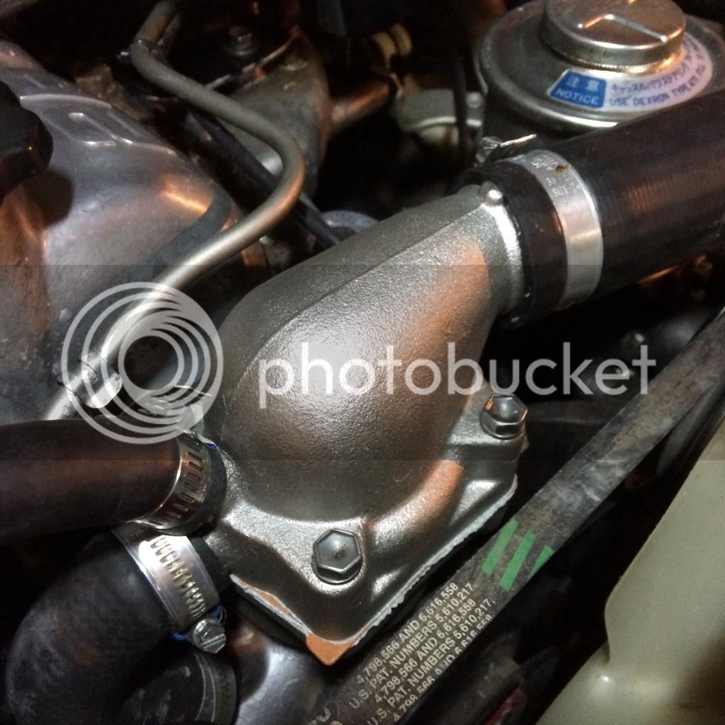

Well, that didn't last long. Dang thermostat housing is leaking I used the paper gasket, RTV, and torqued to spec. Still leaking. Everything was cleaned up really well before install and allowed 24 hours to cure. Still, it is leaking around the mating area of the housing and the bolt heads, which I find odd. Oh well, tear it down and try again.

Tore down the thermostat housing again. Cleaned it up real good. Scraped it, hit it with the wire wheel, Block sanded both surfaces with 220, cleaned it, and cleaned it again. Also cleaned the bolts really well. Put it all back together with a new gasket and some RTV. Torqued to 13 ft/lbs. and went for a drive. Went about 10 miles. No leaks so far!! Hopefully I can forget about this project now. I am real tired of draining coolant! It should be nice and flushed now.

Well, around 200 miles and no leaks on that pesky thermostat housing! I guess plaining those surfaces did the trick! All buttoned up now and I parked on a fresh piece of cardboard in the garage. I only have one tiny drip after a couple of days parked. It is at the very front of the oil pan. Guess I missed a pin hole size place on resealing. Oh, well… I can live with that.

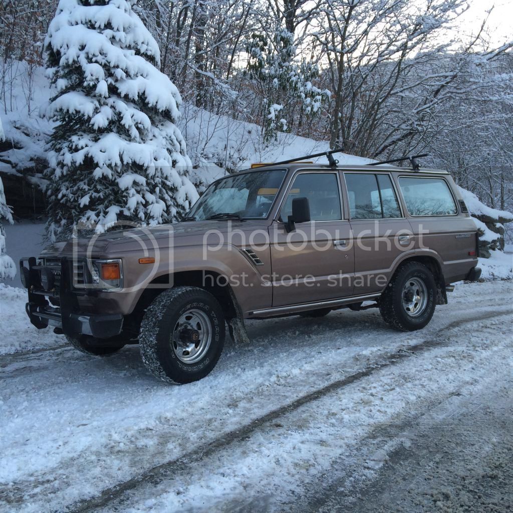

It's photo time again!! Took the 60 up to our cabin in the NC mountains over the weekend. With her new fuel tank she ran fantastic! Low and behold we found some snow!
