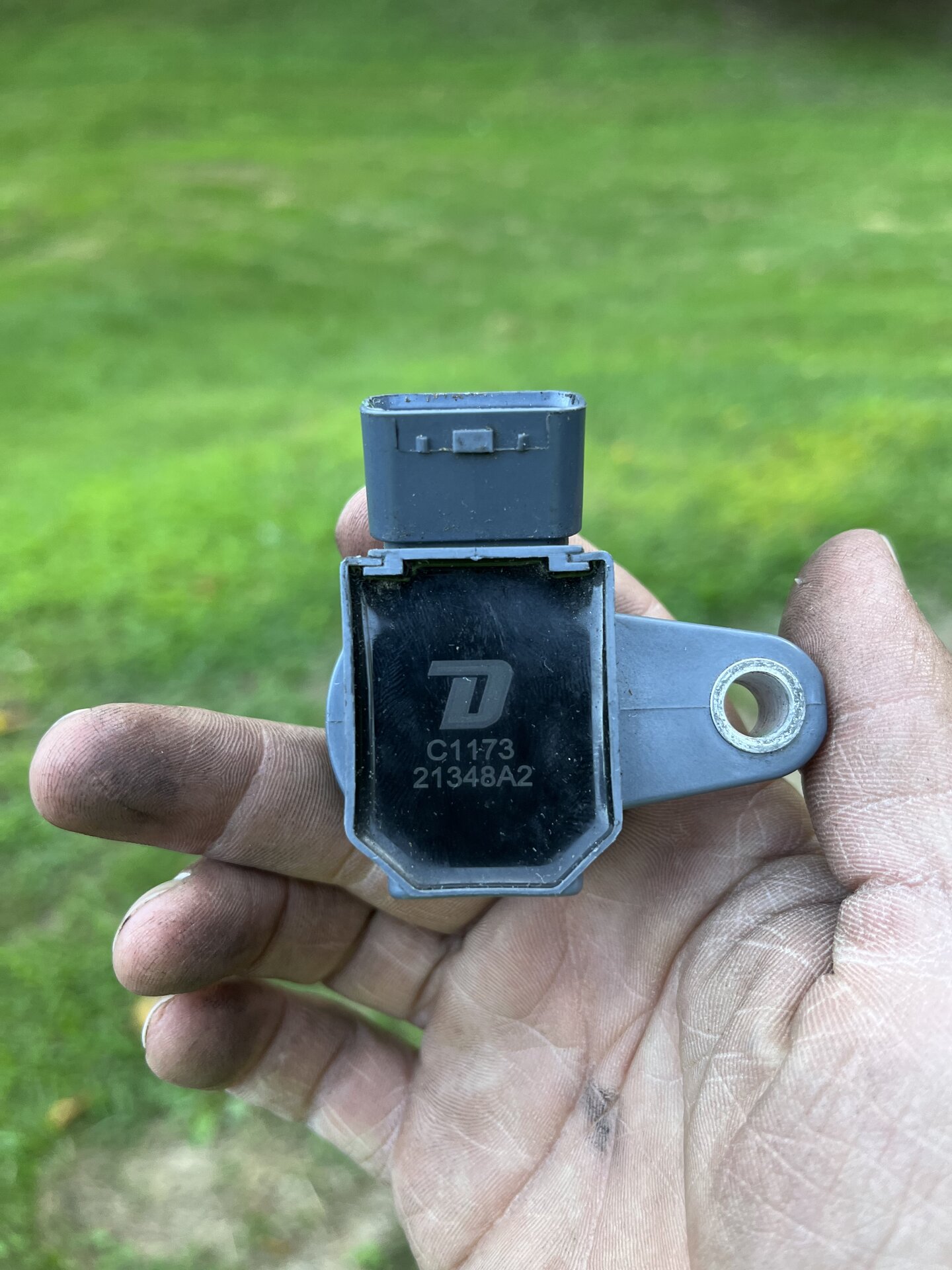

I just replaced 2 coils that had pending codes for random misfires. I believe the old one is possible a fake denso? I noticed it looked different when I rebooted the other coil packs and put it back together, I said to myself wait for it to give me a problem. Didn’t take long though.
Plugs were done about 1k miles ago. Will replace the other 6 later this weekend. My new ones are OEM from PartSouq.
