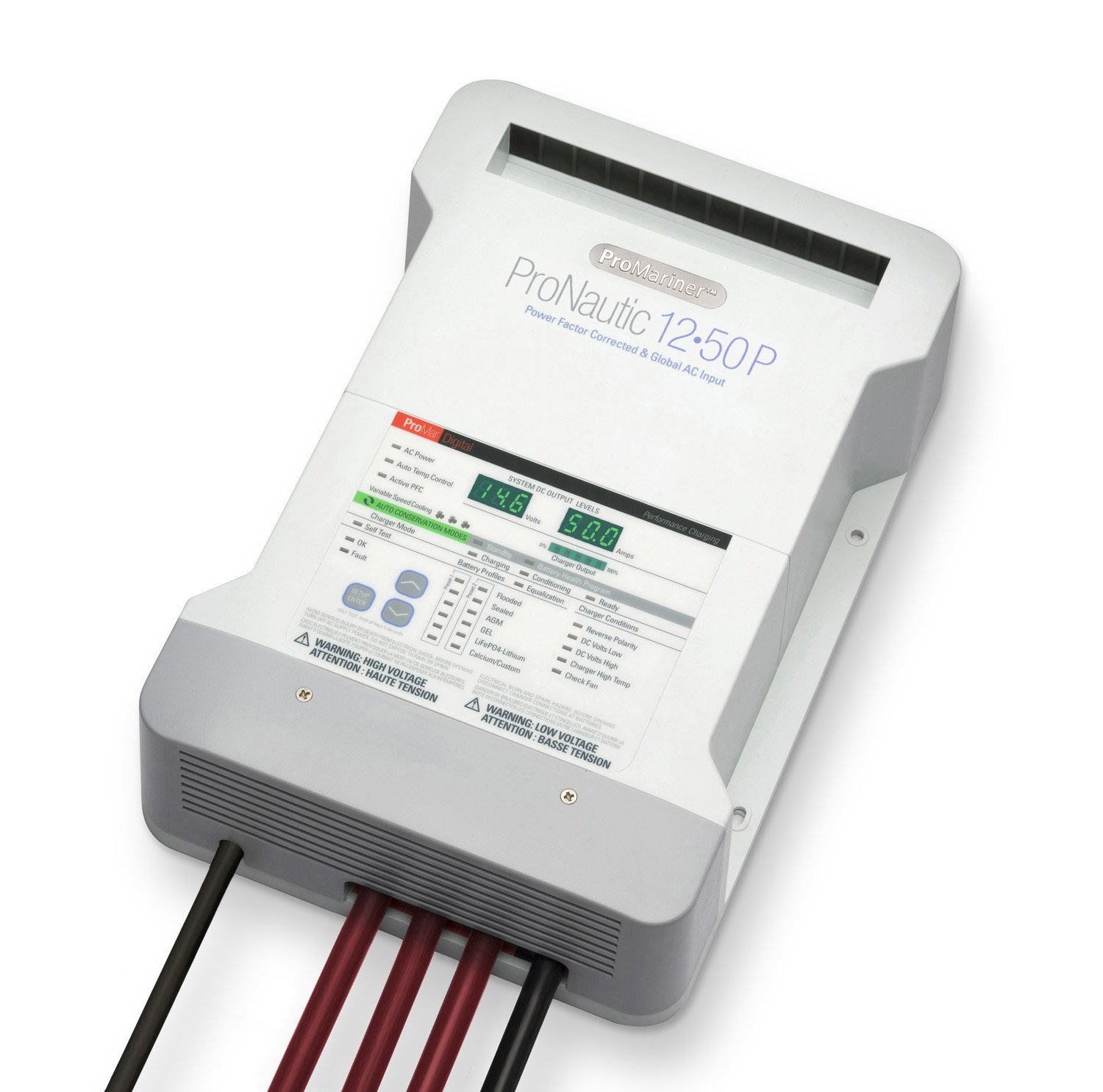

Been thinking about getting one of these ProMariner chargers, but if it doesn't do any good...
That looks like a seriously good charger, probably an overkill, but it's on sale right now, half price. It has the AGM setting, which is crucial for AGM batteries.
But, using an AGM in the truck without increasing the voltage of the alternator is a bit useless, as the battery will never be fully charged except when using the external charger. An agm battery needs around 15 volts to charge fully, and the alternator gives only 14.3 or thereabouts.
