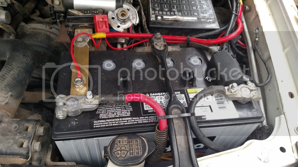

I have a Sears 31 marine / RV battery, it's a bit cheaper at $140. Haven't had any issues with it and keeps my fridge running at least 24 hours. I did have to order a different size screw on terminal and fashion an extension for the positive side out of copper bar.

Update from my last post: Sadly, I've begun experiencing problems with the DH series 31 battery, and from reading the posts above, sounds like similar issues. For the past 3or 4 months, I've been getting the low battery voltage alarm on the DH 31. This originally occurred after the car sat for just a couple of days. Fast Forward to this past weekend where I drove 4 hours to meet up with some friends for a camp trip. Less than 24 hours later, the alarm came on. So when I got back home a few days later, I checked the voltage within 5 minutes of pulling in the driveway and voltage was 12.2 volts. Within 15 minutes it was 12.09 volts. I checked my auxiliary battery and it was reading 13.01 volts.
I put a clamp-on amp meter on all wires attached to the + terminal, one at a time, and no noticeable current draw. So, when I get back home from the Thanksgiving holiday, I will be going to Sears for an exchange. Long term, who knows??
