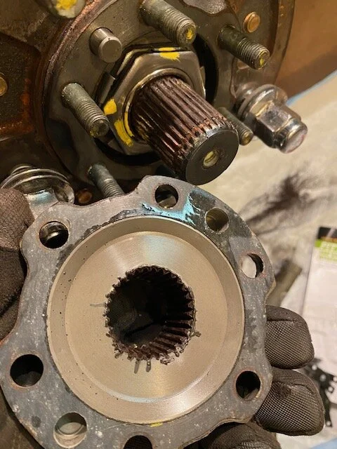

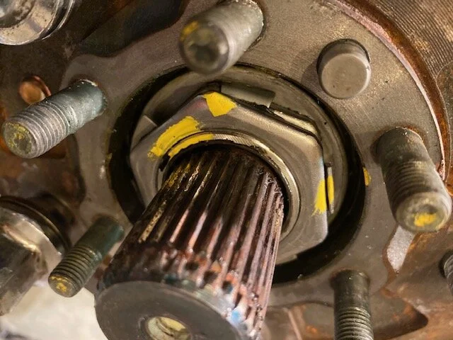

2000 LX 123K miles with original bearings and grease. I found lock nuts were only hand tight. And I noticed end of the axle shaft near flange has blued color likely from heat.
I will clean and repack. Is there anything else I should check when I am in there?
Photos are from disassembly before I cleaned anything.

Whilst you are at it then replace the dust seal on pic 3 and the hub seal holding the second bearing. I would replace the bearings and keep those as spare. Wheel bearing grease care of Toyota.

You have virgin wheel bearings. The yellow paint and grease, is factory. The blue at end of axle is normal, from factory. Wheel bearing service, is due each 30K miles. So these should have been service, 4 times by now (123K miles). So not a surprising, lock nut loose. You, surely found deep scoring on claw washer (thrust washer). Which is a result of vibration from loose wheel bearings.

BTW: The browning grease, on the splines of your axle. Is from water entry, contaminating grease on axle. Likely entered from grease cap. But may have come in seal at back of Kunkle. Condition of axle needle bearings and bushing, needs inspection. A clue, to the health of axle needle bearing. Is condition of axle, where rides on the axle of FDS. Best to remove steering Kunkle, first time in.

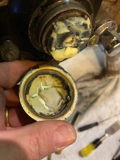

Thanks. I will check all those things after I clean up the components. There is some rusting on the spline. The grease cap (dust cap) was on real tight and snug so I don't think it came from there but I cannot be 100% sure. If I can get to it this job then will look at the needle bearings. Otherwise, I know I need to reboot the CV boots soon. I'm going to be back working on this axle again. And I will have to do the driver side too.

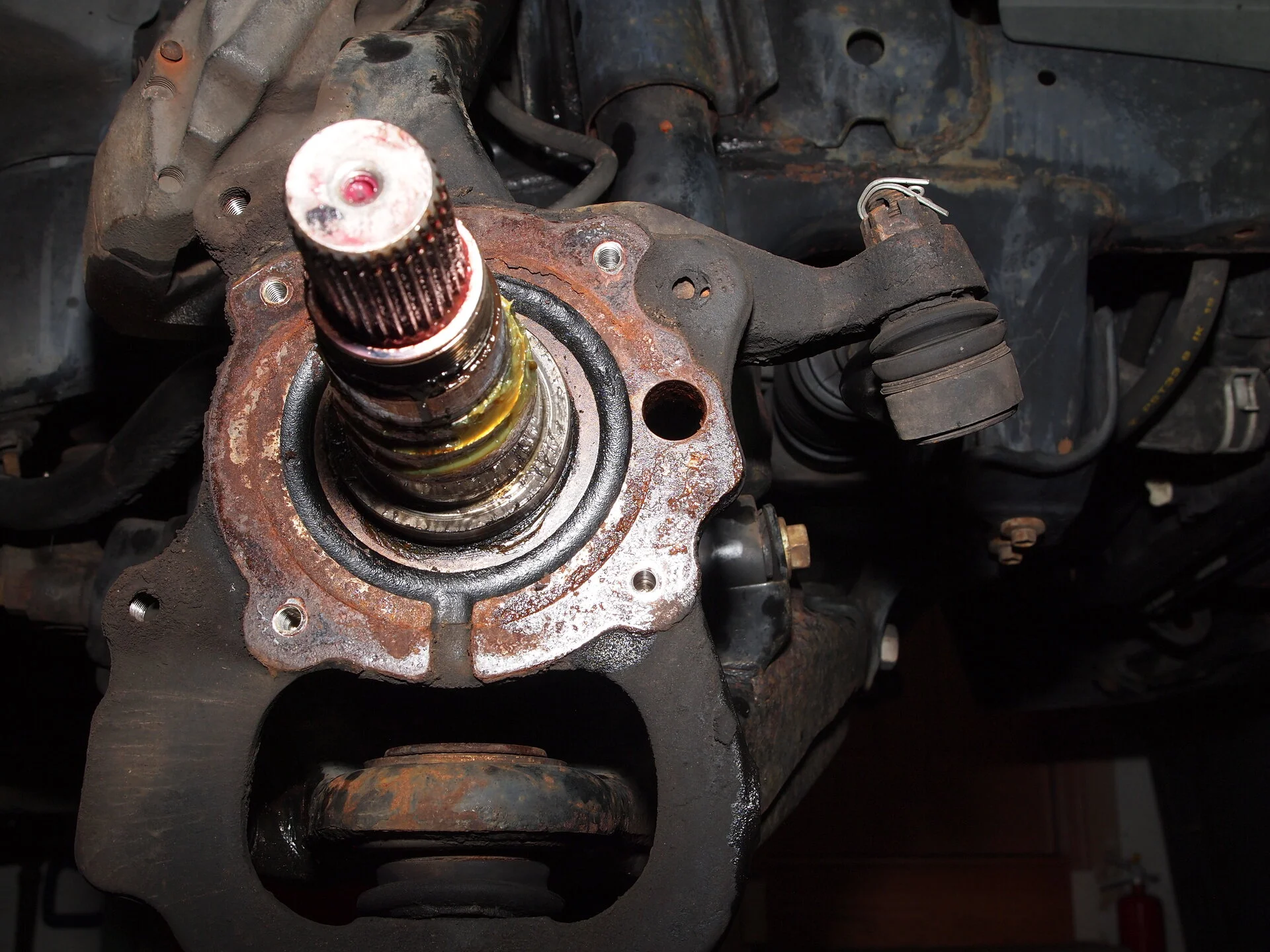

Here was the dust cap and end right after I took it off with whatever grease they put in there.

I'll assume the chisel marks around edge of grease cap, you made. So I'd 98% agree, cap not likely water entry point. But is 2% chance it was.
The hub flange gasket, looks good. With only tinniest rust stains near studs/holes, if even any. I can't zoom in, making difficult to see.
Water can enter at rear wheel hub seal, passed large wheel bearing. But if it did. The wheel bearing grease would be contaminated. Which it doesn't look to be.

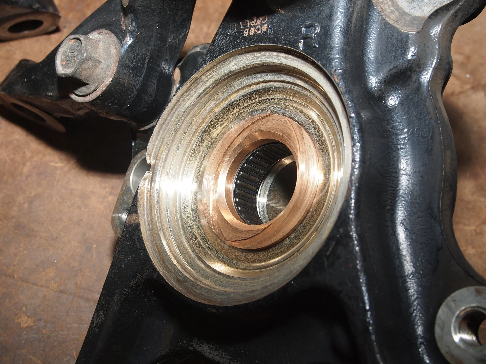

So this is pointing toward Kunkle & FDS seals. One seal is on the FDS. The other is on the knuckle. The two fit together to create a water tight seal. The hub flange snap rings maximum allowable gap 020mm. Insures the seals, make proper contact to create this water tight seal.
It is possible to push axle inward, then look at seals on backside on Kunkle. You can also then see, the axle brass bushing.

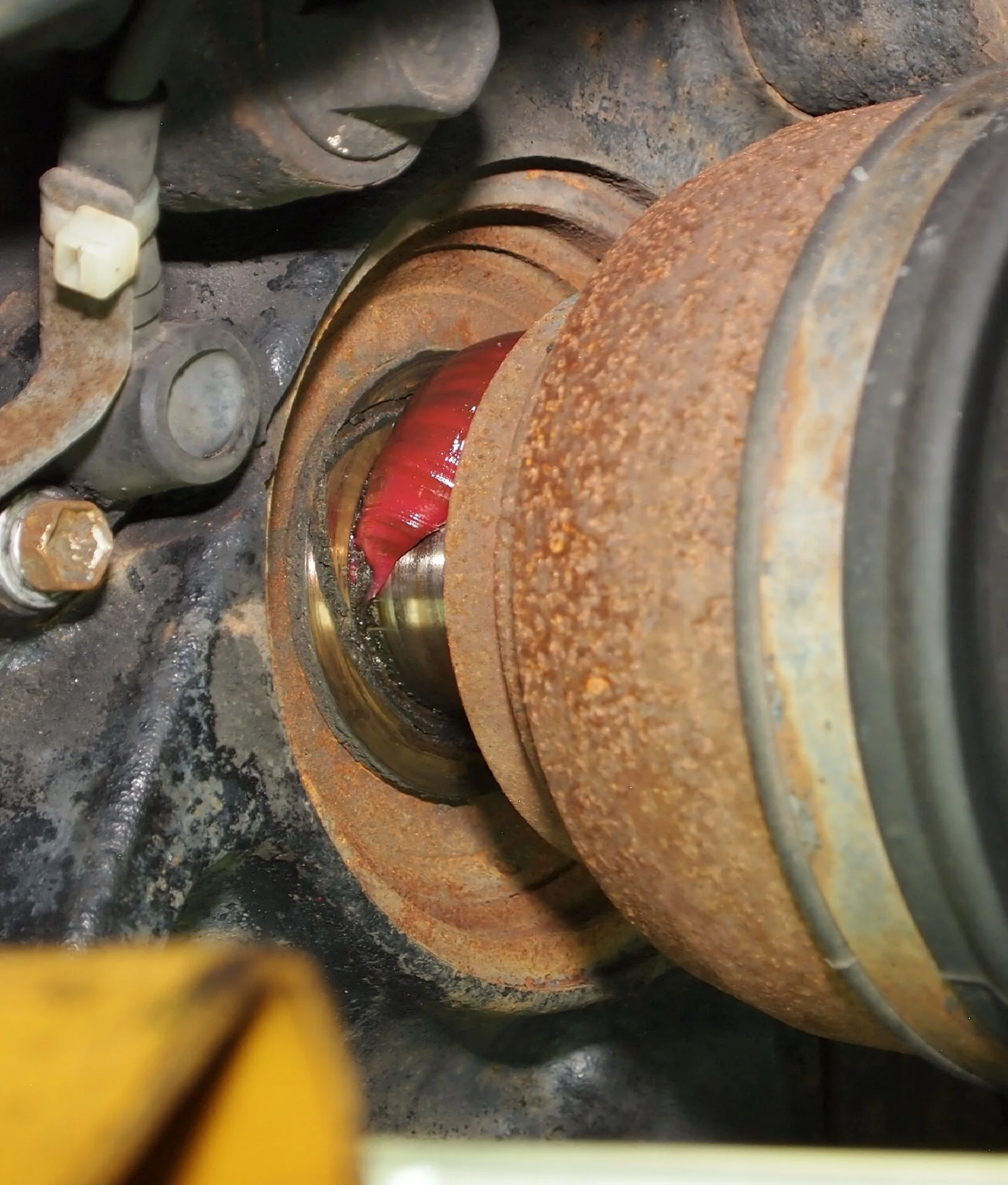

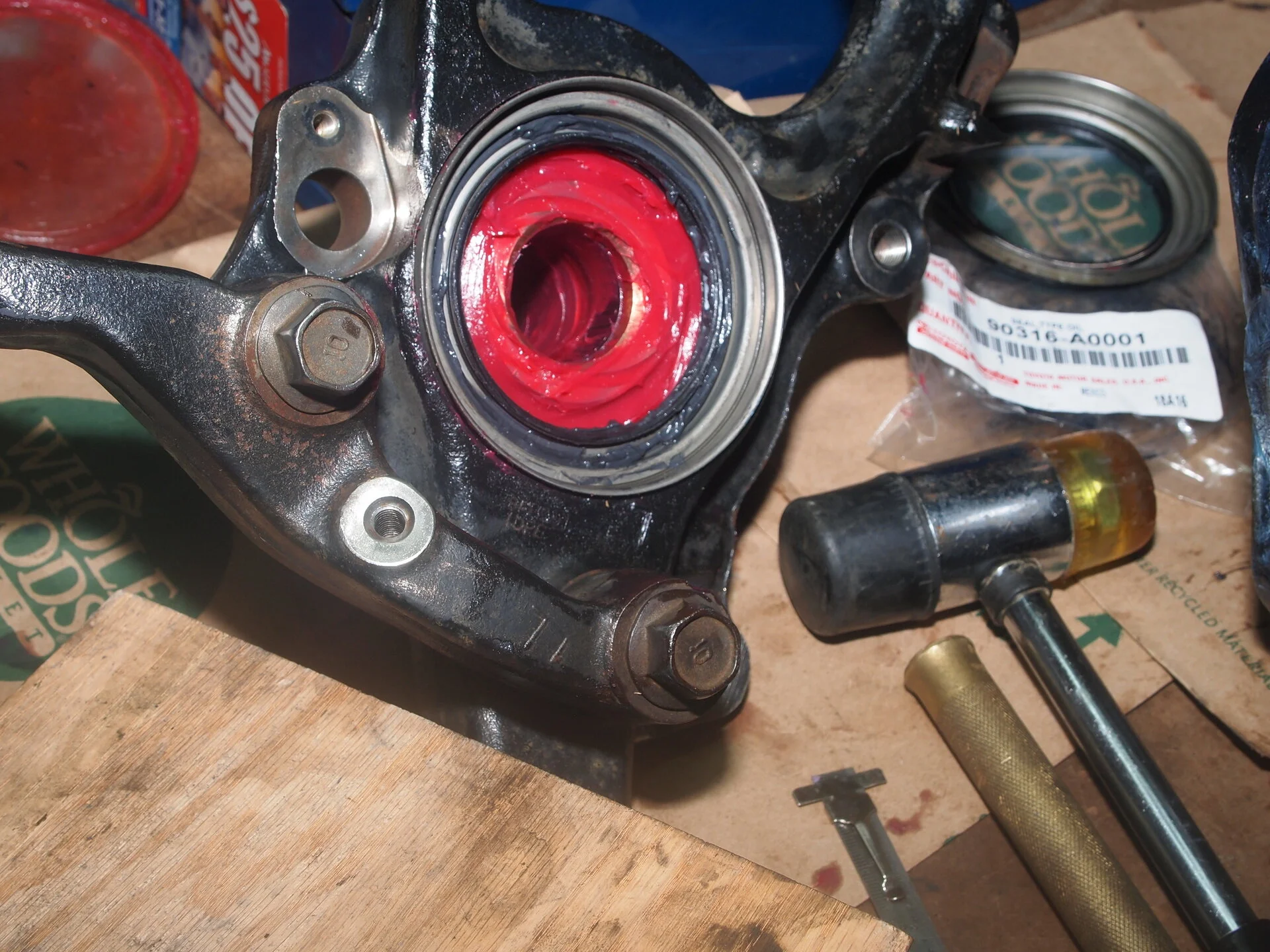

This brass bushing was exposed. While using the Slee lube tool, which push axle inward. I found both seals missing. I show this picture. Since it shows how it's possible to see brass bushing. This one was very contaminated.

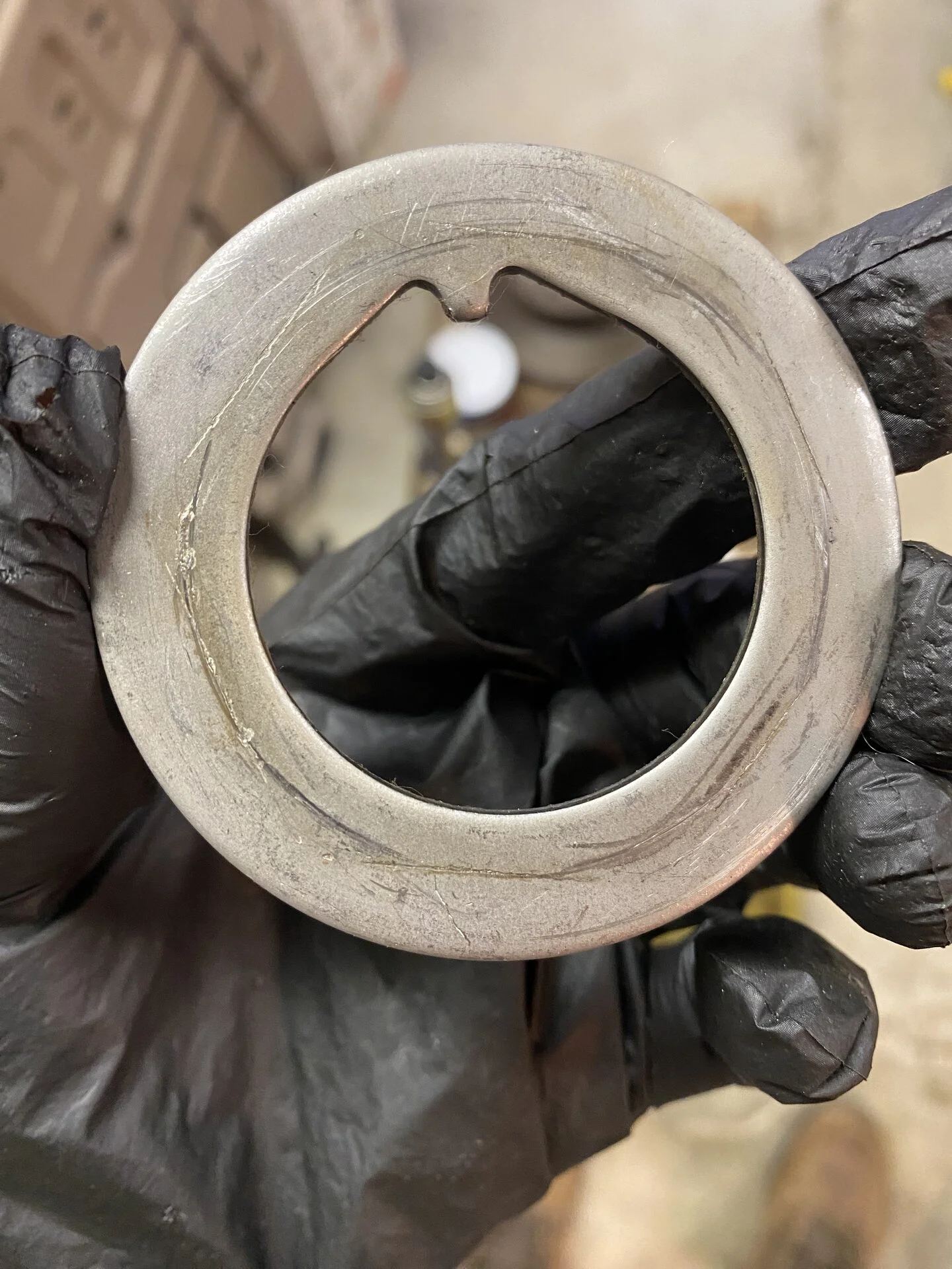

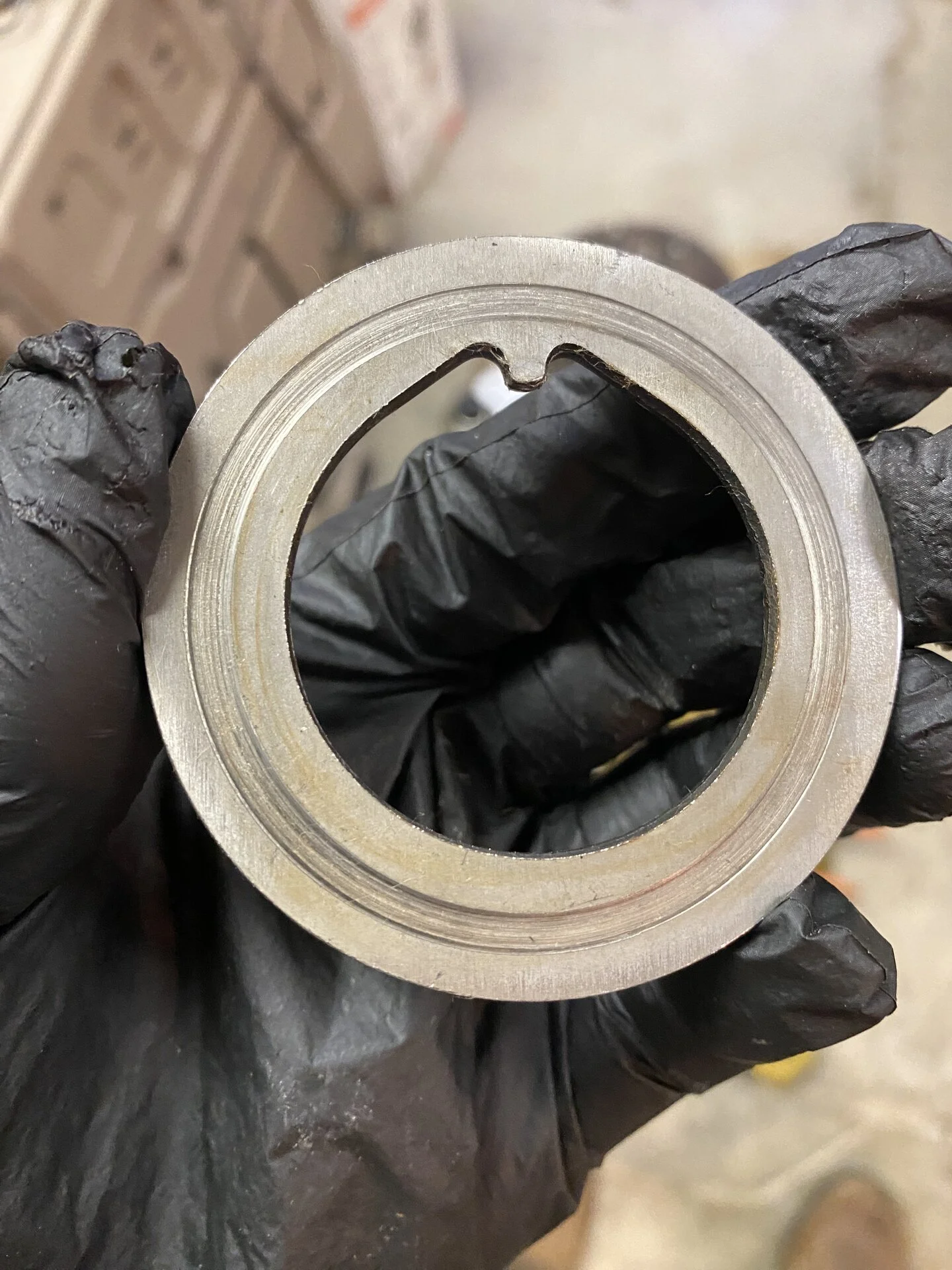

Minor scarring on this dohicky thing. It did its job protecting the bearings from the loose nuts
This brass bushing was exposed. While using the Slee lube tool, which push axle inward. I found both seals missing. I show this picture. Since it shows how it's possible to see brass bushing. This one was very contaminated.View attachment 3549177
View attachment 3549186View attachment 3549179
Like you said. Looks like moisture from knuckle in back. Clean but rusty
Claw washer scoring, indicates how loose wheel bearing where. Bearing set properly tight, and service in ~30K miles. Claw washer will not be scored, and can be reused.

Actually, that factory white grease is not contaminated. Looks very nice.
