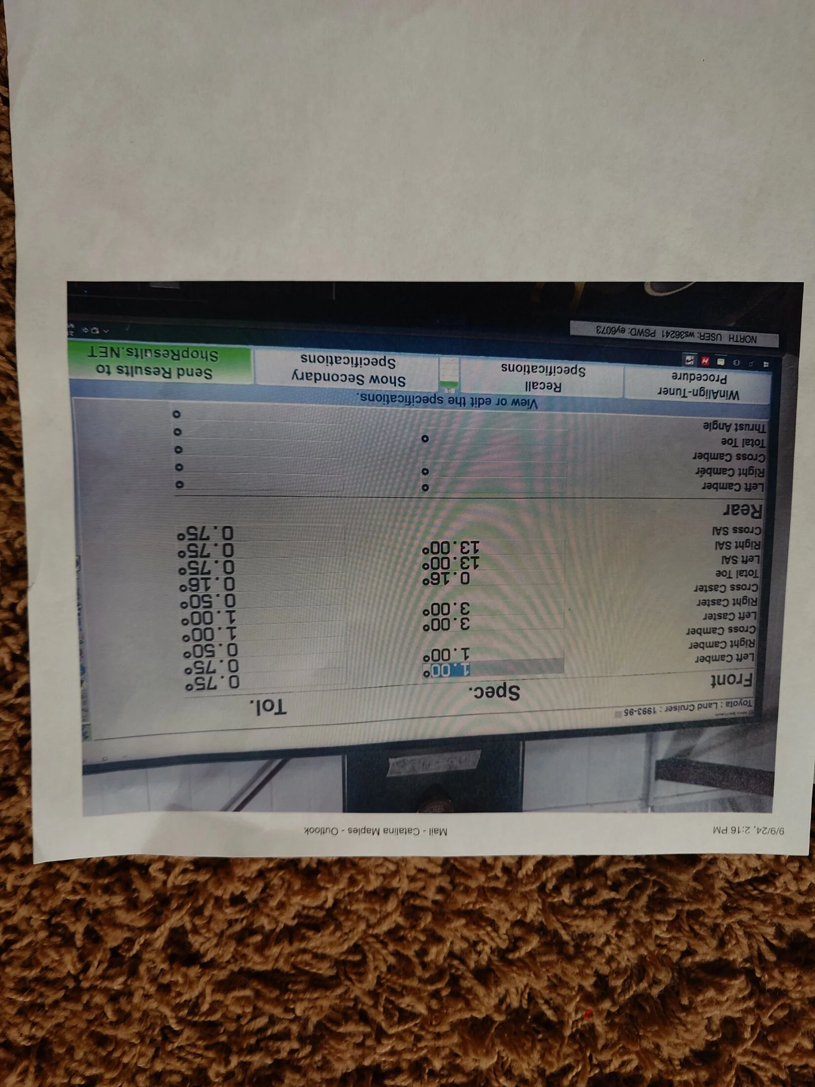

Went to the dealership (most likely a mistake) to get my wheels aligned after getting new tires. The computer screen is what was shown to be factory specs and the next photos are the results of the alignment service. I went with the OEM tire sizes of 265/70R15 and was wondering if anyone else has similar specs or if the dealership messed up
Is it possible to adjust Caster? I would if possible. The specs. is very generic for most 4x4, the shop could also change the specs. in the machine if they want to.
What model are we talking about? Caster can only be adjusted on solid axle cruisers by caster shims on the spring packs (leaf spring models) or caster correction bushings or radius arms (coil spring models). No adjustments are necessary unless you have put a lift in.
78 prado
